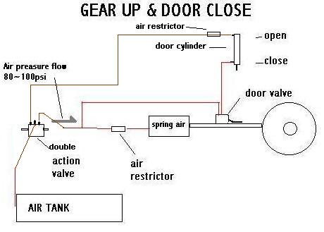

Gary,
The nose wheel and doors set up is very easy.
Bellow is a diagram I made when building mine.
I went with Spring air 402, 85 degrees on mains and 90 degrees on nose.
I'm using that same radio, is excellent and cheap.
For my new Viper I'll use the Futaba's servos syncronizers, instead of Y harness at the elevators and flaps servos. Programing the radio is very easy....
For all the questions related to the turbine, lest way until you are closer to jump into those details....there is nothing to worried about.

I also would lean to the Viperjet if you want to go turbine. I also have a BVM .96 aermacchi which I flew before the Viperjet. I think the Viperjet is easier and more stable than the aermacchi. Landings are easier and smoother as well. Both jets fly really well slow and fast. The Viperjet is a big glider on landing it likes to keep going with that clean wing unlike the aermacchi which has to be slowed down a lot to keep from bouncing.
I built the nose gear door as well and have it on an air cylinder from Tam. Had 3 gear up landings from air leaking out of the BVM micro valve I had set up to retact the door after the gear. What a pain in the butt that has been> I have now purchased a Ultra Precision UP2 valve and it works flawlessly. I wish I would have known about that gadget from the beginning but it is a learning hobby. Get yourself one of the UP2 or 3 valves if you want to have the door sequence. It also runs the retracts all in one mechanical unit for $89.
