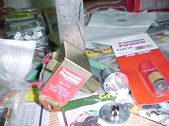

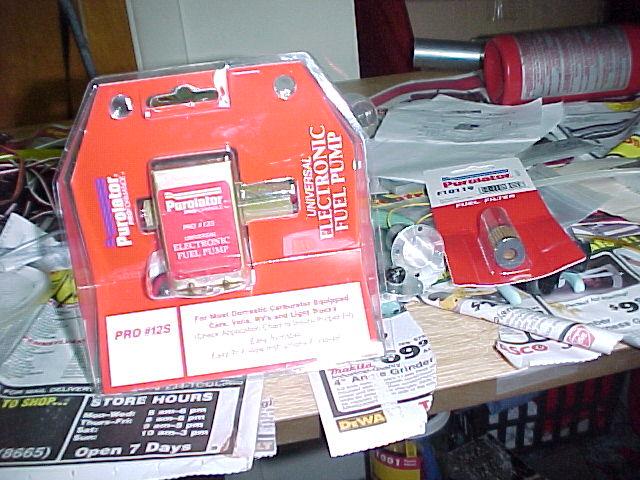

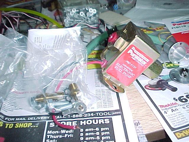

Here it is. The Facet / Purolator Electronic fuel pump P/N 12S
12 Volt
4 to 7 PSI
132 Liters / Min
Looks to have a self prime of ~12"
That could be taken care of with a one way fitting so the pump never gets empty. The Barb fittings are standard 1/8" NPT but the barbs are a bit large. New fittings should be easy to get. It sounds like a very fast woodpecker but not bad. Ill post a review as soon as I can. I payed $29 at an Advantage Auto Parts store and they sell online. At this place they can be gotten for $20.50
http://www.herkofilters.com/electricfuelpumps.htm
See Woketman: I told you I would find it in the low $20 price range. Glad to be of help.
BTW the last picture I THINK? is an exploded diagram of one. Best I could find. Ken

That thing to the right of the pump is a fuel filter made by Daryll Usher. Uses a standard car fuel filter. Thought I would give one a try.

Tom I just hooked it up in the bathroom sink using water. I connected the battery and now have a very wet ceiling. It went everywhere. I agree with you. The provided fittings have an ID of .250, but if was funny as heck
