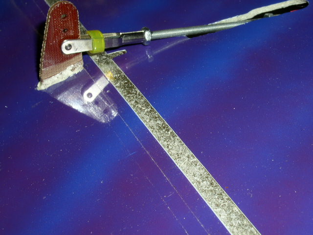

Old 08-16-2004 | 12:13 PM
Posts: 253
From: zoeterwoude, NETHERLANDS
Default RE: Roo II Elevons Binding - Fix ?
here's a picture of the tape i used.
you let one side of the tape touch the elevon horn and the rest just slips under the uperskin of the trailing edge.
Old 08-16-2004 | 02:01 PM
My Feedback: (65)
Posts: 899
From: Orlando, FL
[sm=thumbup.gif]Thanks for the picture!!!
Did you also sand the hinge line to open it up a bit before you put on the tape?

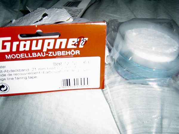

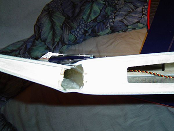

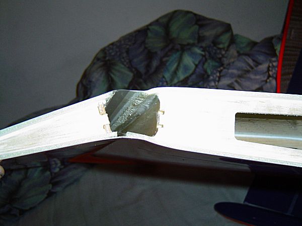

Old 08-16-2004 | 02:44 PM
SJN
Posts: 6,326
Received 7 Likes on 7 Posts
From: Copenhagen, DENMARK
I bought some special tape from graupner, that is only sticky on one half. It is also quite firm compared to normal tape.
I think it is used for gap sealing sail plane wings...... works great on the euro!

Old 08-16-2004 | 03:12 PM
My Feedback: (65)
Posts: 899
From: Orlando, FL
More Great Pictures!!!
Thanks very much guys--really a BIG HELP.
Old 08-16-2004 | 03:39 PM
Posts: 253
ORIGINAL: RAMFlyer
no i did not sand open the hinge line just made a slot in the skin to get a good deflection on the elevons you can see it in the picture.
its in front of the control horn
