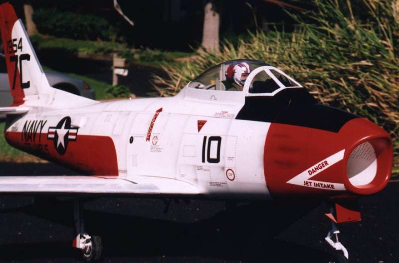

Good morning people,
I recently painted a jet with PPG Omni (Acrylic Enamel). I then clear coated it with Ultracoat Clear Spray. Bad idea, it leaves a rough finish, it is easy to stain, and it is already full of fingerprints. Yes, I let it dry for a couple of days. So, I applied more and more and my jet looks yellowish, with a bad clear coat.
OK, I will deffinetley sand it all out and leave just the base colors (600 grit should do it). But my question is, is there another clear coat that I could use with an airbrush (that will not cost me more than $50 a pint)? Can I use Aerogloss or similar?

Why not just use the Omni clear and do it right? Thin the Omni clear down between 150% and 200% Last time I bought the Omni I think it was around 40.00 a quart for the clear. Depending on temps, use the med or fast hardner. Is saving a few $$ really worth all the headaches of not using the right stuff [sm=confused.gif]

No its not worth it Im going to go to the Auto Shop today and buy the good stuff. Im tired of experimenting with crap, because in the end you get crap. I cannot use the "really" good stuff because I paint on my garage and don't have a respirator. I've painted with Omni products before, and though it gets me high at least I know I can survive it.
My worse regret, I will have to remake the decals for my ship.
Thanks for your suggestion Todd.

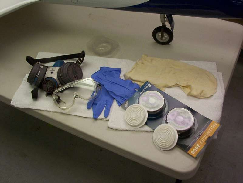

Inexpensive spray suit:
A good Binks respirator with fresh cartridges and particle filters, a cover for your head and face,
a pair of sealed eye goggles, a pair of good surgical gloves, clothes to protect your body, arms, legs and feet, sealing the pants to the socks with rubber bands or tightly wrapped tape and a long sleeved sweat shirt with the gloves pulled over the end of the sleeve and wrapped tight.
Total cost: $ 45.00 (and you can reuse the mask). Just keep it in a sealed bag and it is good for 8 hours in exposed air. Remember, the charcoal cartridge is filtering air every second it is exposed to it. There, sealing it in a resealable bag extends the usefull life.
