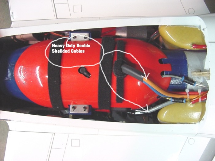

Sorry to hear you are battling. I think you are pretty sure that it is not radio problems.
I had a similar problem with my Kangeroo. I eventually put some thin silicon tubing around the EGT sensor which ran down the side of the motor and have had 55 trouble free flights since then.
If it was the pump, you should see it at idle as well. As some people have said before, no mounting boards of carbon fibre, try and seperate the RX and ECU batteries. Don't run their wires together. Try moving the controller around in the fuselage. Have you tried another whip antenna?
Good luck
Zane

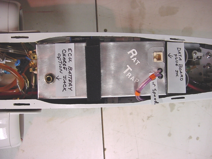

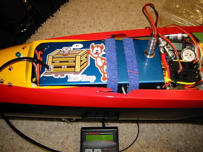

I have seen some early design ECU / Pump combinations that emitted RFI all throughout all of the turbine components, actually emitting strong enough interference to shorten even the best radio's range, so it was useless. The cure was to Trap all of the RF being created by the poor ECU / Pump design with very a carefully designed RF shielding system.
Actually, a friend here in Denver produced such a devise he calls it the Rat Tarp. It works very well and was designed for the early Jet Cat turbine systems. Jet Cat has since solved its RFI problems several years ago. But I can tell you the Rat Trap is very effective.
Trapping stray RF emissions is not something the light of heart should try. Jerry found out if you don't totally shield & trap all turbine components, which includes all cables running to and from the turbine, proper grounding of all electrical wiring, batteries, valves, pump etc., etc. the RF gremlins just pop out somewhere else.
So Roy, from what you have told us your problem sounds like it is mostly centered around your turbine components, possibly one that has a slight short to your turbines battery wiring system. Find out if this is a known type of problem (SimJet), they may have a quick fix ready for you.
Note: The range check you described has some flaws, one being you shouldn't be carrying the Receiver or even be near the receiver antenna. Carry the transmitter and have a friend with a cell phone (cell phones don't seem to effect our RF links) or a good walkie-talkie for communication. Remember you can do the range check with the transmitter antenna removed the Baseline number you should achieve if you've got a good RF link is 300 feet. Anything less than 225 feet with means your transmitter / receiver link is not tuned properly.
Using the Rat Trap Jerry's and my range is slightly more than 300 feet turbine running at full power, or 1/2 mile ant. fully extended. Full power is the worst RFI condition. Actually the startup sequence is even worse in the autostart turbines, but as the startup sequence ends it then is full power or fuel pump running at high speed.
Good luck,
Lee H. DeMary
AMA 36099
See PIC of a Rat Trap installation in my BobCat the finished Blue anodized unit, and Jerry's proto-type in his Bandit.

Same place same everything... what is your range with the ECU unplugged? It should be more than 1800 feet! If that is the case..... we can assume you have a good an RF link (Radio). Your description of symptoms is very similar to the extremely bad case of RFI (radio frequency interference) being generated by your turbine components.
If you like I can hook you up with the fello who designed the Rat Trap.. and for less than you might think his RF trap should fix the problem once and for all. The trap was designed for the JetCat turbine and its systems but I think it could be slightly modified to work with the Simjet turbine.
Just e-mail me at [email protected]
Lee
See pictured below the Rat Trap as installed in my BVM BobCat

Hi Roy Jimmy.
I had some trouble with my twin F-15 some years ago. And this was solved by wiring a connection to the negative on the pump pack, to the turbine.
The ducts got the same wiring, but just a short one to one screw holding the nozzle.
All long servo-leads got the same treatment. Leave the minus on the RC, DO NOT mess with this!
I used thin alu-tape to shield the leads. Connection on the servoleads was made near the pump-pack, but the clou is to have just one piont of connection for each object beeing earthed.
This solved it all for me back then, but the best is not to cure a syndrom, but instead get rid of the cause...(Yes, you have tried almost everything till now) Mine was also Fadecs as well, but I doubt your Fadec is the reason.
I think you have a serious interference problem due to the setup.
Also be sure not to have any alu close to the aerial wip! The alu sure will consume the most of the received signals.
If you do like i did, your setup will be like there was no longer servoleads than five cm each, depending of how thouroughly (how much in lenght) you have taped the servoleads) Interference will not enter your system due to the equal electrical potensial in all metal parts as this is absorbed by the negative... Think of it as a vacuume.
Remember, you must use the MINUS on the pump pack, no other!
I had manually start ECU`s, and had no trouble about voltage the engine with the pump pack.
It might be a different matter with a autostart..
Hope you a closer to a solution.
Regards
Gudmund
