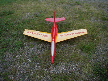

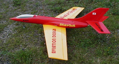

Yesterday I test flew my new starjet with RAM 500 power and it was supurb. I have fitted the Wren supplied fadec ECU and the combination is perfect, the model weighs 13lb 6oz dry and definatly the quickest RAM500 or MW54 plane I have seen and it lands at walking pace. Im well pleased

Hi Jason,
Glad it worked out well ! Post some pics. I'll eventually get my Starjet done but I first have to tackle my RAM problems. I'm going to replace the turbine wheel and perhaps the ECU. The saga continues....

Jason,
Can we see some pics of the starjet?? Please!?

Jason,
Well done ! It looks great ! I gotta get mine built. I'm working on the MW 54 today. Things are going well and no screw ups yet. Oops, I probably jinxed myself...
How did you finish it ? Some installation pics would be great.

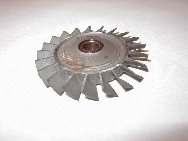

Hi Kelly,
While doing a bearing change after a very small number of runs, I saw that the turbine wheel had been bored off centre. The LE face of the turbine wheel was ground away to try to bring it into balance thereby comprimising its efficiency, balance and safety. I've decided to replace it with a wheel supplied by Wren. After that issue is sorted out I'll try to figure out my flaming out problem. Maybe a new ECU....
OK, that's a good enough reason...
The original 54mm wheel came from Wren in the first place you can't really do any wrong here.
Are you sending the engine to WREN for professional balancing? If not there are a few guys around Canada that can help you out if needed... Ed M, myself, and a few others I think. Internationally, you could send it to Carlos, Wren, ChrisM in Australia, etc. After the smoke clears, my system will be able to detect a felt pen mark on the shaft... Being that the imbalance function is parabolic, its critical on a 160K RPM engine! Its well worth it to send it to Wren or someone with the equipment, your bearings will thank you.
As far as the ECU is concerned... I'd recommend the manual / full auto FADEC by Gaspar, The GB Hobby unit, or our new TEMS ECU. I can have a full auto TEMS tailored to fit the 500 quite easily as it is almost exactly the same engine core as the PST J600. The PST just has a slightly higher mass flow because of a different compressor wheel. AMA approval for the 500 might get a bit sticky though. We plan to eventually have the TEMS approved with a bunch of 3rd party engines. Don't know the story for the GB or the FADEC.
Good luck, sorry to hear about your misfortune.
Kelly
The original 54mm wheel came from Wren in the first place you can't really do any wrong here.Are you sending the engine to WREN for professional balancing? If not there are a few guys around Canada that can help you out if needed... Ed M, myself, and a few others I think. Internationally, you could send it to Carlos, Wren, ChrisM in Australia, etc. After the smoke clears, my system will be able to detect a felt pen mark on the shaft... Being that the imbalance function is parabolic, its critical on a 160K RPM engine! Its well worth it to send it to Wren or someone with the equipment, your bearings will thank you.
Kelly

Just couldn't resist to respond here. Amazing to see the turbine wheel balanced that way. Is this the original that came from RAM or someone balance it afterward? Aerodynamic on the turbine wheel is critical and any turbine manufacturers know this.

Amazingly enough, this is how it came from the factory ! The asymmetrical grinding of the wheel was an attempt at making the wheel usable after it was bored off centre and crooked. It amazes me that it ran !
Kelly,
I'm using the static balancing method endorsed by Wren to balance my kit MW54 and the RAM. Is your balancing rig working ? I could pop out to YVR to have it done right if you're offering the service.
Kelly,
747, I would be more than happy to help out, just one hitch.
As it sits right now, I am set to maintain all parts of the engines we distribute, except for operations that require balancing. I have a system that I am comfortable using on KJ-66 derived homebuilts but I would not consider using it to offer services because its nowhere near capable of getting a repeatable 3 mg-cm balancing tolerance. (that's what our engines are built to)
On the other hand... I have the shaft mounting hardware for the new system I described earlier and this is easily adaptable for any current turbine design. Right now I'm still sorting out the electronic components, which should take another month and a bit. (didn't think I would need them yet...) Once I have verified the accuracy of the new unit I will be offering this service for our own warranty or 3rd party engine owners.
Here's how things generally work out. The shaft assembly is completely removed from the engine and the bearings are replaced with a set of inner races from another set of high tolerance steel bearings. The inner races ride in Teflon V-blocks on the balancing apparatus. The shaft components are then given phase markings, dynamic balanced, disasmantled again to reinstall the bearings, and reassembled inside the engine with the markings in line. I'm not familiar with the interference tolerances used in the 500's bearing fit on the shaft so it may or may not be easy to get them off. I will see what I can find out.
What I'd suggest you do is go with the WREN procedure for now, but just try not to run it on an hourly basis. With one of the ECU's I mentioned, you will probably want to...
If you are still interested, I'll let you know when I have things sorted out here and we can go from there.
Good luck,
Kelly
Good luck,
Kelly
