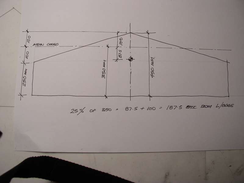

Could someone be good enough to check the CG calculation as per the sketch below.
Tapered wing with straight trailing edge.
Root chord 450mm
Tip chord 250mm
Mean chord = 350mm
25% Cg = 25% of 350 =87.5 mm plus distance from mean chord to leading edge = 100 =187.5mm behind leading edge?

Need the length of one of the wing panels.

tail volume and fuselage shape are also key variables too...

Wing panel is 950 mm long.Tailplane size is 600 long x 180 wide.

John;
You are good to go as calculated.

and what is the distance of the tail plane from the trailing edge of the wing? this airplane has a long nose and/or flat areas in the fuselage aft area? how much sweeptback has the tailplane?
sorry, but I cant´figure out a aproximate cg value without this info.

Here ya go...
http://www.geistware.com/rcmodeling/cg_calc.htm

Thanks for that. My calculation seems OK.

I agree. Looks like 180-195mm back will be fine. Maybe more depending on how radical you want it to fly. Me? I aim towards the front. Flick rolls ain't my thing!
