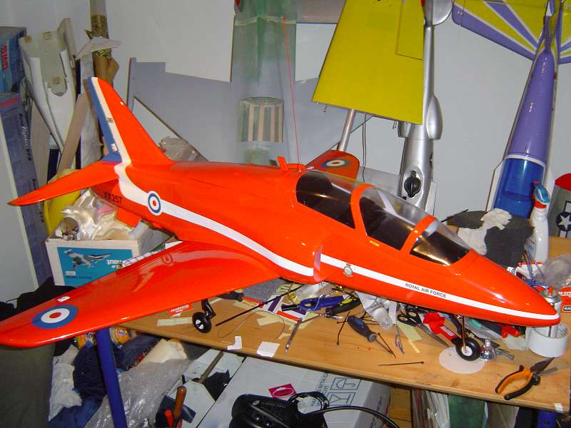

aileron hatches are not the tightest fit, but ok.......
still need to glue the inserts into the aileron bay that holt the hatch cover.

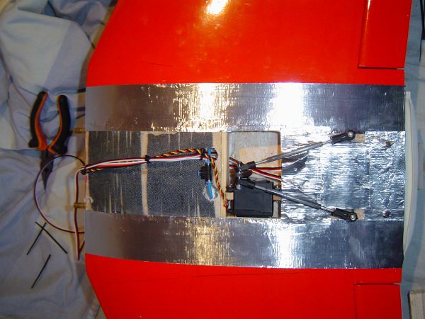

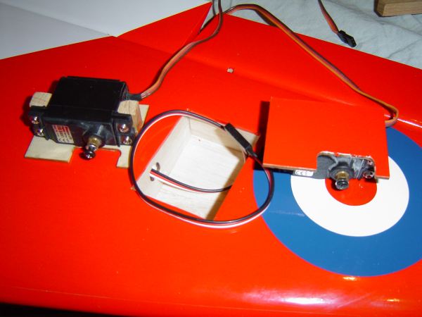

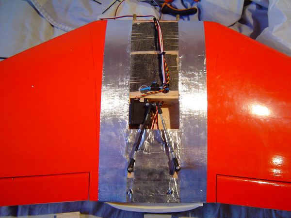

Got the flap servo installed.
Still have to glue on the flaps, and adjust....

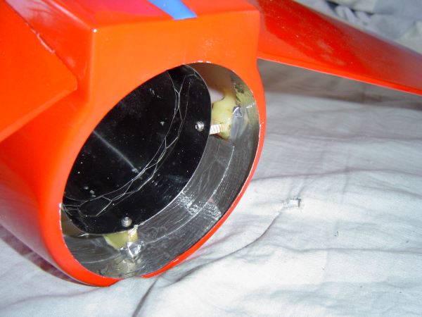

My friend installed an outer wall on my wren pipe for me.....now I wont have to worry too much about heat.......but it does weigh twice as much now than before.....the wahw doesn`t realy need any more tail weight, especialy with 2 servos down there too.

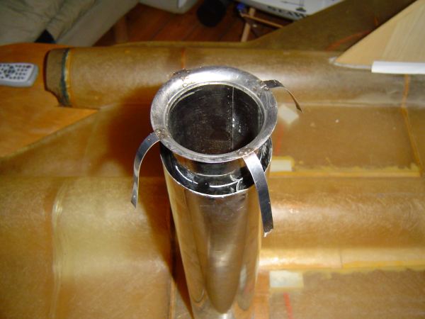

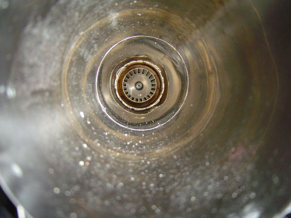

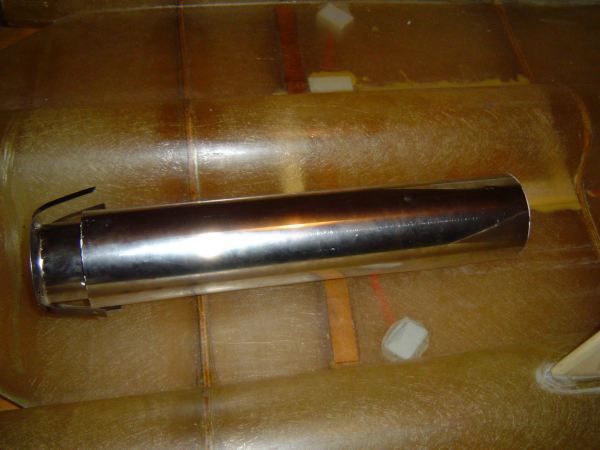

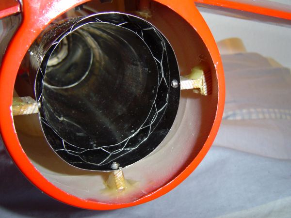

I screwwd up bigtime on the pipe....... It said 30mm from the tailcone to the inlet duct on the pipe in Wren`s drawing. What I failed to see, was that is for the 2 piece tailcone. The single piece cone only has to be 10mm from the inlet....... so my pipe is 20mm short ....dang..
But I dont think it will be a problem.......now I just have a huge venturi effect in the fuselage.....better cooling
What do you guys think ?

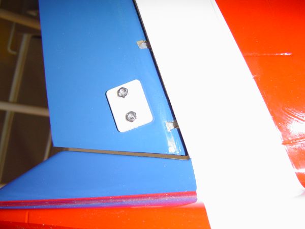

Finaly installed the rudder horn

Default RE: AMD Hawk.
The jetpipe can be up to 25mm from end of turbine outlet. That is one inch. Mine is set at 3/4" The only time it could be a problem is during a wet start. But you would have the hatch off anyway during the start. DB
What if you put the fiberglass exhaust shroud in. would that help? It may also help during a wet start.

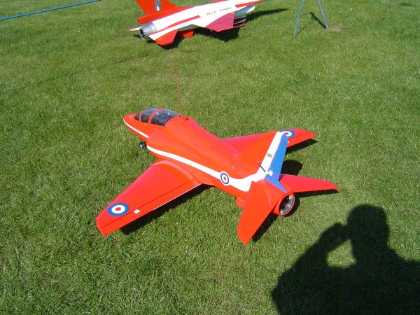

SJN
Posts: 6,326
Received 7 Likes on 7 Posts
From: Copenhagen, DENMARK
Thanks guys.
I have lines teh rear with some alu tape.
Ill have to feel the heat when starting up, and see what happens
I hope to fly the plane at our jet meeting in the weekend.......but there are lots of loose end that I still have to do......
Test start of the JJ wil also be there.

Old 04-21-2005 | 12:58 PM
  #244
Joined: Jan 2004
Posts: 2,081
From: glasgowScotland, UNITED KINGDOM
Sonnich
How did you set your elevator up?The instructions show +3mm? at the TE but there is no datum line on the fuz.
Hope it goes well at the weekend. BTW the Jetco is repaired and will fly again tomorrow!
John
Old 04-21-2005 | 01:11 PM
  #245
SJN
Posts: 6,326
I haven`t set mine up yet :-)
but Im giving it some up elevator in relation to the waterline of the whole plane.
I have no worries....im not going to maiden the it myself.... I have poeple for that
We have a guy that can fly a rafale on one elevon and canard only!
He also has no need for the sticks in the radio to center...he just holds them where the plane flys neutral

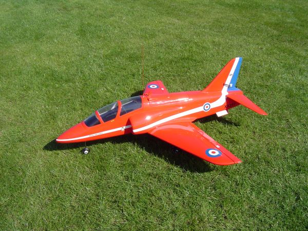

Just got her finished in time....i hope.
Maiden flight in 12 hours.......if the engine starts.....range checkes out....retracts work....and the list goes on........ [8D]
Noooooooooooooooo! [X(]

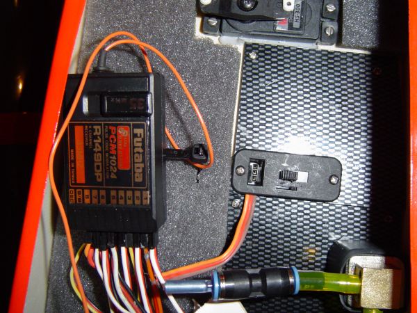

I did the next worst thing you can do today........
After starting the JJ-1400, I shut it down, and decided to charge the rx battery. I then inserted the charger lead into the switch with has the carging jack.........and then I mistakenly reversed the polarity. One milli-seccond, and my 149DP PCM reciver was now dead!
I drove 3 1/2 hours to fly, and I just killed the RX
Jezzes christ [8D]
I could hang myself now....
At least I had my hotspot with me, and I did manage to run the JJ engine once.
Startup went ok for a first start. CEO of Simjet, Lars Noer which was present , eagerly watched me start the JJ
I sould have primed the fuel lines with the prime function of the Fadec, But I forgot to . I also used a can of gass which was almost empty. This resulted in a little sputtering startup of the JJ, as I could see bubbles down the fuel line until it became stable. I had also fed the engine liquad butane, as I shook the gas bottle to get the last out of it, and that also contributed to the less than perfect startup.
Im sure the next startup will be problem free, as the lines are now full of fuel, and I have a new can of gas
It did not want to idle at the 47000rpm set in the ECU. It settled at 61000-62000 rpm. What can cause this?
Full power went quite quickly, maybe also contributed by my the higher idle. I did not messure the thrust, but it felt very strong.
The engine sounded quite high pitched compared to my 127000 rpm simjet 3000.
Lars said that this was probably due to bad alingment, and not unbalance. He said that this would not effect performance, of lifetme. The engine operated very smoothly.
In 3 weeks time, ill get the Hawk flying at the next jeet meeting !!
