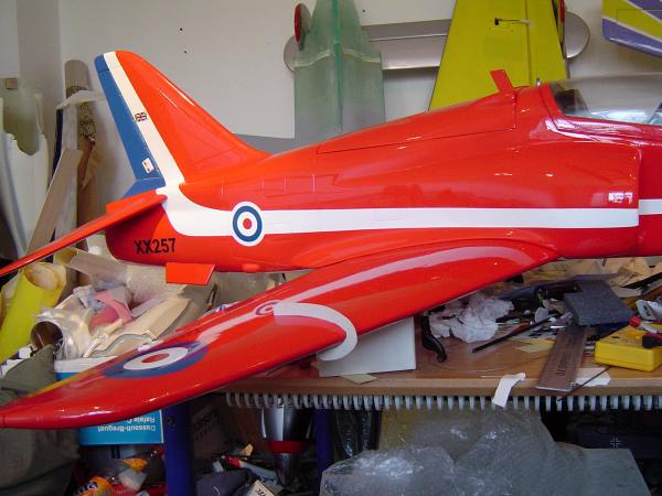

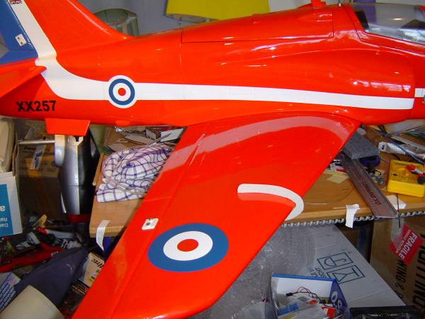

Ill cut my own template for the hawk myself. Just need to find some pictures. I was thinking of using some 5mm thick plastic card for the fences.

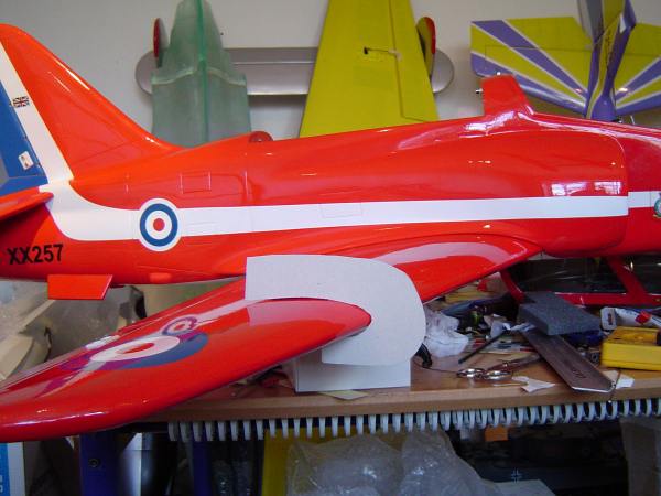

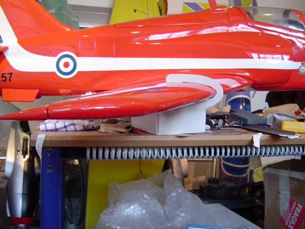

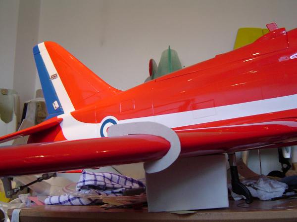

These look ok ?

I added a template for the fence a few pages back.
Old 04-24-2005 | 10:35 AM
  #260
SJN
Posts: 6,326
Received 7 Likes on 7 Posts
From: Copenhagen, DENMARK
Default RE: AMD Hawk.
Dave, I think it looks too tall....but it would probably work better...

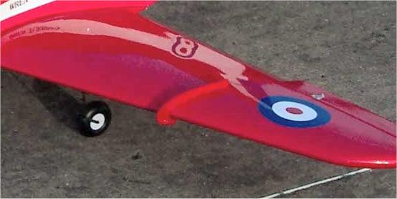

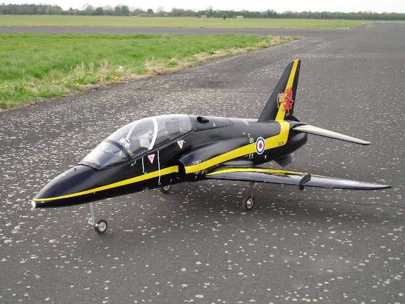

heres the wren Hawk...

too tall? it's scale.

SJN
I like Pic3 best. A little over scale is no bad thing. When you know the model and have a 100 flights under your belt, then think about shaving it back to scale! Thorpe will tell you the same thing on their Hawk.
Remember you have a few handicaps on this model - namely the tailplane is operating in a very different manner to the full size and any helping hand you can get must be a good thing.
On that maiden flight, use very little flap and as much speed as possible before you rotate. Rember climbing into the air with the help of the flap (eg.to get off grass quickly) can leave you with insufficient aileron authority and the result is usually fatal. Lots of speed equals safe.
Good luck.

Thanks Henry
Ill remember that [sm=thumbup.gif]
all 4 pictures above in my post are of the same fence. Why do you like #3 best ?

Maybe it is trick of the camera but to me it looks that fraction wider all round than the others.

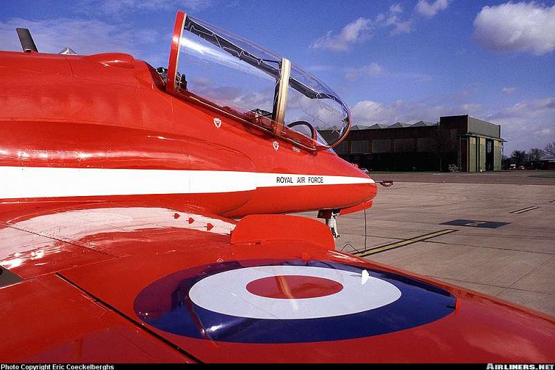

The tailplane on the full size rotates around a point substantially below the root wing rib and is mass balanced as well. I enclose a photo of the full size, showing the wing pivot. I have an AMD and a PJP Hawk (which replicates the full size and is shown below) and the different motions are immediately apparent. The flight characteristics are surprising different as well.

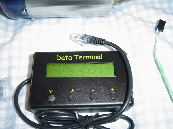

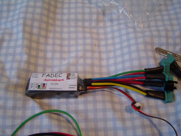

I need a picture or the ECU + Handheld device ASAP please
I need in the next 10 mins (for my DT project)
Old 04-27-2005 | 09:54 AM
  #274
SJN
Posts: 6,326
You have already got them on your site mate
ID:	263776   Click image for larger version
Old 04-27-2005 | 09:55 AM
  #275
Joined: Sep 2003
Posts: 1,828
ye lol.
My site is blocked from the school network....
I wonder why......
Thanks alot mate.
