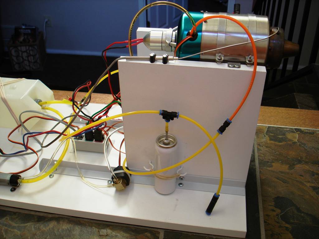

Just bought a used full auto start JJ1400 here on RCU, except for some tubing and festo fittings it is complete execpt for the on-board propane tank. What does everyone use? On another thread someone posted a pic of his test stand setup and the tank looks like a robart retract tank.

Old 03-26-2010 | 01:18 PM
  #2615
My Feedback: (48)
Joined: Nov 2007
Posts: 155
From: West Palm Beach, FL
Default RE: JetJoe OWNERS thread
Yes you are correct just copy the set up he has and use a one way Festo check valve to fill the tank.
Old 03-26-2010 | 02:02 PM
  #2616
Xairflyer's Avatar
Joined: Dec 2002
Posts: 2,766
From: Co. Donegal, IRELAND
The tank is not necessary and unless you are familiar with turbines you will have a lot more trouble getting it to start as the gas is much more temperamental.
Until you come competent with running the turbine just connect the gas line to your gas can via a check valve

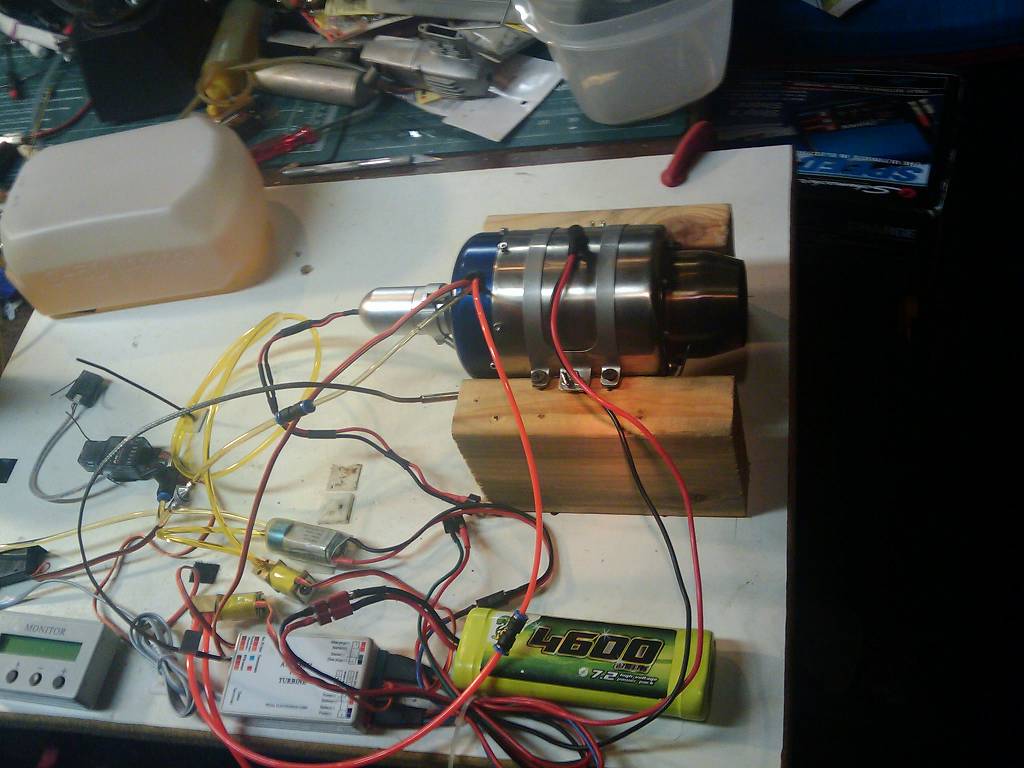

ok.. just tried to start my 1200... everytime i tried it ,did a glow test, ignited the gas, then i can see the kero move to the engine, then ramp then it stoped... the data terminal said "MODEAUTO".... what the hell is that? I have ran it once before.... puzzled....[sm=72_72.gif]
So what do you guys think?..... Chris

here is a pic of my messy test stand... need to redo it dont you think?

Old 03-27-2010 | 08:49 PM
  #2624
My Feedback: (48)
Joined: Nov 2007
Posts: 155
What is the voltage on the battery while it is doing this?
Old 03-27-2010 | 08:58 PM
  #2625
Xairflyer's Avatar
Joined: Dec 2002
Posts: 2,766
It is just telling you it is in auto mode.
It is probably because you have either too much (normal problem) or too little gas. Start of first with very little gas, big mistake most make is too much gas.
