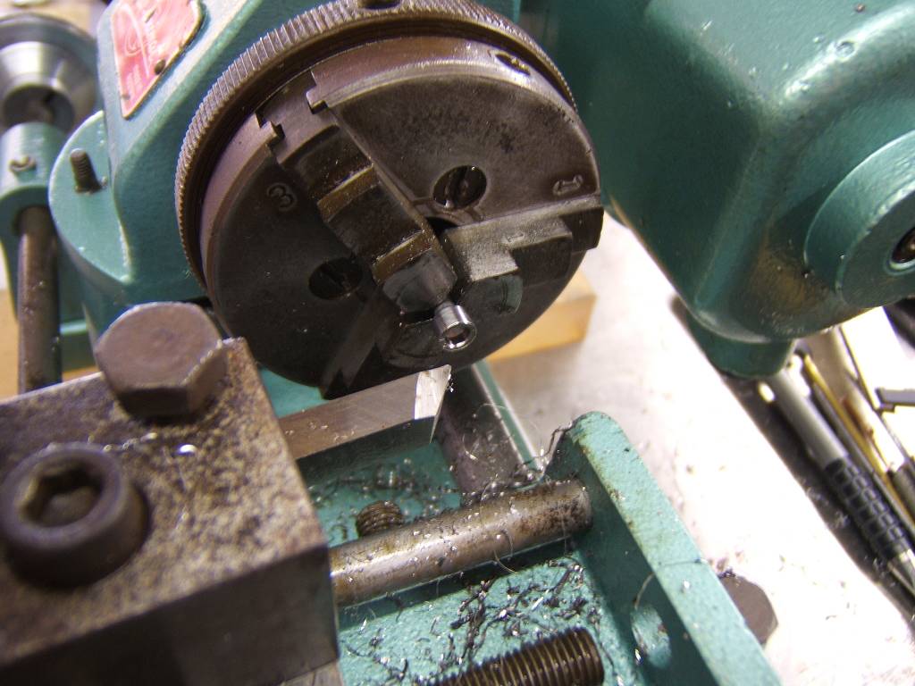

While I was making the fuel and gas rings,I had to make the connectors,which go through the diffuser. I used 3mm stainless cap screws and drilled a 1,5 mm hole,through the centre of it. This was fairly easy to do on the Unimat Mk2 lathe.
Regards
Craig
Regards
Craig

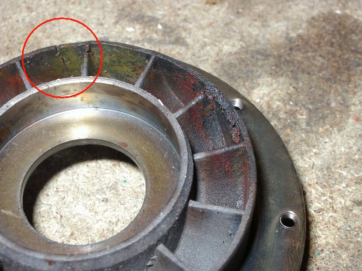

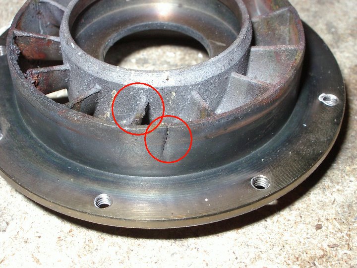

While everyone was focussed on looking at the damaged/corroded turbine vane, did anyone else happen to notice the rather ovbvious crack on the rim around from the corrosion?
The flattened area around the crack and distored vane (second picture) indicates to me that this thing was thumped, and rather hard.
Maybe that has something to do with the problems of this engine?
BJ
BJ

<div style="margin: 0in 0in 0pt"><span style="font-size: 9pt">I have a similar looking NGVout of one of my motors but nothing forceful happened (thumped) to it for me to think that these cracks were caused by anything but overheating. I had similar cracks and erosion that were not as bad and I managed to resurface the NGV to use again. My point is that I think that overheating can cause the cracks that cause the erosion. I assume this is the course of events that took place here versus erosion causing cracks. I also assume somethign else happened to this motor that caused the overheat in the first place.</span></div>
ORIGINAL: BJ64
BJ

took a closer look at my CC and found a couple of areas that are burnt thru by the NGV area-which had cracks in it.
I believe mine is Inconel. A couple of the tubes look a bit eroded but I was going to use the CC until I found the burnt areas.
I will order a new CC.

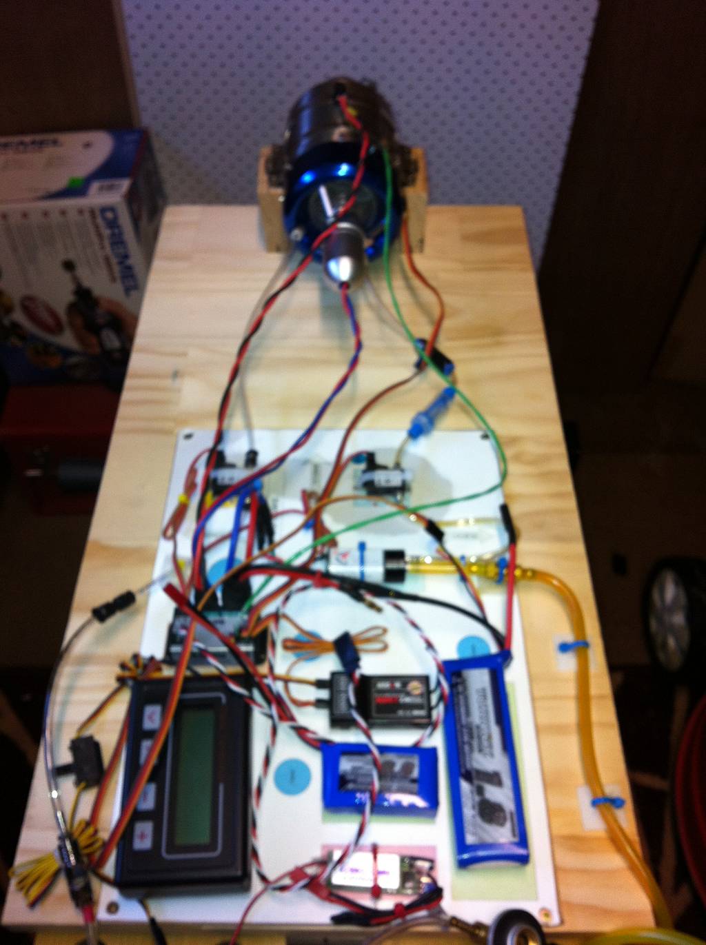

I hope someone can give me some advice on setting up a JJ-1400 with a genuine Xicoy V.10 FADEC
Recently I purchased a JJ1400 kit from Jet Joe and following his instructions and the information found on this forum assembled the engine
I decided for the electronics to purchase from Gaspar his Xicoy FADEC V.10, Gas and Fuel Solenoids, RPM Sensor and Thermocouple and a Flightworks 200C pump.
I have setup the FADEC with the default settings as Gaspars document suggests and have been able to run the engine first time without any real troubles (except for adjusting the gas flow) - so I am quite happy with that.
The problems that I'm having are:
1. On the cool-down cycle, the FADEC generates a Starter Overload error and this stops spinning the rotor. (Also is it normal what once an error has been generated that the FADEC will not respond unless it is reset - for initiating manual cool-down)
2. On Start-up, getting the gas flow right - Too Much and it wont light, too little it lights and goes out when the engine in spooled up. Ive found that if I open the valve gradually after it lights the engine will continue with the start sequence
3. Time it takes to bring the engine to idle rpm and stabilise it seems to take forever. Do I need to adjust the Pump Start Ramp value?

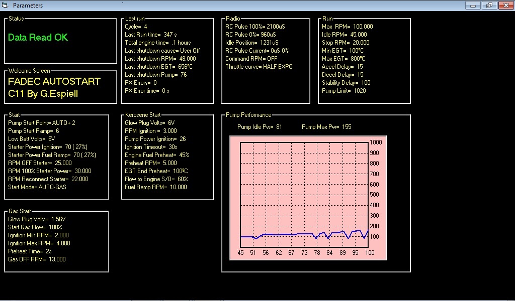

The FADEC settings are:
Full Power: 160,000 rpm (however I have set the limit to 100,000 rpm during initial setup and familiarisation with the engine)
Idle: 45,000 rpm
Stop: 20,000 rpm
Start Temperature: 100C
Max Temperature : 800C
Acceleration Delay: 015
Deceleration Delay: 015
Stability: 100
Pump Limit: 1020
Pump Start : Auto + 2
Pump Start Ramp: 006
Glow Plug: 1.5V
Start Gas Adjustment: 100%
Low Battery: 6.0V
Starter Power @ Ignition: 070
Ignition Max Rpm: 4.000
Ignition Min Rpm: 2.000
Preheat: 2.0 Seconds
Rpm Gas Off: 13.000
Starter Power @ Fuel Ramp: 070
Rpm 100% Starter Power: 30,000 rpm
Rpm Off Starter: 25,000 rpm
Rpm to Reconnect: 22,000 rpm
Start Mode: Auto-Gas
Thanks in advance for any help you can provide

well,the first thing i see is that the voltage of the glowplug is to low , is should be 2,2 volts minimum.
Then your problem with igniting is solved i think.
the error at the cooling mode , i never saw that , i have several v10 ecu's on different turbines , but it never gave that message.
Raize the startramp to 12 or higher , then the engine will spool up faster, and raize the gas shutdown valve to 30.000 rpm , 13.000 is much to low .
I hope this helps .

Very strange the gas cut off is only 13,000 surprised it actually ran.
Normally 25,000 is fine, JetJoes like wrens are fussy about gas, only way I have found to start them reliably without continually screwing at the gas can during startup is to fit a flow regulator. You need to set it by closing it off then blow through it until you get a slight hiss.
I thought the later (ver 6.0 and above) Gasper ECU's had a gas flow control like the jetcats, where the ecu pulses the gas valve to control the flow. This would make the flow regulator not needed.
Frema is right about glow plug being low at 1.5 but will depend on plug type used, only way to know for sure is to see what glow you are getting when it is turned on, if too hot it will burn out plugs too quick. Also make sure you have two coils well teased out of the plug.

A quick question though - Im using a OS A6 Hot plug - will it handle 2.2volts without burning out?
As to downloading the data from the FADEC, I bought a USB connector from Gaspar and using his free software, I can plug my laptop into the dataport (replacing the Data Terminal) and run the engine with all the running information appearing on the screen (its pretty neat)
It also has the ability to download the last 51minutes of engine running data for analysis - Im still to work that one out
In my opinion - it was good money spent.

Thanks Xairflyer,
Ive run the engine 4 times with these settings and once the gas flow is sufficient start process continues (although I have noticed the rpms drop a little when the fuel ramp starts)
I will make the changes as you and Martin have suggested and Ill see how that goes

#3274
Just seen from your down load screen the gas flow set at 100% so the ecu does have gas control. You will have to experiment, at the moment the ecu is just leaving the gas flow full (100%) I would set it to 80% then open your gas can a small amount a time until you get reliable starts, then mark the knob on the can so you know each time to open it 1 turn etc.
Down the road as you gain in experience you will find you dont even need to fit a gas valve but for now it should make things more reliable and safer to have it there.
