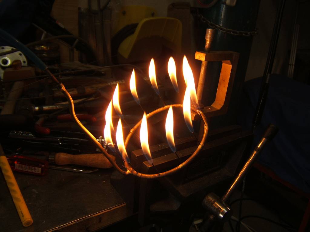

Old 08-03-2011 | 08:24 AM
  #3235
vortex00's Avatar
My Feedback: (22)
Posts: 225
From: St Louis, MO
Default RE: JetJoe OWNERS thread
just removed my 1400 from service after 22 hrs, about 100 flights-'07 vintage. Max RPM was dropping off.
found the NGV with some cracks, CC doesn't look bad, all the sticks are secure, a few have a buildup on them.
when doing the birthday candle test, only one ejector had a minimal flame. I suspected worse.
It's been a good motor and no flameouts.
Where's a good source for the NGV? talked to Mark the other day and have a call in for Glabe, but no response yet.
anyone getting parts from him?
will the Wren 54 NGV fit and can we get them?
who would be a good one for balancing?
thanks,
Jack

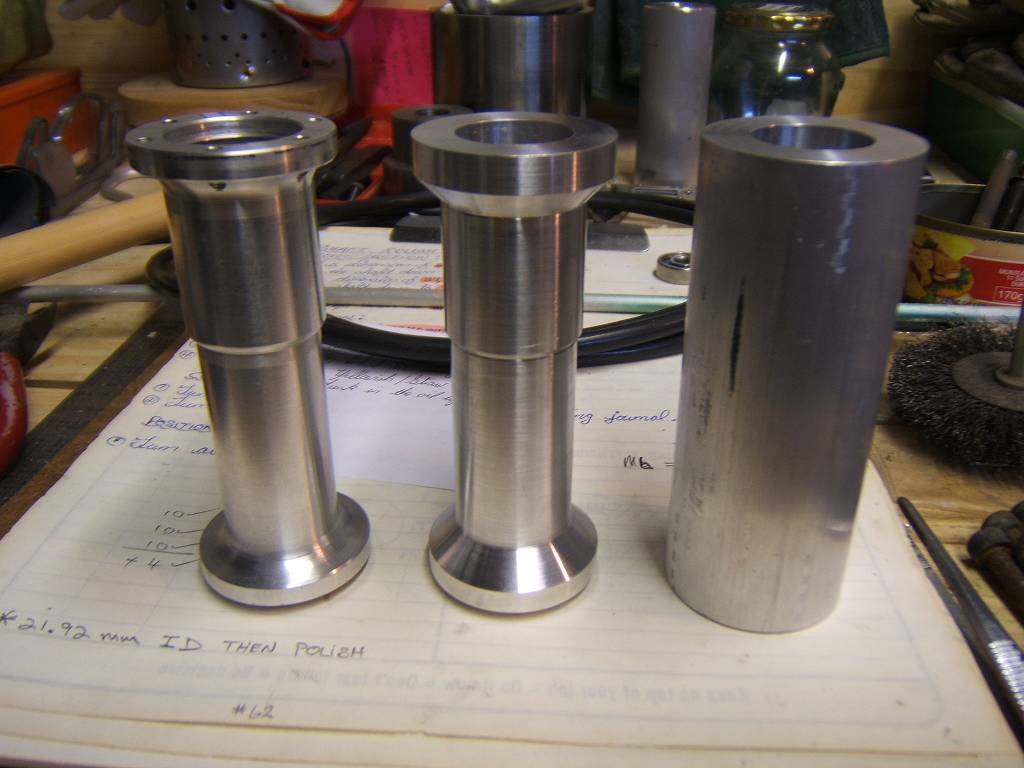

Old 08-12-2011 | 01:35 PM
  #3248
Joined: Jan 2004
Posts: 258
From: Cape TownN/A, SOUTH AFRICA
Hi Guys

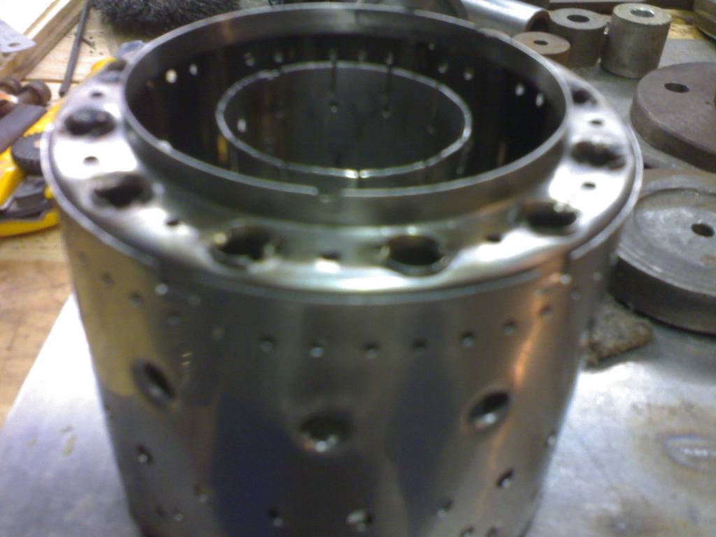

Its been a very long time,since I updated the progress of the combustion chamber for the JJ1800. Been away doing work related issues and have managed to get some work done on it. The combustion chamber has got 12 vapouriser tubes and 12 needles. The vapouriser tubes are incoloy 840 and the combustion chamber was made from 304 stainless steel.
Regards
Craig

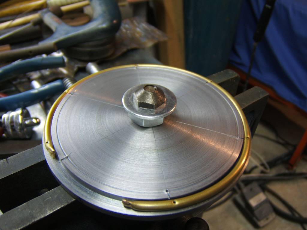

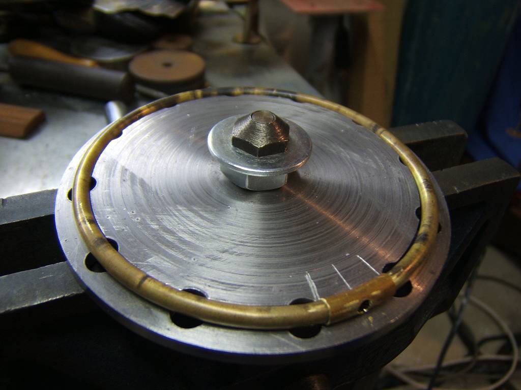

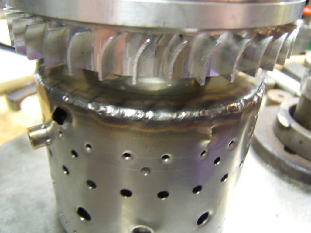

Old 08-12-2011 | 01:45 PM
  #3249
Joined: Jan 2004
Posts: 258
Hi

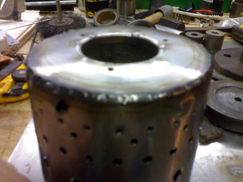

More pics of the combustion chamber,which was tig welded together,using 316L as a filler rod. The rear comb is "wired" in position,should it ever need to be removed,for repair etc. One thing for sure is that its not easy to weld 0,5 mm 304 grade stainless steel together.
Regards
Craig

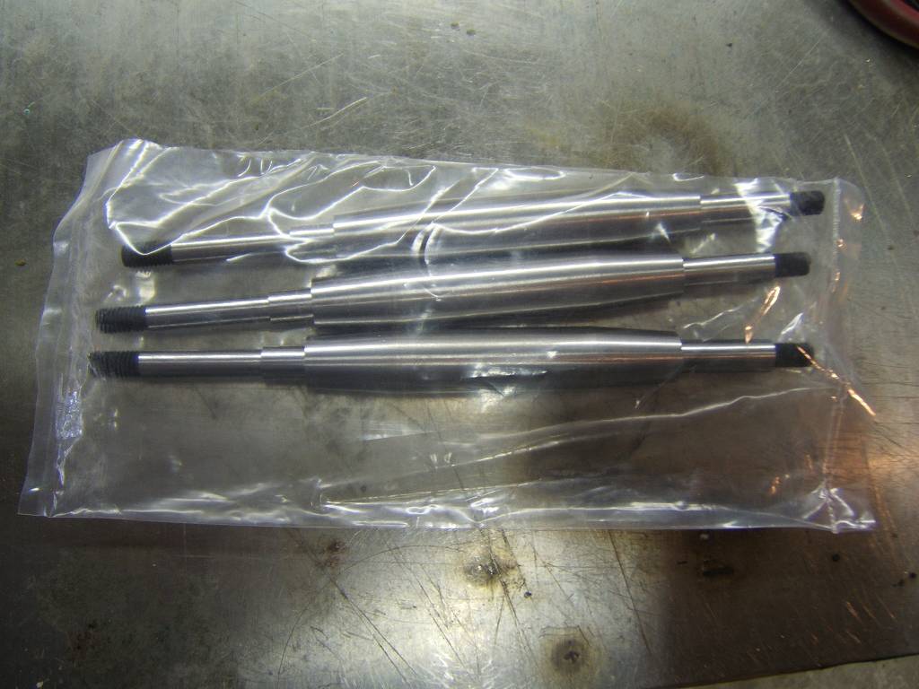

Old 08-13-2011 | 03:59 AM
  #3250
Joined: Jan 2004
Posts: 258
Hi.

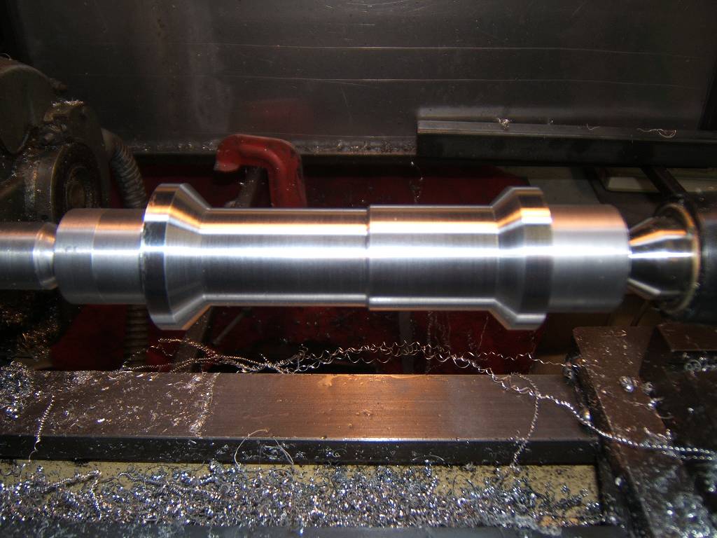

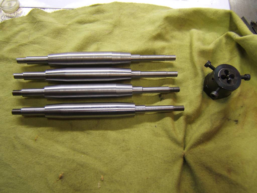

Here ar some pics of the shaft and shaft tunnel,for the JJ1800 which I made. The shafts were rough-cut,case hardened and then ground between centres.
Regards
Craig
