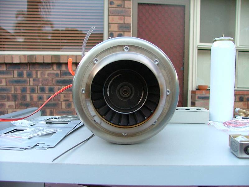

Smithy, What does the "Regal" ECU look like. I tried to post pic, but for some reason I can't. Could you take a pic of the back end of your turbine to show how the "sacrificial ring" is used to balance?

Tom,
I believe the "Regal" ECU looks nearly exactly the same as the Nades, just a different label. Here's an "ordinary" pic of my turbine wheel, it looks the same on both sides, no grinding inside the sacrificial rings.
