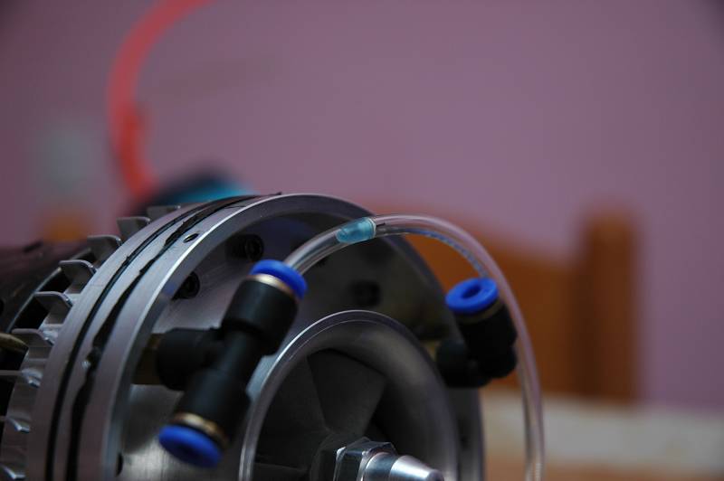

Hi,
I just got my new JJ1800 from Jetjoeus (Gabe).
He send me mail for a service bulletin to change two O-rings that support the front BB.
After opening the blue case, I found somthing that I'm not sure for it.
There's a small plastic with a needle inside the fuel line.
Can someone tell me if it's normal ? what it's doing there ? (Pictures attached)
Thanks.

That's the regulator for the oil line to the bearings.. The line is split, 1 side of the line goes to the injectors, the other is reduced by the needle and lets the fuel/oil go to the bearings..
Old 12-08-2007 | 12:04 PM
  #1258
Posts: 5,437
Received 8 Likes on 6 Posts
From: Slidell, LA LA
Default RE: JetJoe OWNERS thread
Jon is correct. It is a restriction, an orifice to reduce the flow of fuel/oil to the bearings. If it was not there, too much fuel/oil would be lost into the shaft tunnel.

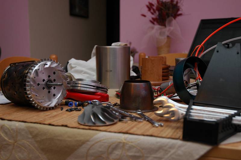

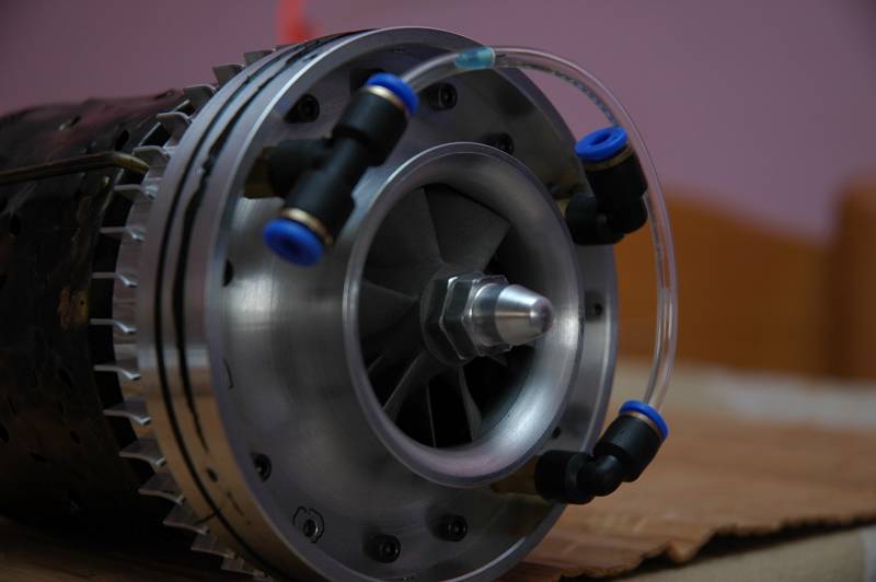

Hi i3dm
I got service bulletin from Gabe regarding the 2 O-rings that support the front BB.
Gabe advise me to send the engine back for quick repair or do it my self.
I choose the second option...
But everything went well and I will do test run tomorrow for the first time with the JJ1800.

How much time is on that combustion chamber? It looks like it is about done for. scott
Old 12-09-2007 | 01:25 AM
  #1262
snir2001's Avatar
Joined: May 2004
Posts: 252
From: Eilat, , ISRAEL
Actualy, it's new... about 15 minutes testing time befor sent to me.
