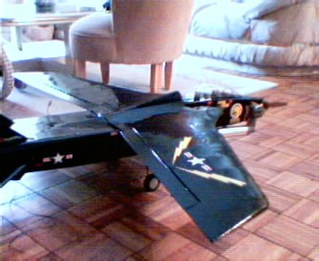

Old 10-09-2002 | 05:54 AM
rcdfnut's Avatar
Posts: 122
From: Brooklyn, NY,
Default pipework on a gp f-14??????/
my .00000001 cent.
I say just slap an ultrathrust muffler on the thing and launch. When it buzz by you in a blurr, seeing a muffler will be the last thing on your mind. Have one myself and this baby really cooks here is a shot
