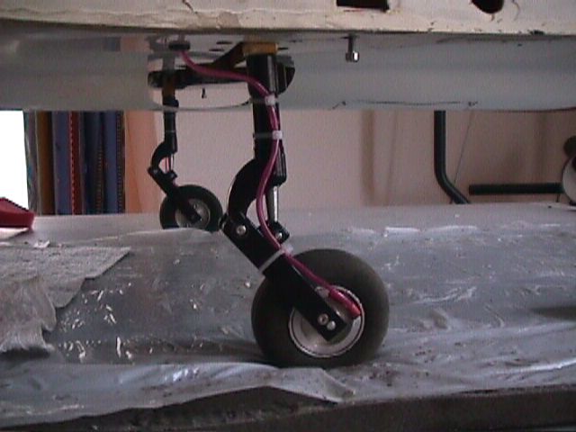

I want to share the new struts for my hotspot with you.
introduction:
till now I used the original Eurokit retracts and struts. both worked great, the 6mm steel pin , connecting the retract and the leg failed however. we fly at a smooth gras runway. once hard landed and this steel pin was bent. more worse, during rolling on the gras for take off, sometimes this piece of junk bent again. in the better case this led to an incomplete gear up situation. the worse case was, gear completely up, and switching to gear down for landing, one or both struts failed to come out.
therefore I decided to replace the week steel pin by a hardened steel one. this resulted in a severe damage of the retract mounting blocks after an emergancy landing.

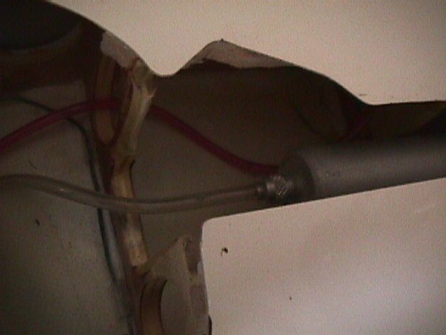

last week I was happy to see the new struts from P. Liebetrau. I decided to replace the old Eurokit ones.
it took me two hours, a little grinding had to be done due to the linkage.

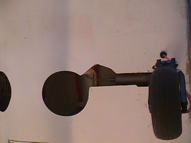

because of the better dampening charakteristics I decided to go for the hardened steel pin again.

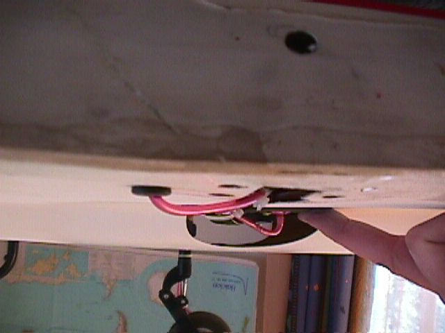

disadvantage: the fuselage does not accept the retract completely, there are 4mm left. This does not hurt, I do not use gear doors.
I think it is possible to fix this problem by using two washers between the retracts and retract mounts (only outer side).
