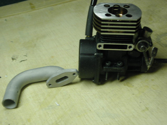

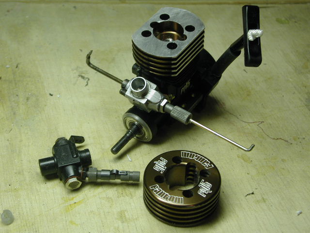

I went down to America's Robbery/Hobby Center today, and that discerning gentleman of great manners and taste, Marshall Winston, showed me all the various buggy engines.
There are two basic sizes of car engines, and the big block 21 sized engines will NOT fit. Too much of the engine mount on the fan unit would need to be hacked away. No dice.
So, I selected the most serious-looking 15 car engine that there was, the Fantom 15. This thing actually comes in a CAN, so it's got to be good. Reputedly will do 41,000 RPM. No typo. The car geeks there took a look at the stock Toki/HPI 18 and immediately recognized it as a mediocre car engine, good for 24K, tops.
The catch with this Fantom is it is side exhaust. I got a 180' header that I plan on cutting down, but when I fitted it all together, I realized I will have to get a second one with a 90' bend, and cut off just the elbow and work it all together with couplers to end up with the pipe going straight back where I want it to be.
The Fantom fit right on the mount, no problem, as all of the 12-15 class engines share the same mounting specs.
It comes with an enormous gold-anodized heat sink head, looks like Marge Simpson's hair. I hacksawed off half the head, then squared off the sides of what remained to get it to fit.
The fantom's carb, like most buggy carbs, has a needle valve coming out at a 45' angle, so I swapped out the carb for the one that came with the 18. They look to have the same barrel diameter, though the Fantom carb is 2-needle. Doubt if it is going to cost me much, if any, revs.
So far, so good. Engine fits, just need to work out the header configuration. In THEORY, we will have the toki fan spinning up to 40,000 revs.
This little black and gold monster set me back $200 with the header. Should have it all together soon and fitted into an airplane.

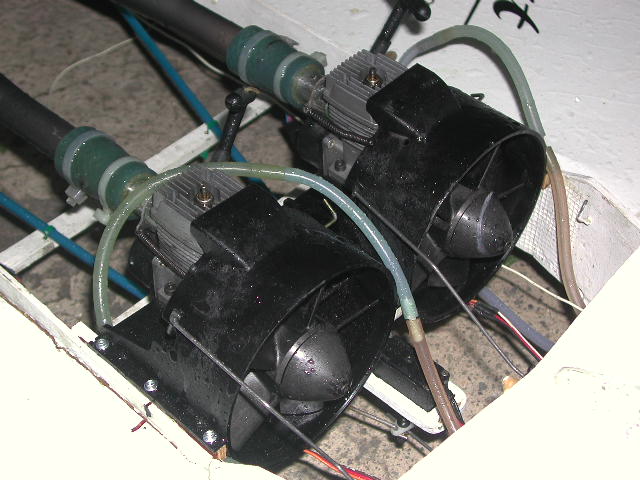

Here is Joe Beshar's TwinCat. He says it flies great, have not flown it myself...

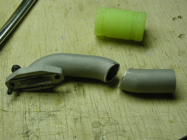

The header was a bit of an issue, as model cars exhaust in a totally different direction from DF models.
I bought two standard car headers. The first thing I did was open up the inside of the first header, as it was definitely too small to let the Fantom breathe...
Banned
My Feedback: (119)
And bound it all together with a silicone coupler. I think that flexible metal tubing headers exist for model cars. There are any number of different ways of skinning this cat. I have seen some model cars that had rather serpentine exhaust piping, with no ill effects.

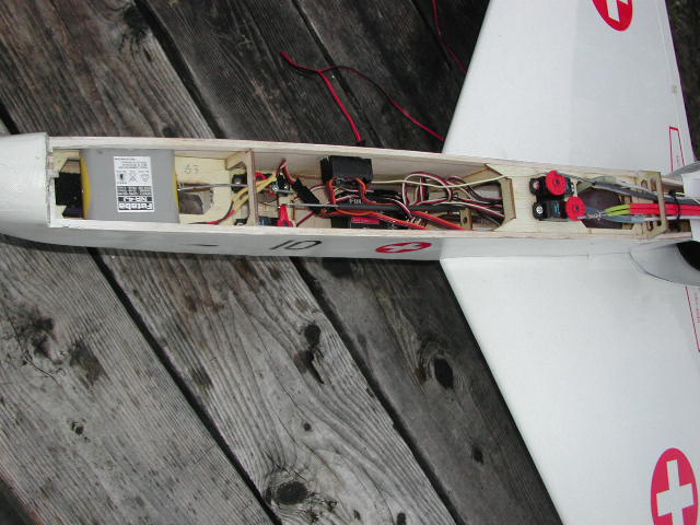

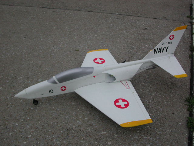

Here's the DJ3, the pride of Swiss Naval Aviation!
I had one short flight on her today, before I got wise and realized it was almost completely dark outside, and the plane was nearly invisible...
It took off with no problems, looks like a winner, but I won't file a real flight report until I get a real flight on her.
I am using the Fantom 15 setup, but it won't hold a needle setting just yet, I have only about 30 minutes of run time on it, it needs substantial break-in time.
I forgot to mark the spinner, so I could not tach it...
It's a work in progress, both the engine and the plane.
Some notes about the DJ3...
Somewhat complicated model, has 150 or so laser cut balsa parts.
Takes SEVEN miniservos. Not micros, and not full size. Why seven? Two for the ailerons, and TWO retract servos, a seperate one for the nosegear.
Has OK brand (that's the other name for Pilot) mechanical retracts. I prefer air. For sure. Maybe those mini springairs.
The nosegear retracts, but is not steerable. Bizarre, I know. And of course, there is absolutely zero ground handling because of it. I don't like that. You have to put the plane on the ground pointing into the wind and take off.

The quality of the kit is superb. It's not for the first time builder, though, and you can't just grab the glue and whack away at it...the methods of construction are quite unique, and you have to follow the photo illustrated directions on the plan carefully...
