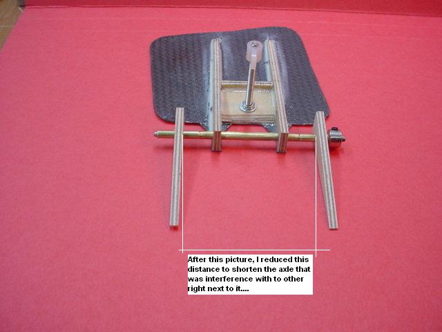

Last night worked with good company....my buddies Alexdu and Marcos passed by. James-no-fly didn't make it...he's about to get married....poor guy
Alex made me proud last night....after all this time helping me during assembling process, for first time he was working on his own assembling an small & flexible U-Can-Do (or He Can't Do?)...and better yet, getting his hand dirt with epoxy....waooooo[sm=thumbup.gif][sm=sunsmiley.gif]...front time to time he asked for [sm=drowning.gif], but it was ok
Back to the Viperjet.....made final adjustment to the nose gear doors..now is all ready.- It was one of those days when the things you did even after consuming few hours of your time, are almost imperceptible .
Anyway, bellow are few picture of how the nose door ended up. Is working flawless [8D].-
Next on the list...FINISHING THE SPEED BRAKES.
ID:	294617   Click image for larger version

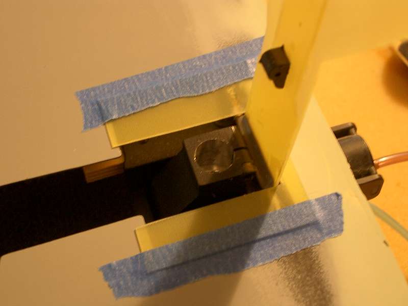

The Speed Brakes mounting bases at the fuselage require lots of P A T I E N to obtain an optimum result due the fuselage surface there is not quite flat at all. You can make all 4 bases at the same time with jig method, but then you'll have to work each one independently by try&error... .
ID:	294920   Click image for larger version
ID:	294921   Click image for larger version
ID:	294922   Click image for larger version

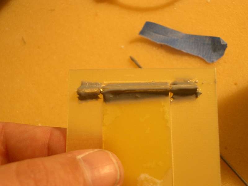

Cut a balsa block with a 70 degrees angle, which for my taste is an adequate angle of travel, and with double side tape, attach this balsa block to the speed brake and with masking tape secure it the the fuselage [sm=thumbup.gif]
Then with the air cylinder full extended and the clevis already at the horn you'll know the exact location to glue it at the fuselage....
ID:	296092   Click image for larger version
ID:	296093   Click image for larger version
