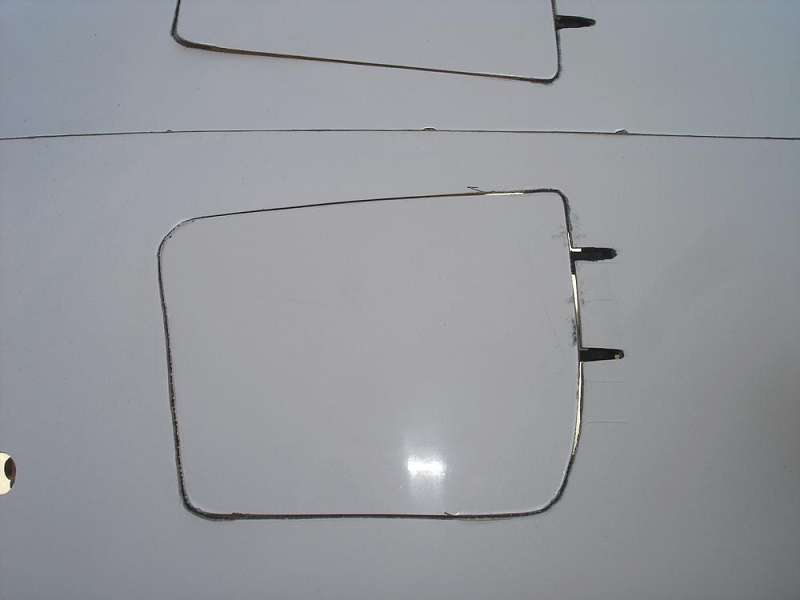

The inner doors are a little different. The entire mechnism is removable. I could not get inside the wing to mount the mechanism, so I made it on the outside to bolt in.
It is hard to tell from these pictures, but the hinges are removable, and are held in place by the inner door itself. I also do not show the up and down stop adjustments.
Like I said, these are not flush, but if you really want them to be, you can go back and butter them in with evercoat and sand them down. I did that on the BVM Viper

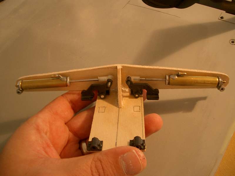

Today after coming back from weeken flying. I came up some tooling to make the speed brake easier to install without cutting wood parts.
I took the Super Hornet scale flaps hinges and playing around with it. I got an idea to make it to work for the Viper Jet speed brake.
I'll post some photos to show what it look like when I get to close to finished it.

Here is the photos of finish speed brake.
I use my flaps offset hinges. It go together very easier and solid.

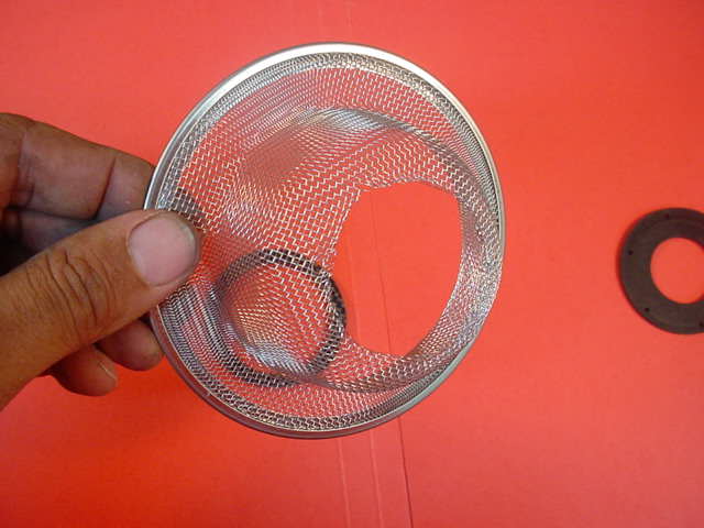

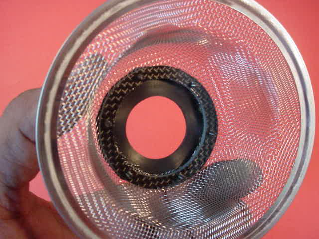

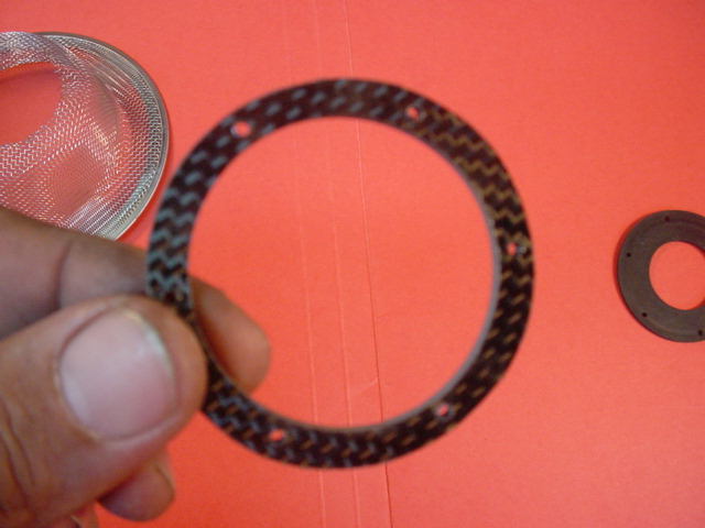

I decided to play a little bit with some ideas I had for a FOD design.....improvement(?)....and it worked.-
I never liked the idea of having the metal screen big hole touching a/o scratching the electric starter housing...and the possibility of one piece of metal getting loose and suck by the turbine...
The carbon fiber rim has 3mm in thickness and tapped with 2-56 holes. For the rest of details....I let the pictures talks by them self.
