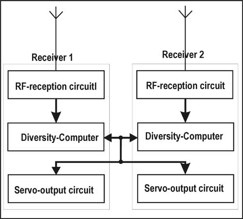

#54
What failures are possible with this system? What happens if one of the receivers fail?
What about this 'diversity computer'? Are there any failure modes that would cause the other receiver to get confused?
I can see where the benefits may lie, but is not a 'redundant system' as they are interconnected.
#55
though connected, it seems even if one rx fails, the other can still controle all 16 outputs.
http://www.acteurope.com/html/divers..._it_works.html

Hi
Sorry to nit pick but when you start talking about dual rx you are into a whole different ball game to just comparing PPM versus PCM rx. Such a system would work just as well if not better with PCM.
Plus Unless the two RX where operating on different frequencies then the ambient signal to noise ratio would bomb both rx out at the same time. ( regardless off antenna orientation)
But interesting all the same.

This is getting interesting.
I have a few observations,
1 PCM and the MPX IPD systems seem closely matched from the tests carried out by John above. ( No experience of IPD myself)
2 The Diversity system looks like you get Rx failure backup more that interference defense.
3 Where the Diversity system would provide a huge step forward in signal integrity would indeed be if they both were on different frequency's as Mike said above. My question is, How do we transmit on two different frequencies at the same time from the same Tx?

They sell a dual-frequency-TX-module. Then you transmit on two frequencies, receive with two frequencies and each receiver is able to reconstruct the whole RX-signal if some frames are lost. I think it´s the most perfect system availible nowadays! If you fly a JR/Graupner MC-24 you can buy their dual-TX-module and replace it without further modification to your transmitter and use dual frequency/dual receiver technology. Really promising!
Thomas
