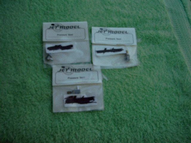

I have a new in the bag pressure fitting for sale if you need one or two.
Not the best pic. but what can I say.

I actually have on in it already. Ya see, once siclick33 edumacated me (hick), all seems to be well. I went outside, fueled her up and dam does that thing scream.
Taxied around a bit and all looks well, I'll be doing the maiden tomorrow.
Thanks for the offer.
