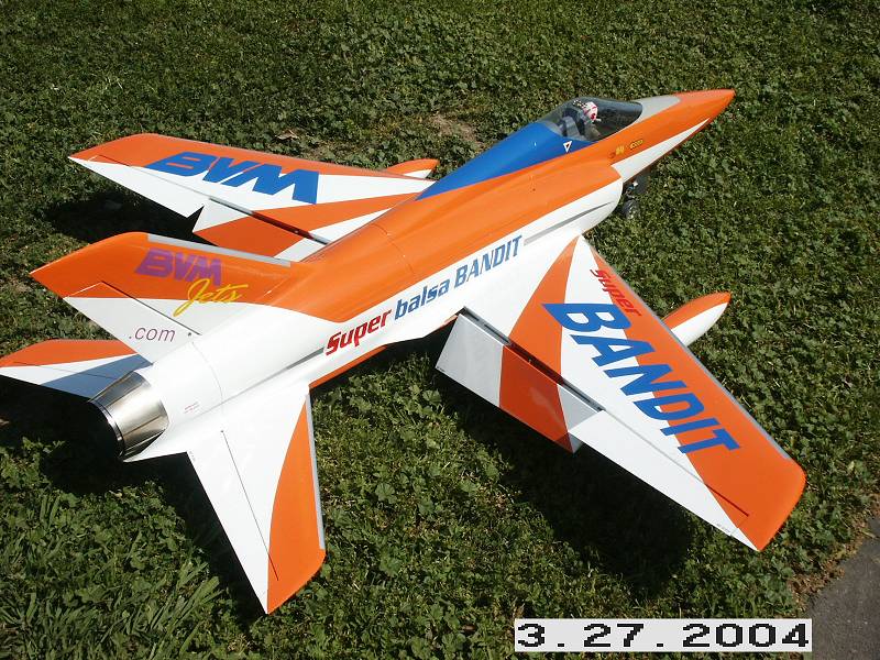

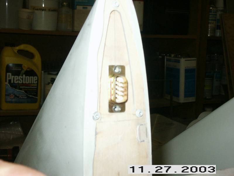

Here's how I did the wing in my Super Balsa Bandit.
Harley Condra
BVM REP
JetCat REP
Old 11-20-2005 | 07:57 PM
Posts: 2,341
From: Longwood , FL
Default RE: BVM EZ Air install question?????
Wonder why the pix didn't upload????????????
I'll try again.
Harley Condra
BVM REP
JetCat REP
