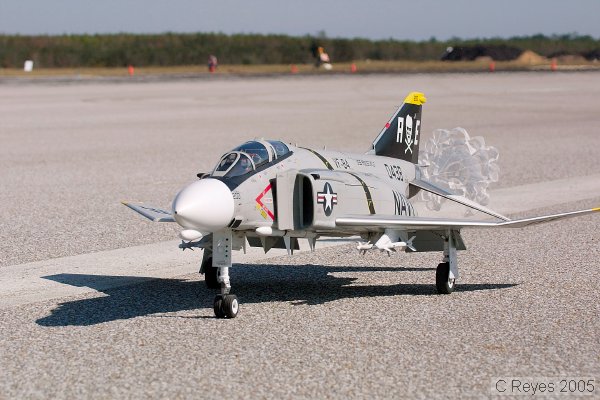

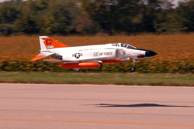

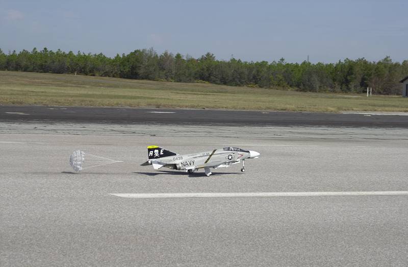

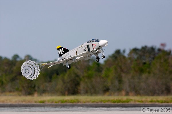

The F-4 is one of a kind. I think it’s better to set up your approach angle and speed on down wind and control altitude with power all the way to touch down... Drag chutes are sweet even when you hit the switch to soon as I did here. I just added power (to full) and she touched down sweet..Made for a cool pic..

That chute looks awesome. Where can you get it, and how much is it?
Cheers
Hank

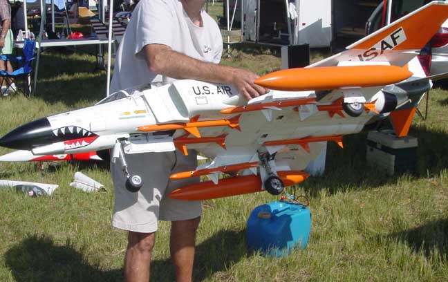

Patrick, I agree the F-4 looks good loaded up with missles. The fuselage mounted Sparrows are relativey easy, just a screw through the missle into some hardwood blocks inside the fus. The pylons are a different story which I describe as similar to building 4 little airplanes. I fiberglassed mine for strength and finish. One of the challenges is getting the pylons/tanks perfectly parallel to the fus centerline and you just need to measure carefully.
Joe Grice showed me this attach method for the tanks...brass tubes glued to the tanks that extend into brass tubes in the pylons and secured with 2-56 bolts. Very clean and secure.

Craig, Thanks for the great info. That seems to be a good way to mount those Wing tanks. I will try that. I guess you could do them the conventional way to where you mount them through the aluminum tubes inside the wing tanks right? Do you use a TITAN for yours? I will be using one for mine.

Patrick, Yes, you can mount the wing tanks through an aluminum tube but I have found that method leaves the tanks a little wobbly. My brass tubes run all the way through the tank and are glued top and bottom for more rigidity. Either way works.

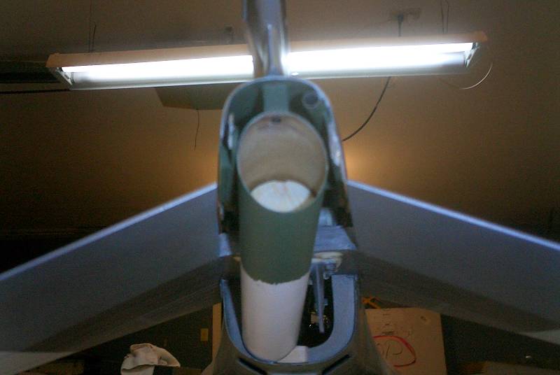

Sorry all I have are the ringed chutes I made the other parts per the F-4 plans. I am sure you will be happy with one of Justins chutes as well. I have 10 ringed chutes on hand you can reach me at 225-572-3723.
