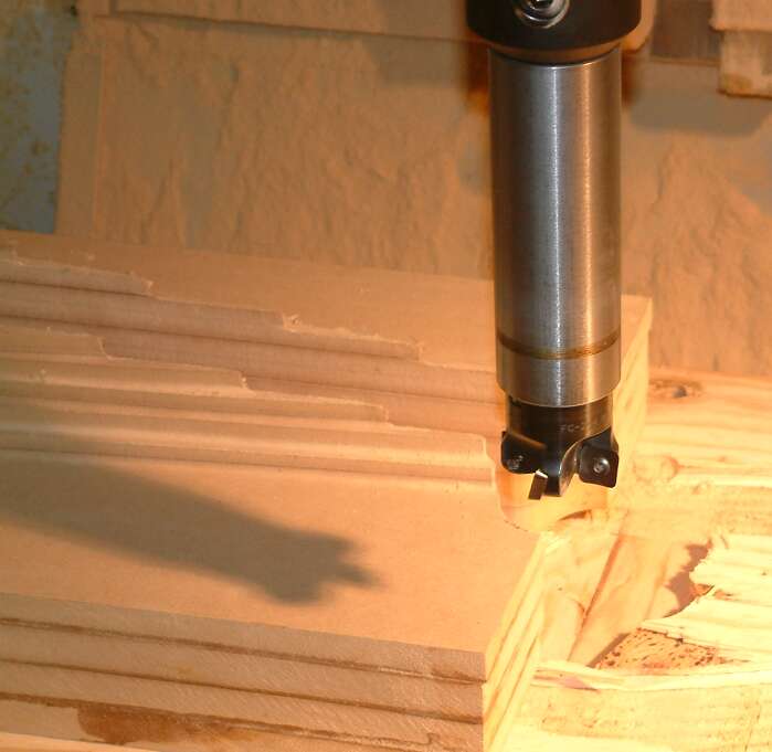

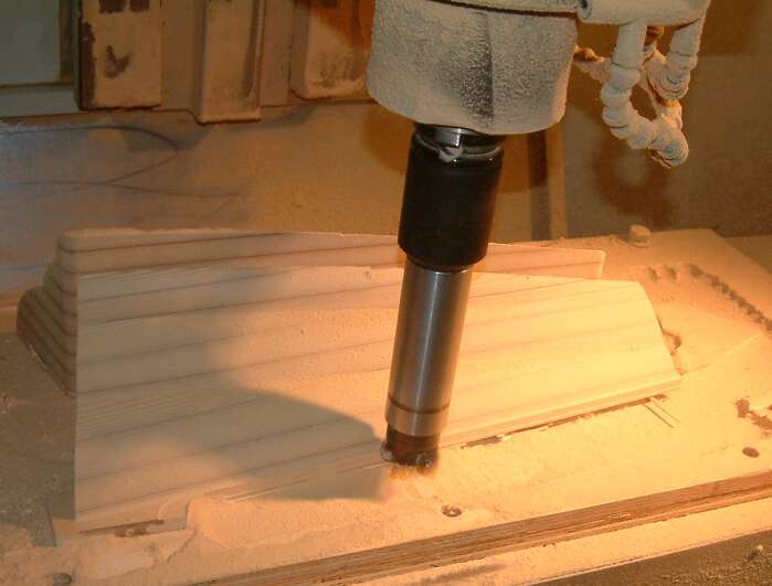

I spend all day at the machine shop cutting
the plug for the back hatches today. Here is
a small video of the final cut of the right side
back hatch.
RPM 5100, Depth of cut 0.062
Feed Rate 200 inch/min
Cutter: 2 inch Fly cutter with 4 carbide inserts
www.corpcomp.com/weeks1/movies/Back_Hatches.WMV
Eddie Weeks

Default Megabar Plug is cut
Roughing out the hatches...
0.400 depth of cut...
Old 11-23-2002 | 06:40 AM
  #35
Posts: 1,146
From: Baton Rouge, LA
Finish cut

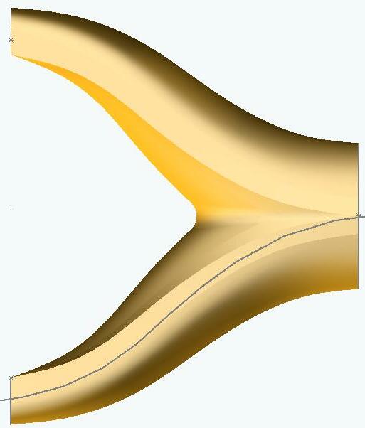

Here are two intakes that I designed for the Megabar..
Witch one do you think would work better. ?
One, with more less constant area or one with lots
of area.
Eddie Weeks

Old 11-27-2002 | 06:34 AM
  #42
BMT
Posts: 189
From: Cape TownCape, SOUTH AFRICA
Default Air Intakes
Hi Eddie,
Nice project. As far as intake ducts go for our models the more volume you have in front of the engine the better. General rule is that any duct that expands in volume should not have a sidewall slope of more than 7 degrees to prevent seperation of the airflow. This means that the air in front of the turbine is moving slower than at the intake and thus has more pressure, helping the compressor a bit and countering the negative pressure effect of the exhaust venturi effect in our bypass sytems from reducing the pressure the inlet sees. Narrow inlet duct + lots of bypass = easy flameout of the engine.
Cheers,
Andre

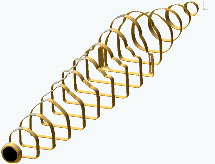

We started cutting the nose sections at 7:00 pm
and finished about 4 hours later.
Here is the computers ver of the nose.
