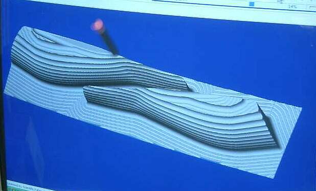

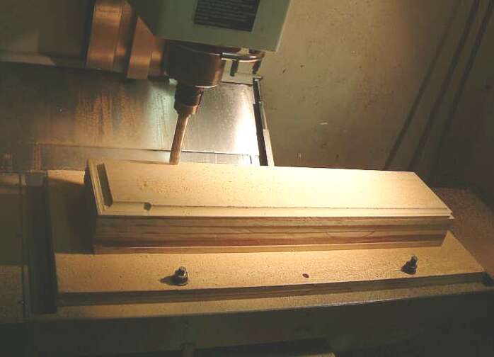

This winter I started a new plane called the Megabar...
The Isobar is ~80 inches long and the Megabar is 90.
The wings will be the same, along with the weight (I hope),
more room inside, very accurate plug for the molds and better fuel tanks.
The pics below are what I did today at the machine shop.
Darren (owner) and I cut the pug for the front hatch from
6 layers of MDF wood. We used 1 inch ball end mill, CNC
mill, 70,000 lines of code (G01s) to get the most accurate
plug possible.

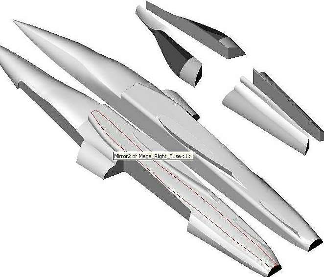

Over the last month, I learned a program call Solidworks
that I used to design the plane. (pic below) From this
drawing Darren ran another program called Surfcam witch
produced the 70,000 lines of machine code.
It took around 4 hours, at 90 inches/min at 7100 rpm with
the 1" ball end mill to cut the front hatches.....

all the parts that need to be cut

Default Megabar Plug is cut

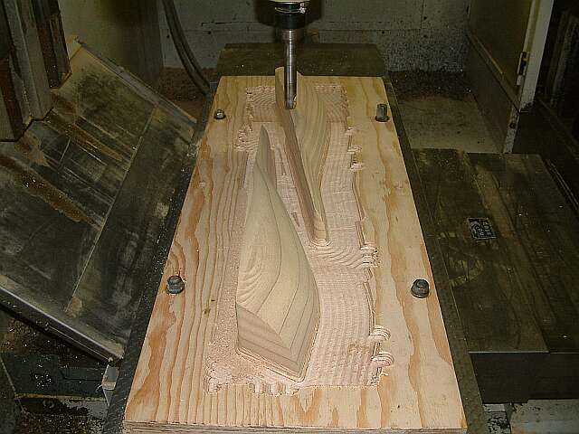

Its now cutting the finish cut on the right front hatch

This is what the mill started with...

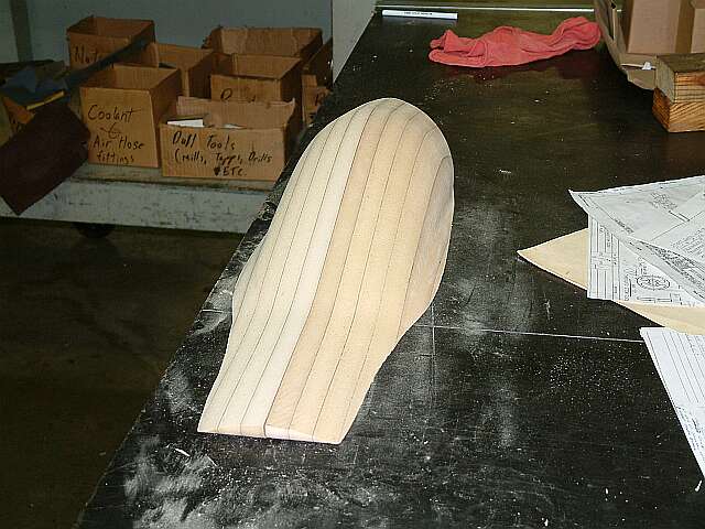

Here is the hatch finished....

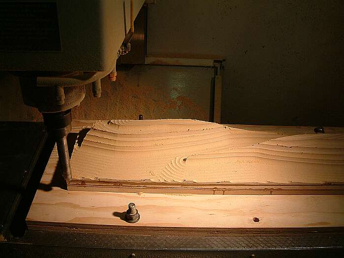

Halfway into the roughing
More pics at
http://www.corpcomp.com/weeks1/
Hi Eddie, it looks great, but what is worse learning solid works or the dust from the MDF? I will be upgrading to the latest version of solid works but the program still has a lot of dead ends!What type of file are you exporting to your cam program ? Who sells surcam,looks like I may look into it?
Brg,
Don
Old 11-17-2002 | 06:39 PM
Posts: 1,146
From: Baton Rouge, LA
One just takes time and the other takes a large shop vac....
I was really worried about the dust at first but for the
4 hours of cutting I sat there holding the shop
vac right by the cutting head. Next to no dust left the
machine.
Surfcam reads Autocad, DFX, Solidworks, Parasolid
and a lot more..
http://www.surfware.com/index.htm
Once in Surfcam, you simply pic the tool, depth of cut,
and a bunch of other stuff, and It will tell you how long
it will take, show you the tool path, and write the
machine code... btw.. Surfcam is only $25,000
Eddie Weeks

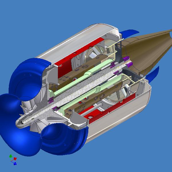

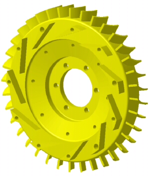

I've been using Inventor and Solidworks for some time now. Surfcam is great too. This is what I been drawing for the past couple of weeks. Will you cut me one of these too.

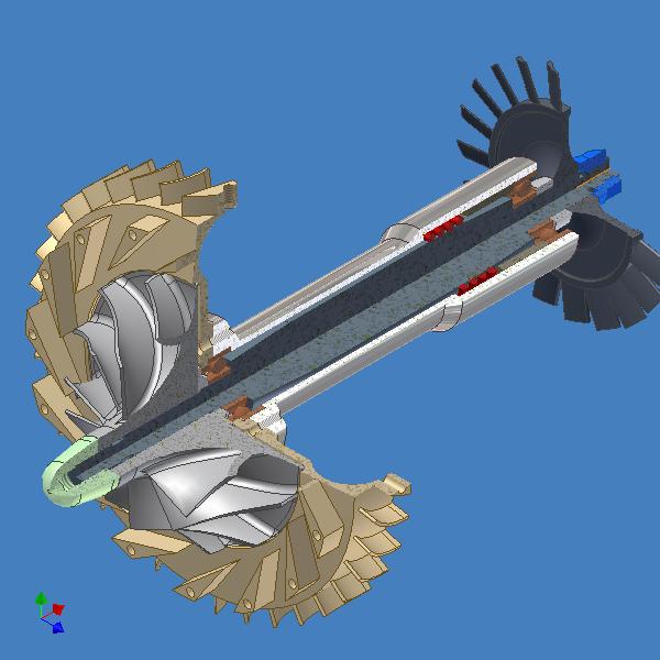

Here is another one.

Nice work! I did that too a 2 years ago from KJ66 plan on Inventor. I'm a CAO teacher and we used Inventor. Now we're on CATIA V5. I'm doing the MW54 by now (i deleted all my Inventor stuff ). I think that Your compressor look better than mine I did one but it is simplier. Now i'm at work so i will post some pics of my work tonight.
Old 11-18-2002 | 03:06 PM
My Feedback: (20)
Posts: 102
From: Humble, TX
Cool, I dabble with it on occasion. I have a full helicopter drawn in inventor to scale about 1000 parts. The compressor is pretty close to scale. That was the most challenging with that type of sweep. My intention were to do what Eddie is doing, cnc cut some plugs for production. I have a bunch of scale models of jets that would make some great aircraft. Just finding a cnc machine to do it is the problem $$$. I'm working on building my own large scale CNC router.
Barclay
Old 11-18-2002 | 03:56 PM
Joined: Aug 2002
Posts: 441
From: Laterriere, QC, CANADA

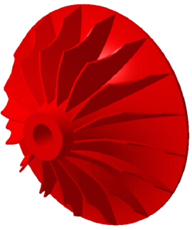

Yeah the most difficult part to do is the compressor. I did mine in the surface module ( you dont have that in Inventor) My compressor have the real outline but i did the 'impeller' right from my mind ( i dont have one, so i looked at pictures)
