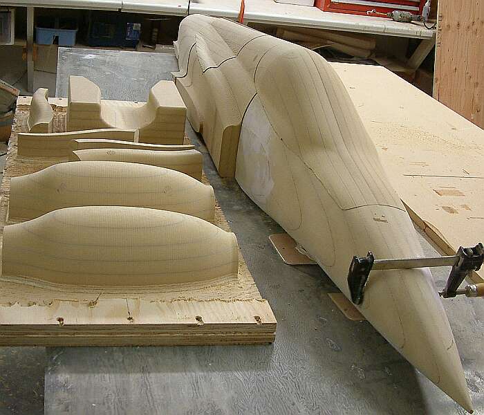

Well its safe to say, what ever engine the Megabar will have
it will have some ass.

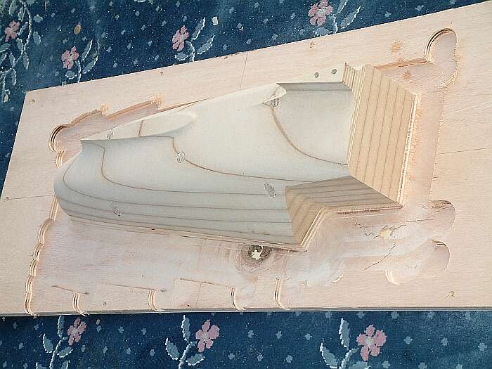

We spent all night trying to cut the two parts below
and every thing was going well till the cutter running
at 350in/min knocked off a large section of the fuse.
It was not a error, it was just not glued down well
enough. (my fault, long story)

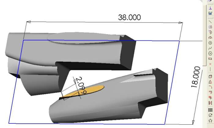

We also had some problem getting the machine to cut
such a large part. There was only 0.300" to spare out
of 38".
Tonight we decided to just cut one part at a time. I made a
stack of nine 3/4 inch boards of MDF. Drilled five 5/8 holes
through the 7 inches of wood and inserted five, 1/2" all tread
rods. After gluing together, nuts were tighten to smash
the boards together a tight as possible. Later the all tread
was removed and replaced with 5/8" dowel rods..

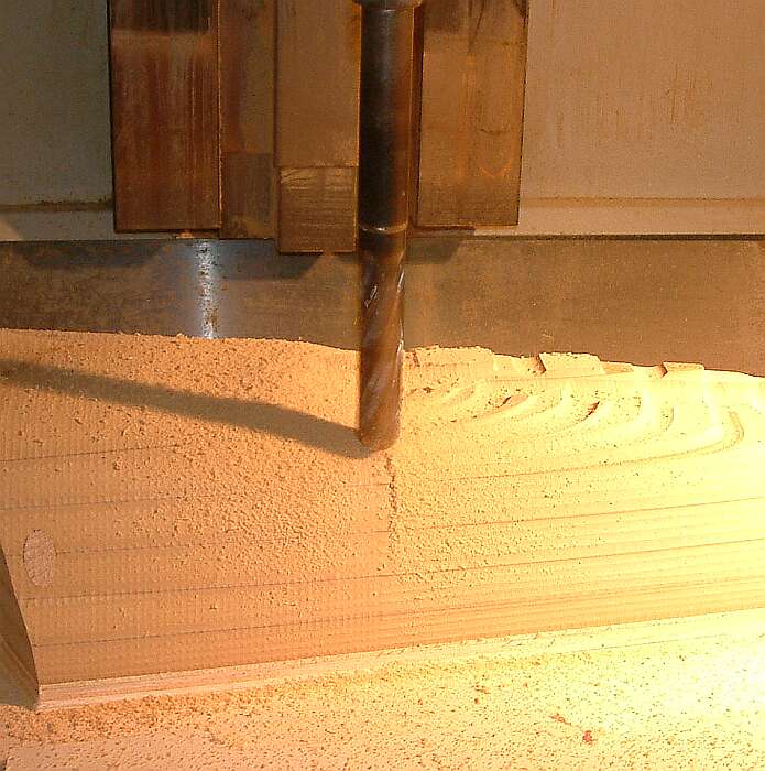

This smaller part took 60,000 lines of G code and was finished
in 1:20 flat using a 2 inch fly cutter at 350 in/min at 5100 rpms
with a depth of cut of 0.175. Then two different finish passes
of the 1" ball endmill, 8 inchs long at 7000 rpms
The part came out perfect.
I will have some pics tomorrow after we cut the other side.
Eddie Weeks

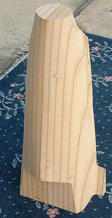

right tail section

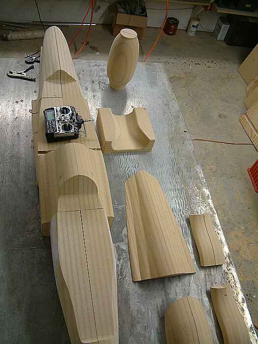

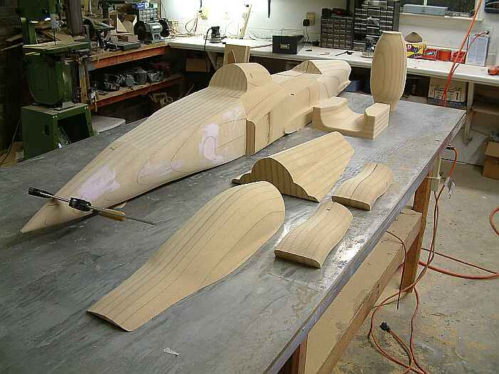

After 10 nights at the machine shop, Darren and I
are done with the Megabar plugs. They are big,
heavy, solid and accurate and are just like the
drawing. Here are a few pic, and Rocketboy
I don't know how I am going to lift it because
just the mid section plug of the left side is a job
to carry around.
Maybe I will not have to move the plugs much..
Eddie Weeks

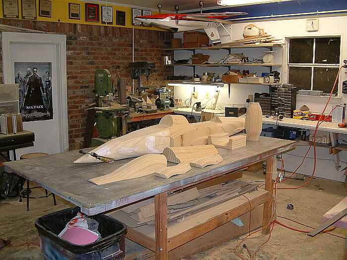

I was on my way to buy a large chunk of Polyurethane Tooling Board from Freeman but the cost for the cheep stuff was
over $1000. The MDF wood was ~$16 for 4x8 sheet of 3/4".
And we cut it at 350 in/min. The wood is far heaver at around
~60 lbs/ft^3
A good friend of mine, Darren, who I have know for years
owns the company that has the 4th axis CNC and Surfcam.
Darren is a Master Programer in G code and just a few hours
ago he ran a 170,000 line program in 4 hours without stopping
once. (we did stop to take a few pics)
If you want I can make a MDF board for you. Any thinkness
, any size, (you pay shipping).
Eddie

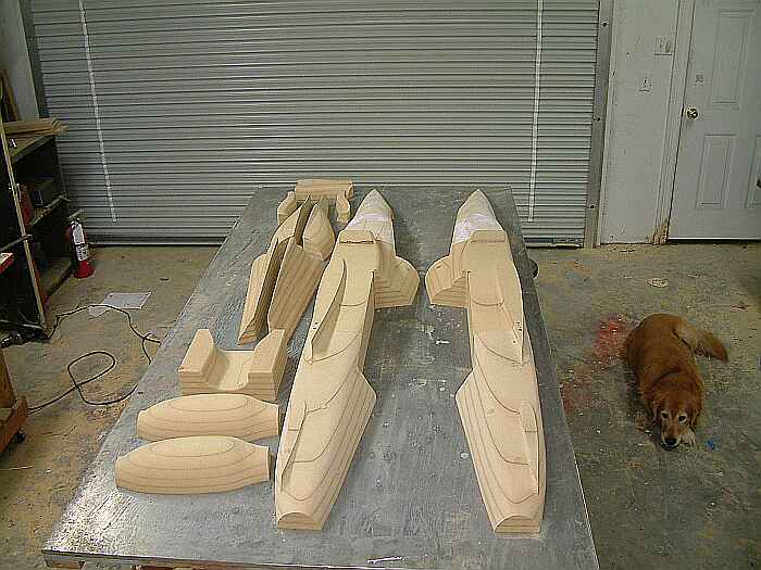

This pic show how big the Megabar is.
Its 90 inchs long and takes up the whole 8 foot table.
I should be able to see it ok in the air..
