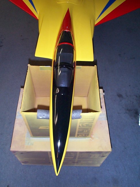

Ok...For those of you who would like to be able to get a nice finish from a spray can, here's what you can do. Primer the entire plane with krylon gray primer. Paint the plane as desired with FLAT Krylon colors of your choice. Use 3M Scotch Plastic Tape for masking lines between colors, this stuff is awesome...Nice crisp edges and flexable enough to make curves (kinda like good electrical tape) and comes in various widths. When done painting carefully take a scotch pad and and run it down the edges of the colors to knock the high edge off. Wipe the entire plane down with denatured alcohol. Now, the clear. The clear I am about to recommend is very easy to apply but you will need a decent gun to do the job right (Walcom STM HVLP is the gun I use), if you dont have the means to apply the clear then buy it and take your plane to a paint shop and have them spray it for you.
You want to go to your local automotive paint supply store and get PPG OMNI AU HIGH SOLIDS URETHANE CLEAR part # MC161 and you will need the hardner for it which comes in slow, medium and fast cure. I prefer the fast MH167 which is the easiest to work with since it gets sticky moments after application, this give the clear a bite so it does not tend to run or sag. This clear is 100% compatible with Krylon paint and the finish looks as good as the PPG base coats. I have yet to do a FULL paint job using this technique but have mixed in some Krylon colors with my PPG's with no incompatibilities with the PPG base or clear coat. The F15 below was painted with the above technique for the black. Hope this helps...Feel free to email me with any questions.

I don't claim to be a master but I use the 3M Fine line tape, the blue stuff, and I did sleep at a Holiday Inn one night. If you lightly burnish the fine line tape down it will not bleed under it. THen back mask away from it with the regular 3M masking tape. Don't use the cheapo stuff that you can get at the ACE hardware store, it leaves a residue, and bleeds like crazy.

David has got it on the nose! The 3M plastic fine line tape is the NUTS! Have yet to have a bleed through using that stuff.

When do you guys remove the 3m tape? I find that if I remove it after the paint has dried for 24 hours I often tear off a portion of the paint I just applied, but if I remove it while the paint is still drying then I don't have that problem. Of course if I use option 2 then it's much more effort to apply a second coat since I have to re-tape, and I run the risk of getting dust in the freshly painted surface. I usually opt for option 1 then touch up the damaged areas with a fine brush before clearing. Do you have any tips?
Posts: 3,241
From: Oxford, MS
If you have to leave the tape on for second coats hit it with some 600 grit wet. Just run the paper down the tape lightly and it should break the spots that cause it to pull paint up. I usually try to pull the tape as I the paint is drying though. I use the DBC paints like John mentioned and you can mask the next color within 15 about minutes.
My Feedback: (24)
Posts: 6,102
From: Daytona Beach
I usally paint my coats about ten minutes apart, when the paint is dry to the touch and I am done with that color I pull the tape (aprox 15 min from last coat). Never had an edge pull with this method? As John and David mentioned, PPG Base coats dry fast, I can tape on a color I just sprayed within 15 min of application.
