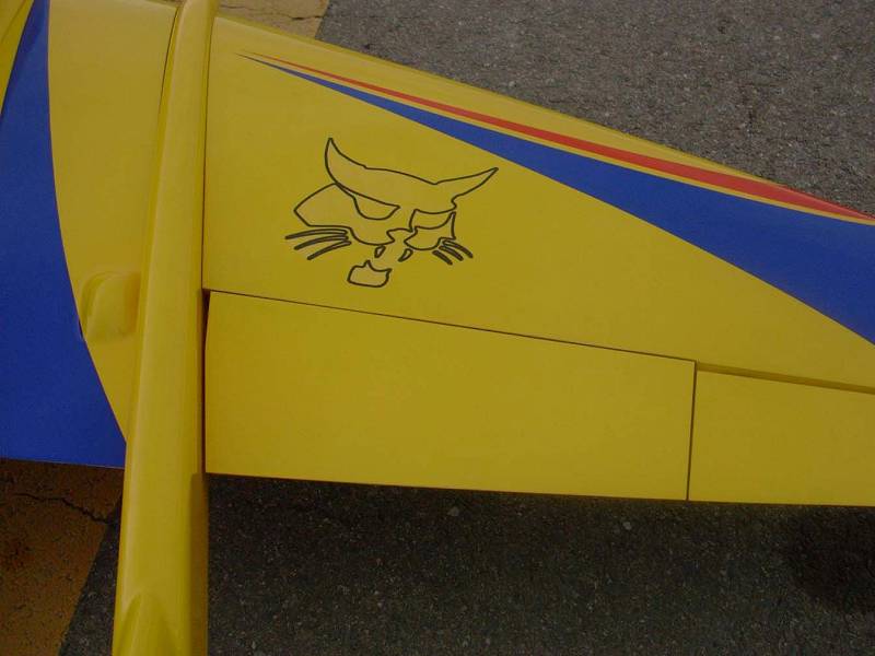

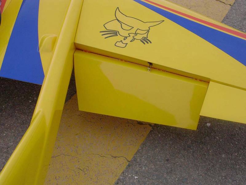

Hi AKB,
My BobCat is not the composite version, is scrath build from BVM plans and I built the flaps version.
You can see in my pics there is not gap betwen the root and the boom, you only must sand the root flap a little.
BR
Jesus

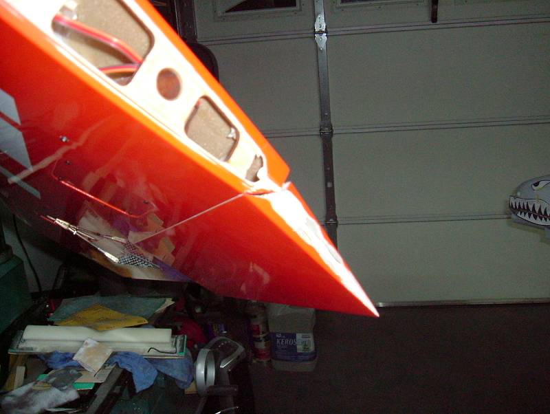

Default RE: Composite Bobcat
I had the same problem too. Basicly sanded down the inside of the flap at the same angle of the boom. There is plenty of areopoxy in that area so you shouldn,t burn through. About 40 flights so far and don't see any concerns. Hope this helps.
