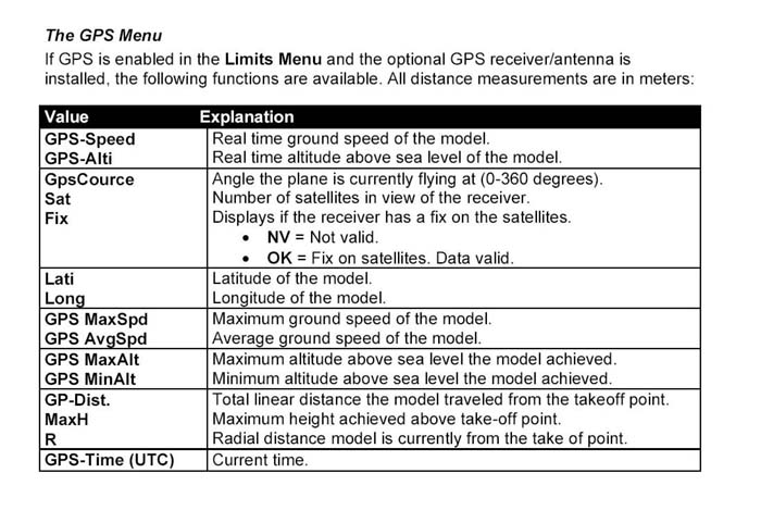

As for the electronics, I mount them close to the pitot probe and then run a normal servo extension back to the ECU.
Of course with the new GPS unit you don't have to do any of this. And with a wireless modem you can read the speed with the handheld unit while in the air!

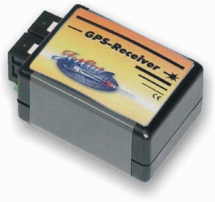

Default JetCat Pitot probe on a Bobcat
tell me more about this new gps unit..
is it jetcat mfg.?
how much added weight on board?
seperate battery?
Old 12-01-2002 | 03:30 AM
mr_matt's Avatar
My Feedback: (10)
Posts: 10,450
Received 13 Likes on 11 Posts
From: Oak Park, CA,
Default GPS
Yes it is made by JetCAT, it plugs into an existing 4.0 ECU. No extra batteries.
I am not sure of the weight, I will have to find out.
Here are the menus:

Default The unit
Looks like this:
(to give you an idea of the size, those are the normal I/O board connectors at the top of the picture)

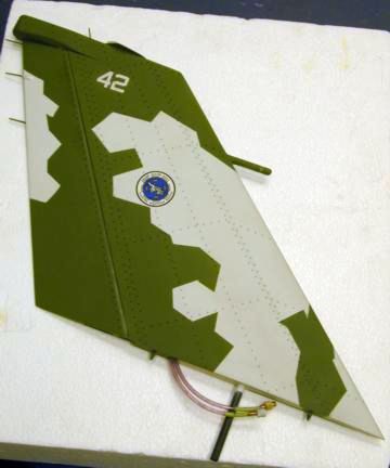

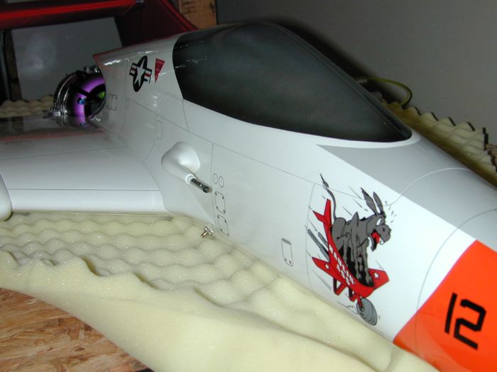

I have mounted the speed sensor several ways; in the nose, in the fin and on the side of the fuse in a mount. My least favorite is the nose. Everytime that you go off-road or when your NG fails to lock in the down position you will knock the speed sensor off if it is mounted on the nose. Of course, this shouldn't be an issue if you never have those problems. I'm not that lucky.
I really like the speed sensor mount that I purchased from Tad at Golden West Models for my BobCat. I have attached a picture of the mount on my BobCat. I will also include a photo of the speedsensor mounted in the vertical fin of my F-16. Both the vertical fin and the fuse mount are excellent solutions.

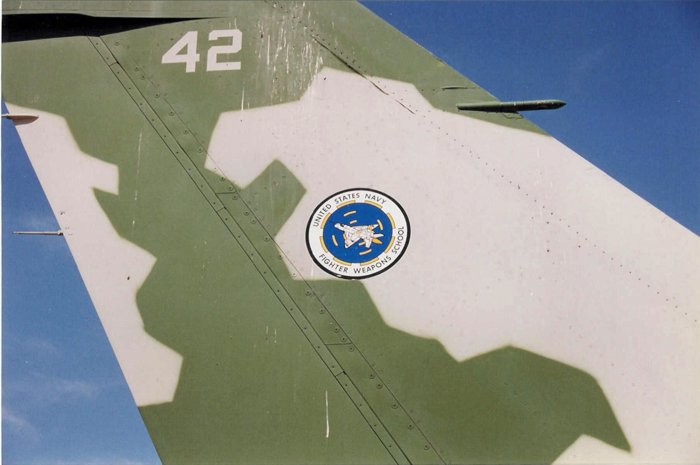

Here is a photo of the speed sensor mounted in the vertical fin of my F-16. This worked out great because the full scale F-16 has a probe of this approximate scale mounted in the fin at this location anyway.

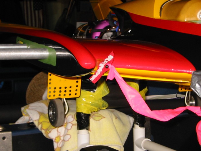

Default A good Pitot location
Here's a Pic of where I have my pitot is located. You can see the tip of the pitot tube under the Remove cover------------
Lee H. DeMary
AMA 36099
PS can be retrofitted in about one hours time in this location!

I liked the nose set up just because I thought it looked right. Making it movable makes life nice and easy. Mine didn't always ready correctly, but as time went on it ended up I had an ECU that had some minor issues. A new ECU and that was that.
Now for my good friend Gordon, I hate to break the bad news to you buddy, but on the real F-16's that probe is the inflight refueling light. The pitot tube is in the nose of the radome. But I promise not to tell the judges. <VBG>

Good to also hear from you John! You are absolutely correct about the refueling light. FWIW, I didn't say that it was an air speed probe. I just called it a probe. It could be any kinda probe. . . . . It could even be a dildo or a proctoscope. Nevertheless, a probe is a probe. URGE... In and out.... You know what I mean....
However, since you brought it up, I posted a scale photo of the subject's vertical fin. So what if the probe is used as a light post instead of a speedometer. From an appearance standpoint it ain't far off....
Gordon
