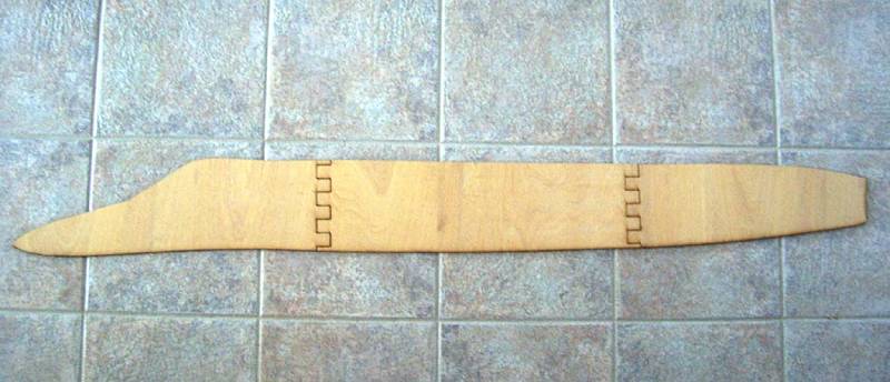

The plan is to have it rtf weight around 14lbs.
And here are the formers.
Any tips or pointers on foam and shaping?
Im all ears.

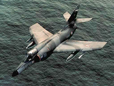

Hi Ronnie,
could you explain to me this elevator/ stab mechanism ?
Looks like the stab moves with a regular elevator [sm=spinnyeyes.gif] !!!!!
Old 02-24-2006 | 03:33 AM
Gazzer's Avatar
Joined: Apr 2004
Posts: 988
From: Southam, UNITED KINGDOM
Default RE: Super Etendard
Wonder if its for extra control subsonically. As I understand it supersonic requires an all flying tailplane due to the shockwave of air at that speed rendering eleveator flap control pretty useless. Looking at that picture it seems its using elevons but it might be the angle of the picture, I could not spot an aileron. Perhaps therefore its for extra control at take off and landing speeds?

So far yes the tailplane has been a mystery to me.
I have seen pictures with the whole stab in full up and others just the rear portion.
I'm not 100% sure yet.
For simplicity I was just going to create elevators instead of a full flying stab.
It seems from what I have seen that the stab gets a little deflection and full up elevators for takeoff.
Flys on full stab and lands with full stab and elevators.

I found a bit about this on a flight sim creation.
Can't vouch for its accuracy but you know what the sim types are like. It suggests that this is a trim for when flaps are deployed and alter the pitch of the aircract, the "elevators" are automatically deployed to compensate for the attitude of the aircraft. Hey hey clearly "Bad attitude"
It makes sense, but I cant vouch for its accuracy, so would be worth finding out incase the elevators are not powerful enough Ronnie. I notice there are a lot of other bits on the tail section......

The A-4 Skyhawk has a similar setup. The A-4 stab is used to trim while the elevator is used for control. The big difference between the two designs is the A-4 is subsonic and the Super-E is supersonic.
I have a friend who flew the Super-E for the Argentine navy. I'll e-mail him the question and pass along his reply. This may take a few days.

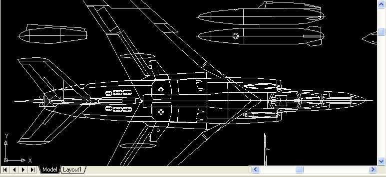

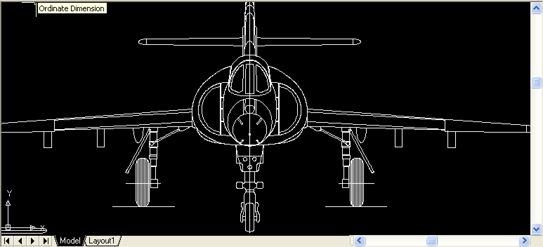

Yes the Super Etendard is a nice plane. I did a bit of CAD work on this plane but had to stop until I got to know how to make the airfoils to cater for the mid-wing saw tooth. Also I noticed that the wings had a drooped leading edge which should not be a problem making it on Compufoil. I reckon that the elevator stab has to be an all-moving type.
Anyway, I hope to get back to it when I have a bit more free time.
Reuben

Here is the correct answer:
The Super Etendard has a full flying stab and the two small elevator flap go up when the wing flaps go down to compensate for the induced pitch down
so simple!

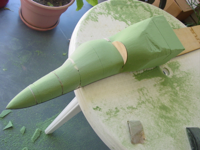

taking a breaking from the sanding, thought I would snap a few quick pics.
what do you think?
Starting to look like something

Nice! What is that - florist foam?
Old 02-26-2006 | 07:29 PM
Shok's Avatar
My Feedback: (28)
Joined: Apr 2003
Posts: 3,886
From: Heath, TX
yeah its great stuff, super easy to carve and sand.
plus it's on sale at Micheals! lol

I saw the stuff at Michael's and thought the same thing....perfect for making plugs! What did you use to glue the pieces together that sands easily?

i just some elmurs wood glue, just a tiny bit to stick the parts together before sanding.
I'm about have way down one side of the fuse now.
Made a few new formers with standoffs to position the wing root location.
