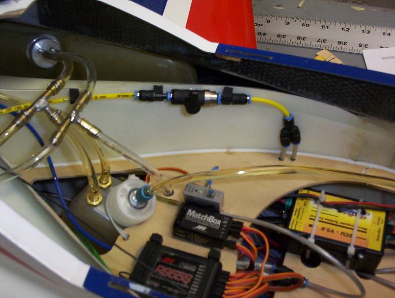

Simply install a mechanical valve, closing it before shutting off the radio............

Ron...............good suggestion, I'll remember that one for my F5 where I'll have access to the full air system in the nose. Unfortunately, the current model has the whole system apart from filler valve & pressure guage housed in the wing centre section, so it's totally unaccessible...............re-plumbing to fit a mechanical shut off valve thats accessible via the front hatch would be a right pain in the A**E !!

Maybe splice into the "down" side of the system to hold pressure. It would only take the addition of a length of airline and a valve to a location in the canopy area. It appears you must remove the wing for transport, so accessability should be no problem.......
