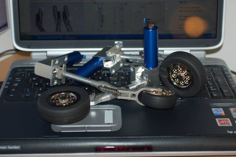

mm dont now what you did , but they fit as they are delivered witout altering anything....
on the pictures you can see our new optional "de luxe" front oleo with a very light spring.
on the other picture there is also a new frontwheel.
as you can see it has a small upwards setting making very short take off possible.
fits right out of the box...

you have altered the pins to be shorter
i just noticed on the pciture there
you need to leave the pins to their lenght , if you make a very bad landing they will bend also . leaving the fuselage intact.
infact the eurokit bend allready just looking at them.........
Joined: Nov 2005
Posts: 945
From: , UNITED KINGDOM
Sandor ...i left the pins exactly the same length as when you sent them ... very nice pins they are too...
... with flats on ..but i made a spacer to go over the pins the same dia as the top of the Oleo ... BUT the middle section of the spacer has 2mm clearence round the pin so the pin can bend.. the middle outer wall section of the spacer is quite thin..
Dave.
