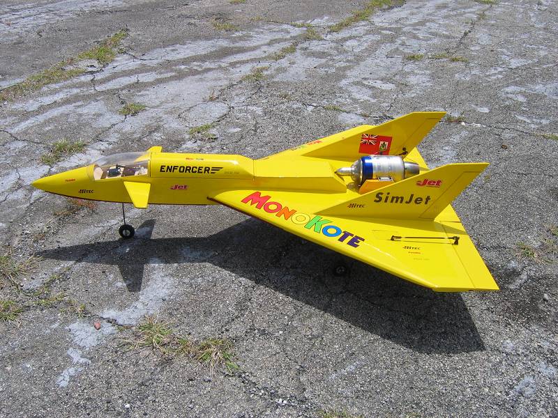

Just a few pics of my nice great flying cheap jet

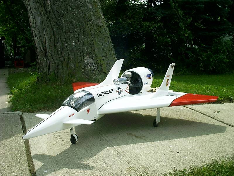

Looks great. It would be hard to find a better flying turbine platform at any price. What engine is on yours?
I liked the flight characteristics of my DF Enforcer so well that I decided to build another for my first turbine. I logged 113 flights on the DF Enforcer, but don't fly it much any more since finishing the Turbine Enforcer. I'm up to 116 flights on it since finishing it a year ago.
Joe

Joe, I got most of my ideas from your Turbine Enforcer post. I have a Simjet 2300 turned down to about 20lbs, a 50oz fuel tank gives me 5 1/2 mins of flying time plus extra to land. Vertical is ballistic, this thing will climb out of site. Weight is just under 15lbs with UAT full. With canards I can do some very nice slow flying and landings are a breeze. (my Viper Jet is in early retirement)
Slick, your right about building, it took me a little over a month to build. I am also an ARFer.

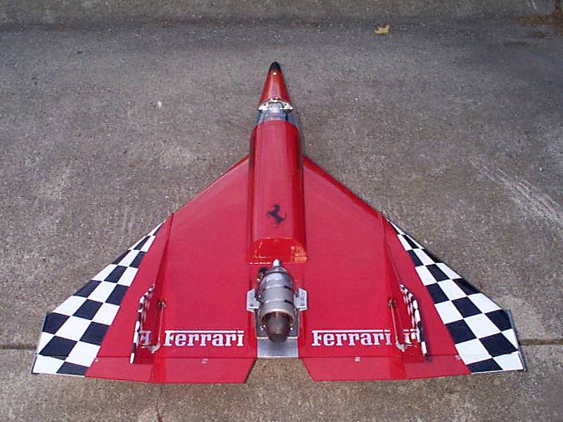

Hi Joe
Here is several pic's of my delta wing enforcer

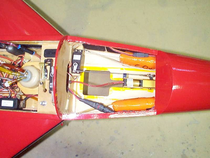

here ya go
ID:	562936   Click image for larger version
ID:	562937   Click image for larger version
ID:	562938   Click image for larger version
ID:	562939   Click image for larger version
ID:	562940   Click image for larger version
ID:	562941   Click image for larger version
Old 11-19-2006 | 09:20 AM
Joined: Mar 2003
Posts: 4,575
From: New York, NY
Default RE: Turbine Enforcer with Canards
Thank you WideOpen [sm=thumbup.gif]
That Rx batt look so small [X(] .. but maybe you dont use digital servos
and what is the brand of your fuel tank ? Just looks like a drop in, nice fit [8D] It may helkp for future reference
and also, where did you get the Canards axles / nylon mounting / bearings setup ?
thx
Old 11-19-2006 | 10:13 AM
Joined: Feb 2003
Posts: 43
From: Warwick, BERMUDA
The Rx battery is a Hobbico Hydrimax 6.0V 2000 mAh
2 Hitec 5645 digital servo for elevons
2 Hitec 5125 digital servo for rudder
1 Hitec 5245 digital for canard
1 standard servo for steering
2 mini servos for retracts/brakes
Fuel tank is 50oz. Dubro
5/32" wire used to make canard / steering arms / nosegear bearing and collars all to make up canards. All of the above came from Towerhobbies.
