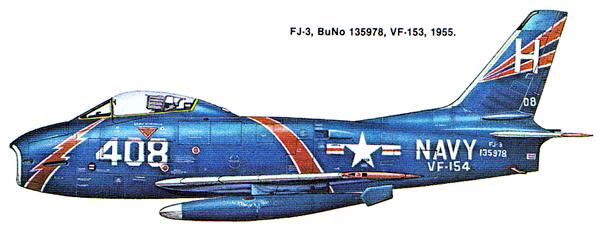

Hi Tiger, the 46VX is going into a Jet Hangar FJ-3 Fury/F86 but I am building the Naval version. It will have flaps and speed brakes along with the normal functions. I already have everything for the plane but some servos and the front nose strut. I have the main gear oleos and even the drop tanks for it but they will be for show. My second plane will the JHH Phantom with the Dynamax and OS 91. Which I just bought and it will have the scale landing gear struts and wheels.
I just started my turbine fund. I am putting away a certain amount of money each month for a turbine and plane and I plan to fly these two planes for 2 years and get my waiver and turbine and scale plane for it.
Thats my plan anyway
