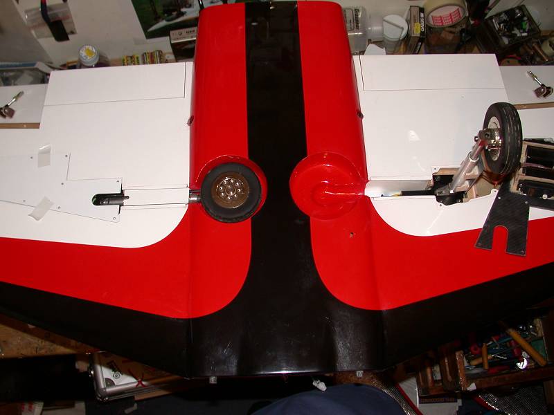

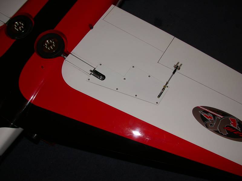

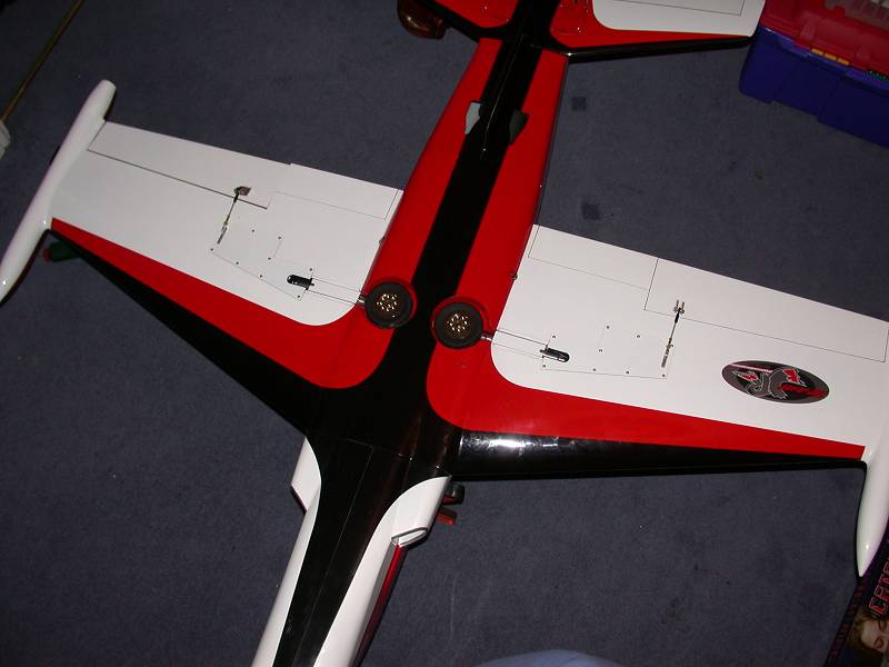

RE: Comp ARF Flash update
Joe etc
Here are a couple of bottom shots.
The wooden blocks are a little crude, but I think they will work well.
If they are stuck in place with silicon they can flex slightly. The gear and legs are solid so I'm sure everything will stay in line.
Regards
Dave
Regards
Dave
Beautiful pictures Dave! Thank you! I ordered an all white flash yesterday and will be fitting robart 630 retracts but not sure about struts. Do you know the lenght of the struts?
Joe
Joe
Joe
I think you are making a mistake! I like Robart gear, but this Comp ARF system is more robust!
I can measure the legs, but the height above the pivot and distance/unit length will change that.
The factory units are quite compact.
Enjoy the model
Regards
Dave
