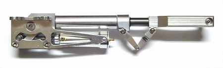

I'm thinking about buying a retract-ready Bobcat 50, to be fitted with a set of Hobbico Mechanical Retracts, and powered by an .80 4-stroke or a .75 2-stroke. Comments welcome.
Also (and the real reason for my post) I need to know the size and weight of the unit as shipped. It's going overseas, so this information is critical. Can anyone help?
#2838
You want a set of air retracts.
You would have a hard time putting in the servos for the mechanical retracts.
Then the gear on those retracts is not very strong, so it will tend to bend or break.
I don't remember what the shipping weight was on the package though.

Also have anyone tried the retract by AirPower. Here is the link http://www.airpowernet.com/twe/produ...roducts_id=693
There are 30 dollars more than the Robart 520w1. I would perfer the robarts, but they have been on backorder with tower for months.
