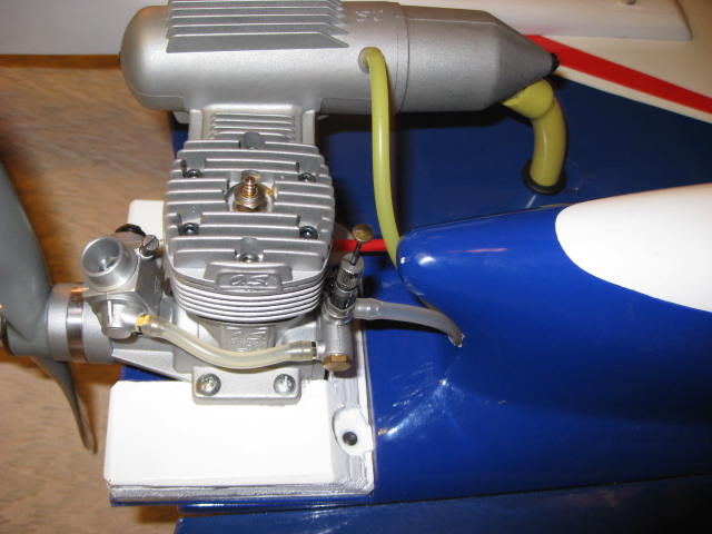

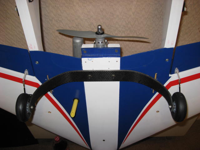

11oz lead in the nose to balance her?? AUW 9.25 lbs EEK!!!!! (err..how much does everyone else's weigh?? )
Got an OS 61 fx in it and have a Carbon Copy carbon fibre u/c... gonna be flying Lurleen Lumpkin sooooon....
Anyone else got a heavyweight kitty??

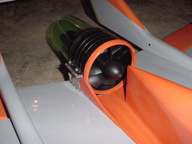

I have one these setup for EDF, I have not flown it yet. I modified the back of the fuse to improve airflow to the fan. It is a Hoaye 4" fan with a Hacker outrunner running on 10s. turns the fan at 26,000 at 2300 watts. No retracts and it weighs 7 lbs 10 oz. If it flys well I will consider retracts. I did change the gear, it is lighter and much less drag than stock.[image

My bobcat weight is 7 lbs. 12 oz. and it has retracts. I would suggest taking the 11 oz. of lead out and moving the battery up front. try to stay under 8 lbs and you will love how she flies.

Sounds a little odd. Mine has 3/16 wire fixed gear, O.S. 55AX with stock muffler, 5-cell battery just behind the nose gear former. AUW is 7 lbs. 3 oz . Even with the 61FX you shouldn't be that heavy. The 61FX is about 5 oz. heavier than the 55AX which should translate to just a couple of ounces of lead all the way in the nose. Not sure why you're so out of balance to need that extra 11 oz.

[img][/img][img][/img]
here's the u/c and engine is as far back as I thought possible...
.. the wheels are in the same position as the wire u/c... maybe I should move the u/c forward or just grit my teef and give it a go..

Eh, that engine looks to be as far FORWARD as possible.
Moving it further back should move the prop out behind the plane more.
Even my "stock" installation has it much further back than what you have.

Where did you purchase the FAN? Links?
Thanks!

I used a similar fixed gear and mounted the wheel CL 2" behind the CG because I was afraid it would not rotate on demand. With standard servos all around and Sub-C batteries up front the all up weight is 7 pounds 7oz.

That setup looks INCREDIBLE - Nice Work!!

here is a link to my build thread
[link]http://www.rcgroups.com/forums/showthread.php?t=669348&highlight=bobcat+50[/link]http://www.rcgroups.com/forums/showthread.php?t=669348&highlight=bobcat+50
all the info is here , you can se how much I removed from the rear section, even between the wings is 1/32 ply that is concave to match the fan. The goal was to get the fan lower with cleaner air. I have done a lot of scratch built EDF so I have some experience with this.
The plane is nice for the money but it could be so much better, the airfoil is way too thick for one and some of the parts are way too heavy (each boom weighs 10 oz) I sure I could replace them at 5 oz each saving 10 oz total
still it is a bargain at the price and we can all experiment with them
I will post a flight report and video soon
