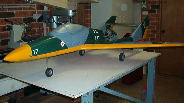

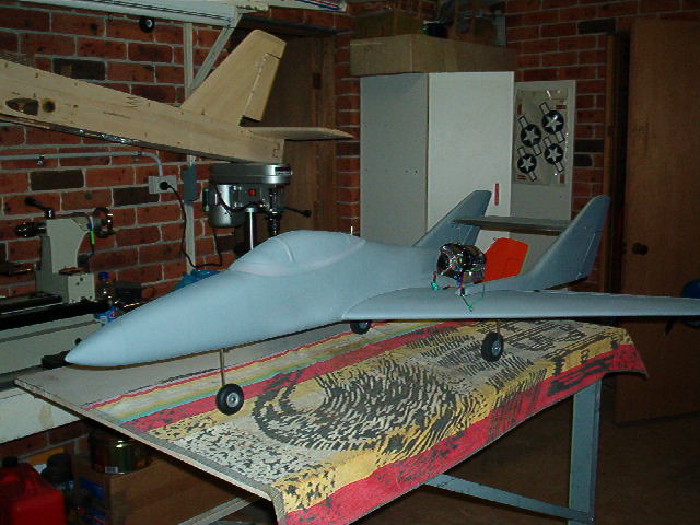

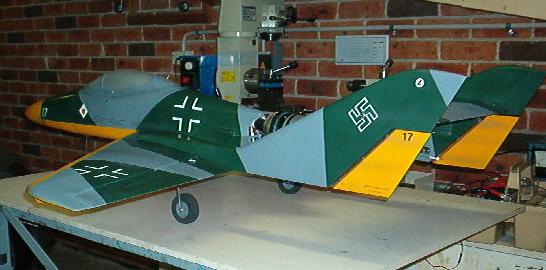

Well, my little Bobcat is finally out of the paint bay, from stealthy grey overall to German WW2 camo. - John.
