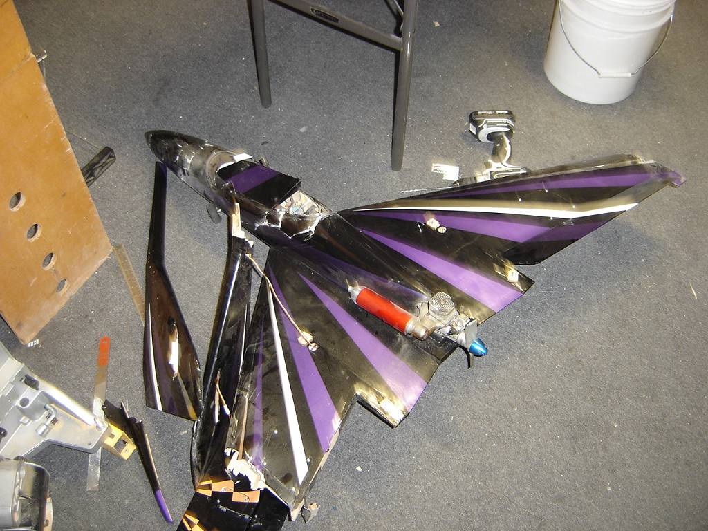

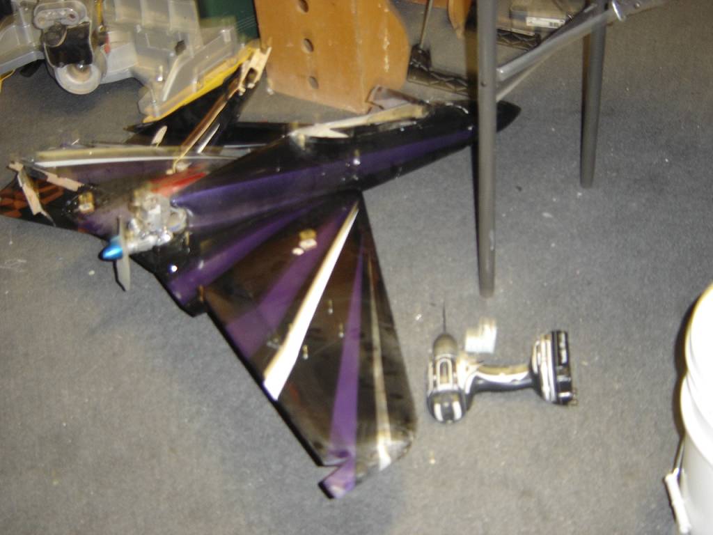

Let's have a moment of silence..................
Yup-
Mine is no more. was doing some downwind passes, LOW, and I got the "ground jumped up and bit me" feeling. As "almost better" as it made me feel, (the club sec. told me there was a visible gust that pushed me down) It was my fault by not factoring the downwind/low pass "leave a bit of room" thing into the mix. If you look at the video, you can see my immediate reaction on the sticks, but at (est) 130mph to 140mph, my reaction wasn't fast enough. Our videographer was filming me when it happened, so the impact isn't on tape... It did however make one hell of a sound! It hit square on the belly, and on impact removed the right aileron control horn off of the surface. Being top hinged, it fluttered, and the oscillation went through the entire wing. This of course is what I remember. She rolled over to the left, and I couldn't roll back over to the right, so I pushed the nose down (inverted = up) to flare or whatever I was thinking and as a result, she violently spun in. As confirmed by the video, this all happened in like 2 seconds or so. I'm sure some other things were hurt real bad from the first impact before she went in, but the control horn abrasion and removal at least explained the flutter...
Anyhow, here's the vid- I pushed her as hard as I normally do, only this time I got burnt.
http://www.cvrcclubvideos.us/SDVids/BobcatSplat.wmv

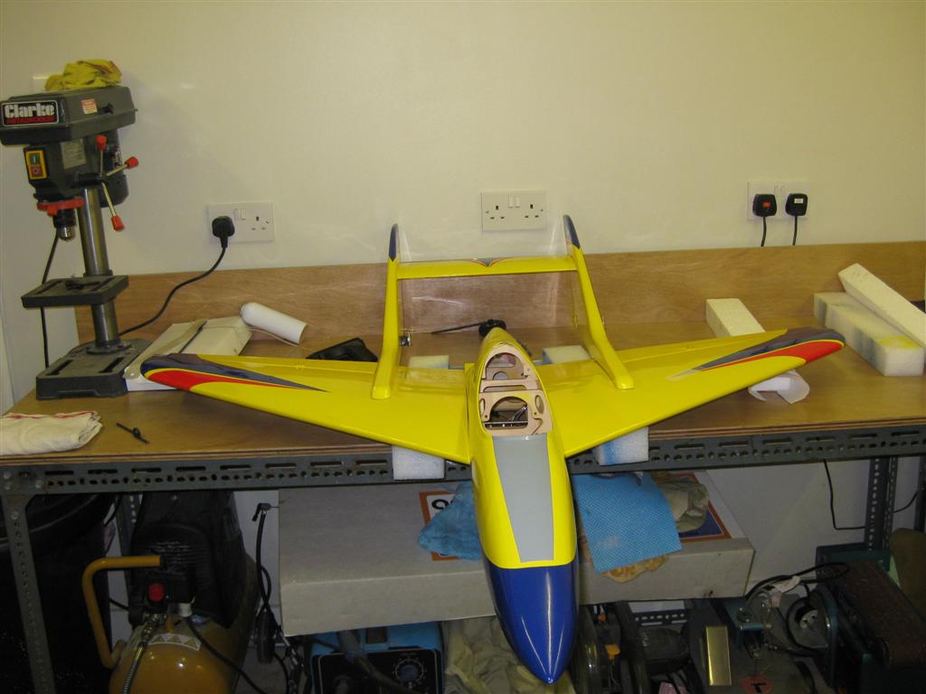

Hi Guys,
My intentions of documenting and posting the bobcat build went well out the window!! I pressed on and finished the build, got everything set-up in line with the information I have found on this very site (much of it from you Exciter!) and have had 6 great flights before a bumpy landing… this was the typical bounce followed by a higher bounce then a stalled tail then a crunch! the damage isn’t bad just some cracked fibreglass behind the nose wheel spreading to the fuz sides and finishing around the servo plate. I have got some nice carbon fibre cloth to strengthen everything internally and I will cover the cracked gel coat with a large sticker!!
While the plane is back on the bench undergoing repair I will fit a smoke system cos frankly it NEEDS IT! On this topic does anyone know where I ca get Super Dri smoke oil in the UK? Or does anyone have a home brew suggestion which is tried and tested??
I’ve posted the maiden flight vid [link=http://www.youtube.com/watch?v=MtlqvvIHTYY]here[/link] for your viewing pleasure, don’t worry the camera man has been sacked!
I have pictures of just about every stage of the build, I’m happy to share if anyone will find this useful.

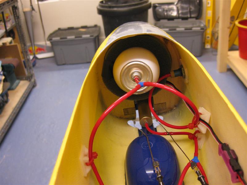

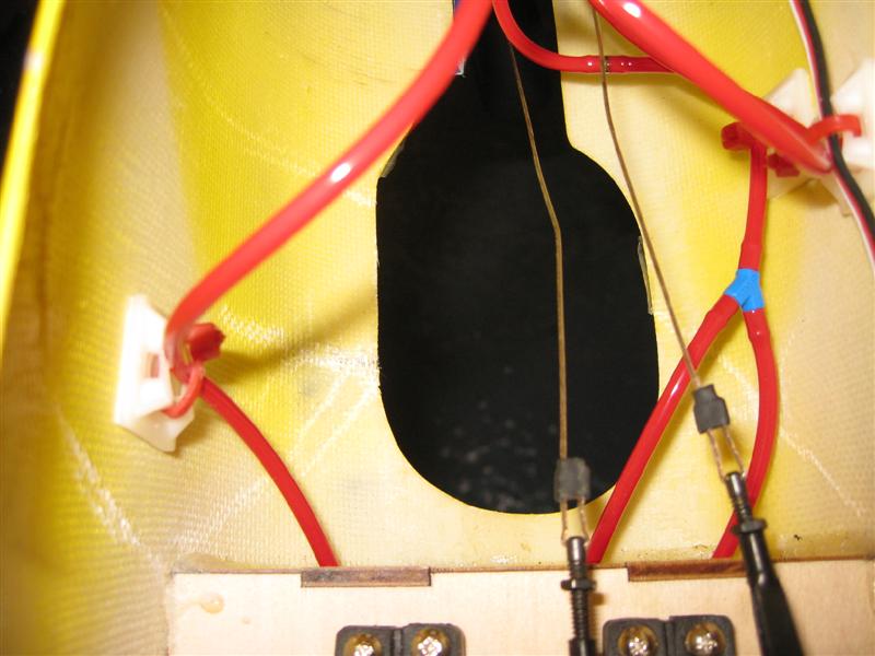

Joined: Feb 2006
Posts: 20
From: salisbury, UNITED KINGDOM
Yea I'm going to experiment a lot! I've got some of the black tubing which came with a Dubro smoke valve which I used on a college project around 15 years ago, its safe to say it did not stand the test of time!
I recon I'll drill out the Dubro valve to take the yellow Tygon tubing instead of the black tube.
I was not going to use a smoke pump...just crank-case pressure via a one way Perry valve, through the smoke valve to pressurise the tank. The smoke oil will then flow from the tank, through the smoke valve, through a remote needle, through a simple pre-heater coil around the header (insulated with fibreglass and aluminium tape) then injected through a 1.5mm hole right into the header just in front of the exhaust port where the gasses should be hottest and the pressure lowest.
This should work and as the smoke valve controls both the pressure into the tank and the flow from the tank at the same time there shouldn't be a major delay between smoke on and actually getting the smoke as the system should still be under positive pressure when the valve is closed.
I will need to make sure I don’t throttle back too much with smoke on as this will probably kill the engine due to the crank-case pressure 'leak'!
If this doesn't work I'll spend the extra £30.00 on a true Perry smoke oil pump, again running off case pressure.
I was also going to run the exhaust through a silicon pipe through the side of the fuz and down out of the bottom. This should help keep the extra muck off the tail and look cool! Before I do this I'll take some measurements with the tach to make sure I don’t lose too many revs.
I'll post some pics of progress soon (when there is some!!)
