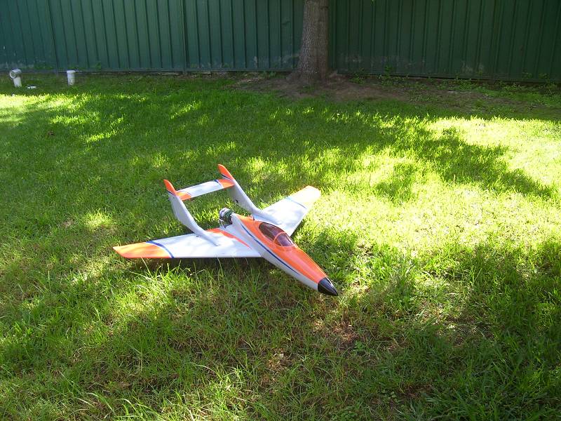

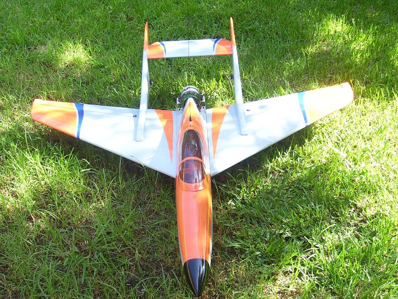

Hi Gents
My Bobcat with Wren44 power.
Regards Craig Dyer
ID:	657082   Click image for larger version

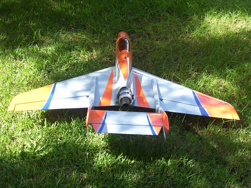

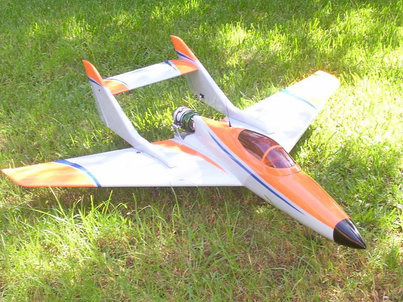

Old 04-04-2007 | 07:01 PM
  #1442
Joined: Sep 2004
Posts: 194
From: Sydneynsw, AUSTRALIA
Default RE: Nitro models pusher Bobcat?
More pics...Dry weight is 3.6kg and springair 301 retracts.
Regards Craig
ID:	657086   Click image for larger version
Old 04-04-2007 | 07:57 PM
  #1443
Joined: Oct 2005
Posts: 32
From: TUSCALOOSA, AL
ORIGINAL: craigdyer
Regards Craig
Craig,
If it would not be too much trouble, can you show us some pictures inside and out of how you installed your retracts in the nose ?
Michael
