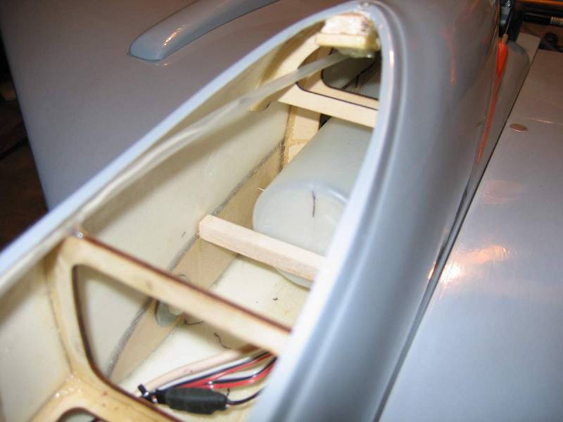

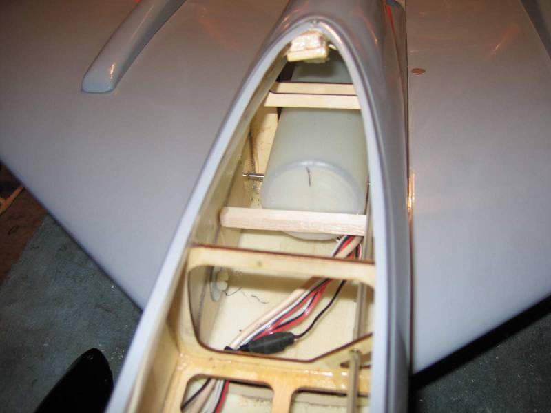

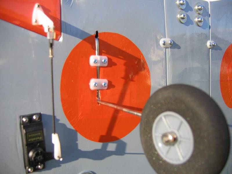

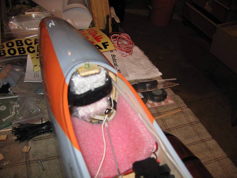

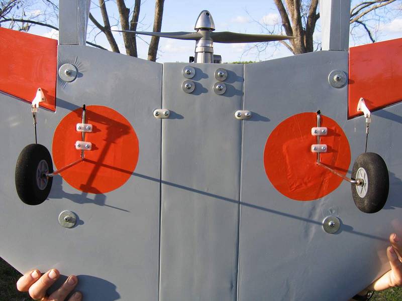

Another couple of weeks and the Jett 60 we'll be here!!!!!!
I had some request for photo's of the wing attachment and my attenna rigging, so here they are...note in the pictures it shows the tank secured with a cross support. I used a control rod tube to run the attenna the length of the fusalodge and secured it with thick CA to the support just under the lip of the canopy opening....also, the trailing edges of the wing are secured with main landing gear strap tabs...I saw this in this forum and copied it....It works great and will allow removal of the wing when needed.....Please note that I take no credit for all these great modifacations as this forum was were I got them from....It goes without saying that there are some great builders here and as this is my first time using this forum I am honerd to exchange some of you great ideas and to be able to use them......
Mark

I'm particuarly interested in how you're routing the antenna.
Aero D,
Seen your question and thought I'd offer my method. I glued a 27" length of nylon tube into the front section of one wing and threaded the stock antenna wire into the tube. There is an oval shaped hole in the ribs close to the leading edge that runs all the way down the wing. It's pretty easy to thread the tube into this area and secure the end to the inside of the root rib with a small piece of light ply leaving a short stub of the tube to protrude into the fuse when the wing is attached. The 27" length of tube is more than enough with the receiver just behind the nose gear mount.

Thanks for the input. So in your method, is any of the antenna wire exposed outside of the plane?
Chris

Aero D,
No, none of the antenna wire is outside the plane. The 27" tube runs from the root to the tip and is more than long enough for the wire.

Aero D,
I took stick jammers advise on running antenna through tube in wing.
Worked out great, and fairly quick/painless. By the way, thanks for the idea stick jammer!
You're welcome, glad it worked for ya. Did your range problems go away?
