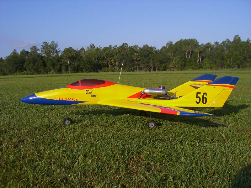

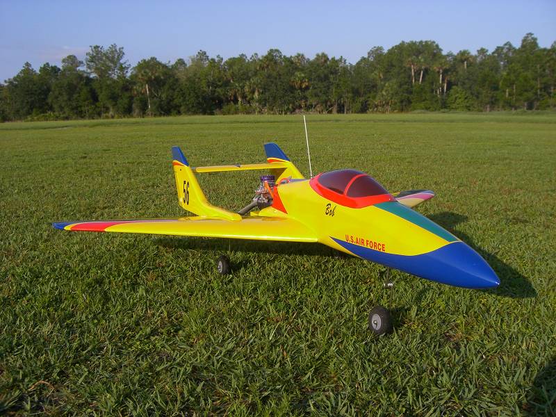

Well after destroying the original BobCat, I got a second one to try again. Will be going out in a few hours to attempt it maiden flight. Have reversed the gear and put a larger nose wheel on, as well as rerouting the exhaust. Removed the baffle from the muffler of my OS55AX. Running an APC 10X8P. I have included a couple of pix. I think the new paint scheme (except for the @#$% red canopy) looks really cool. Wish me luck. I have a good friend who is my builder and test pilot gonna take it out but after he sorts it out, I get to try my hand at it. Wish me luck
Bruce
