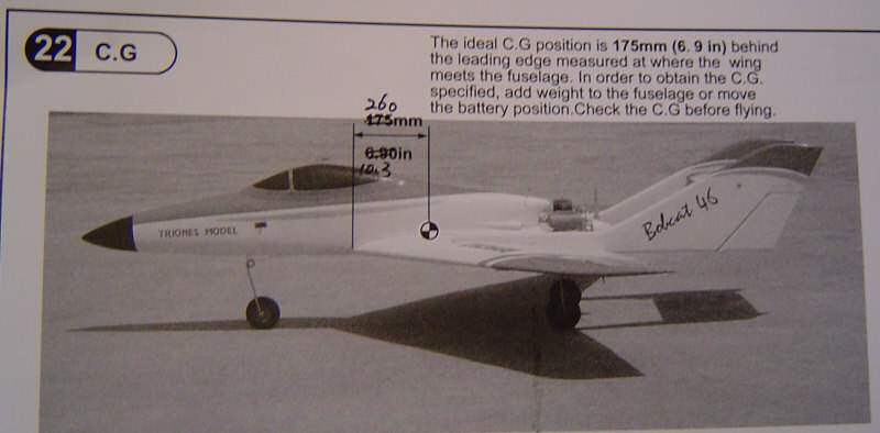

Just finished putting my bobcat 50 together and found it tail heavy. Have a Tower 61 on it. Had to hang 1 pound of lead on the nose to get close to balance. Instruction manual has CG at 175mm from leading edge. Could this be wrong or am I missing something?
Cliff

Cliff,
I balanced mine at about 10.5" from the leading edge of the wing at the fuse. If you go back through this thread,you will note that many have discovered that the balance point in the instructions was a bit off. You may have recieved a kit without the addendium.
But check back about 40 to 50 pages and you'll see what people have found.
Boy has this thread gotten long!

Yes, 10.5 inches is the measurement for CG, that's where I balanced on according to my manual.
That's 26.67 cm or 266.70 mm.
Jason
