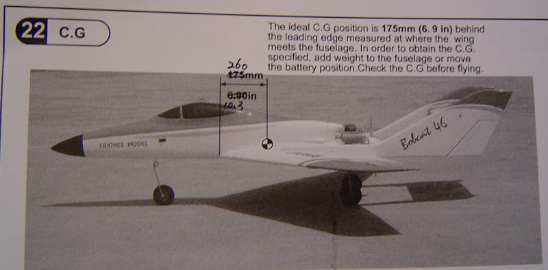

One thing Dave, Vernon had to change is CG from 9 to 9 3/4 inch. from the LE. When he came in to land with the CG at 9" the Bobcat ran out of elevator and the plane pancake into the runway. With the CG at 9 3/4 from the LE it was perfect.
The 61fx fly's the Bobcat but Vernon and i thinks that the OS 91 fx with the same weight and more power will be the perfect match for the little Bobcat, thats what i am going to put on mine's.

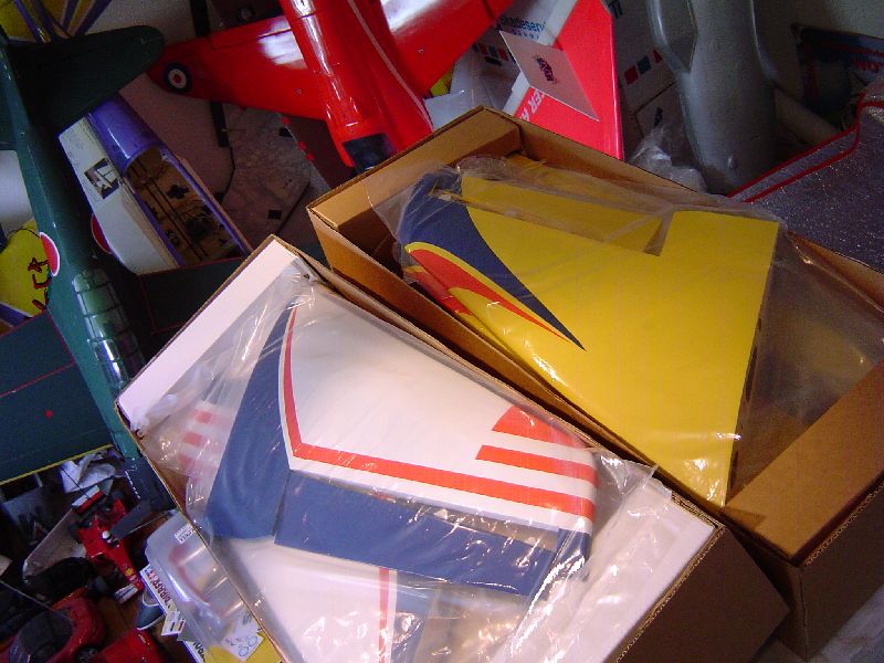

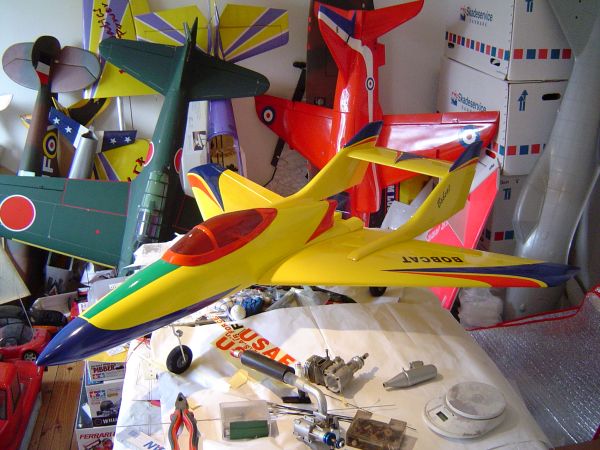

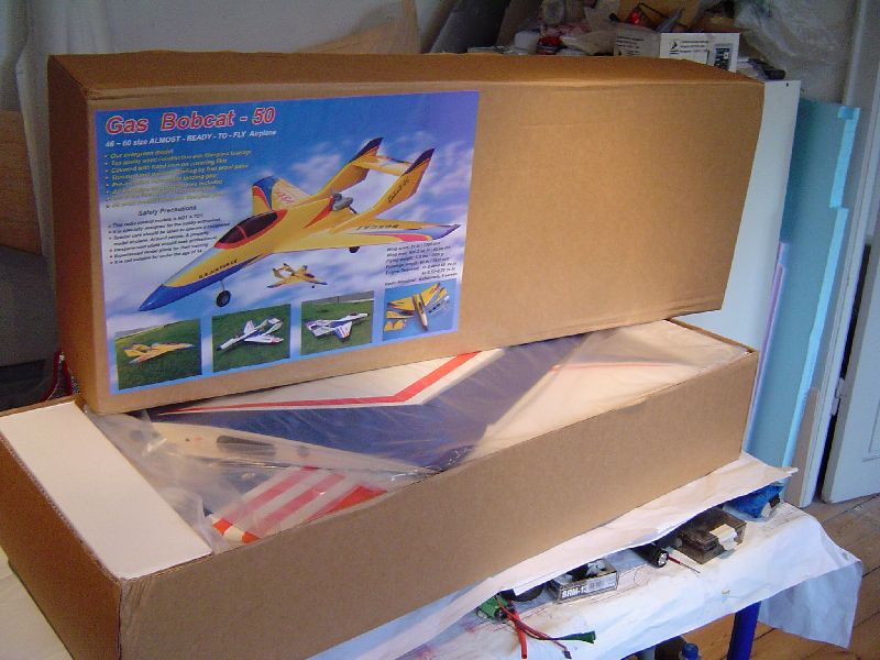

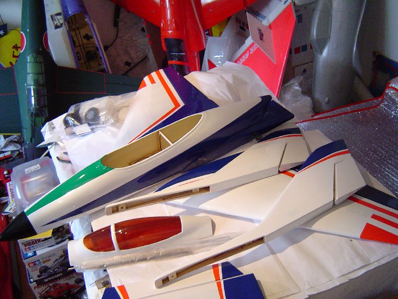

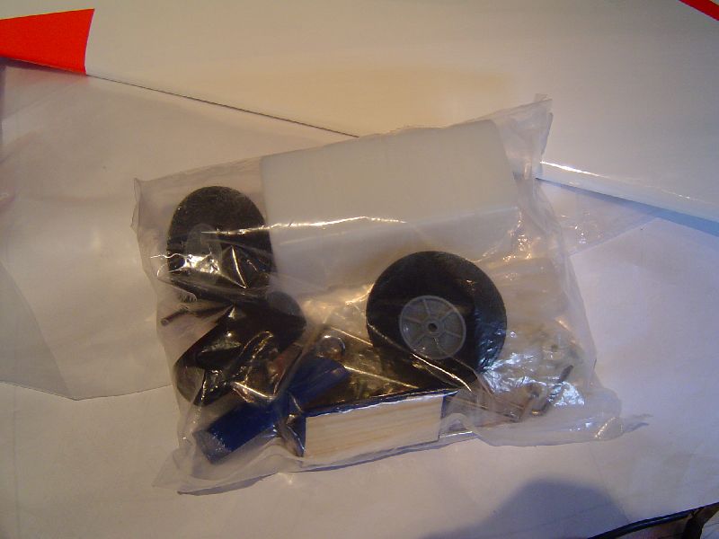

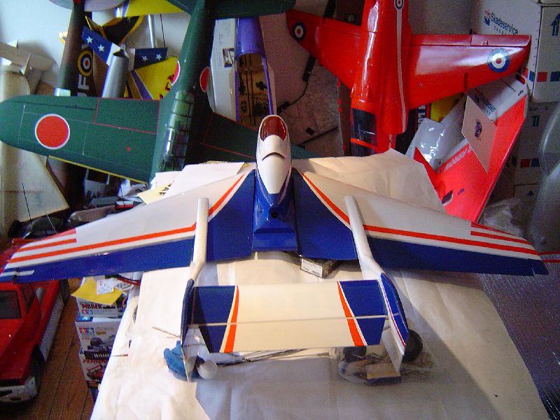

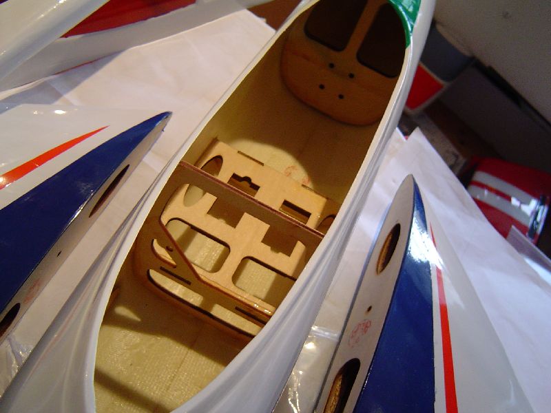

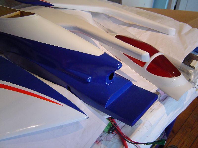

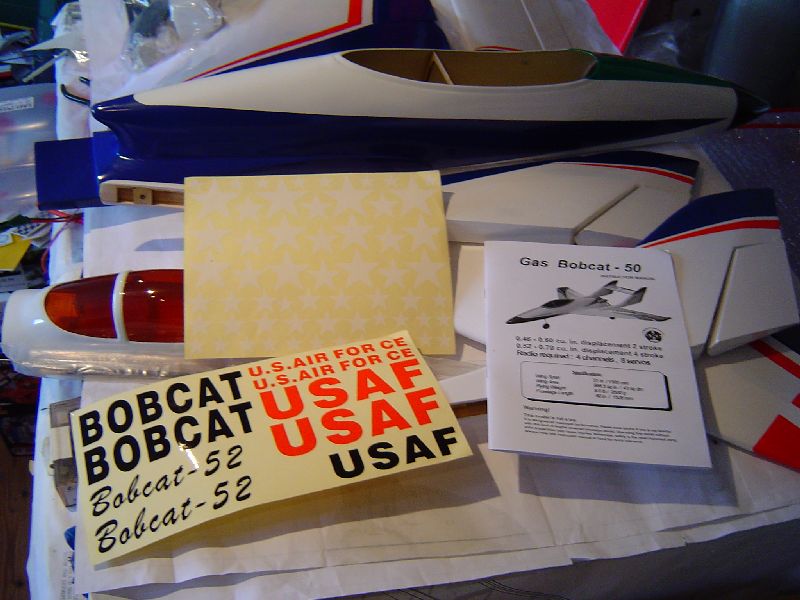

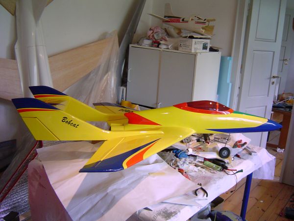

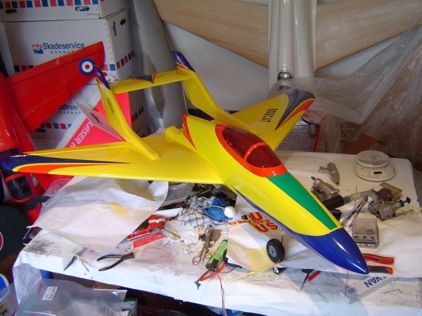

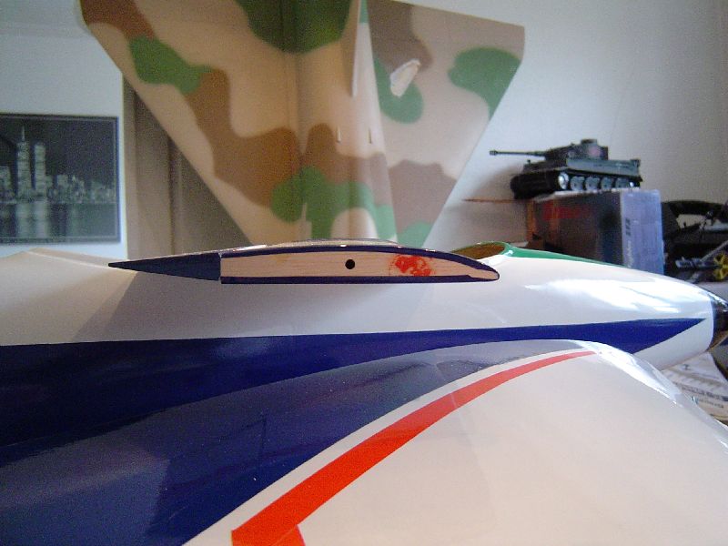

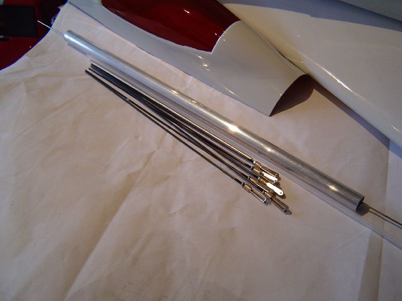

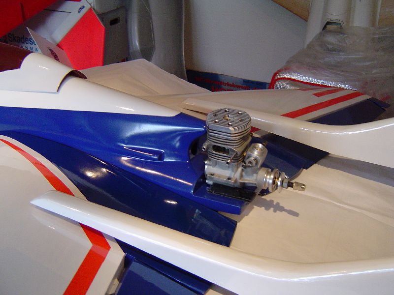

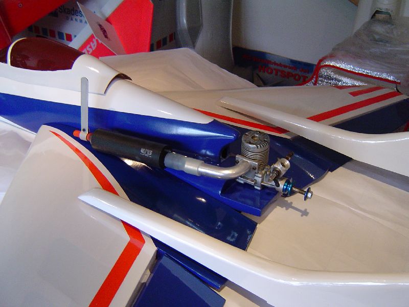

I bought 2 of these from the only shop I could find in Europe who imports them....and its only 10 minutes drive from my place
http://www.hobbyfly.com/

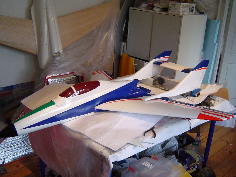

(edit) The plane is not listed in the webshop yet, but you can mail them like I did
Kits look great, and my manual has been corrected on the CG page. CG says : 10,3" or 26mm

see my CG page corrected by the manufacturer.

yea....seems to confirm the previous calculations in this thread.
