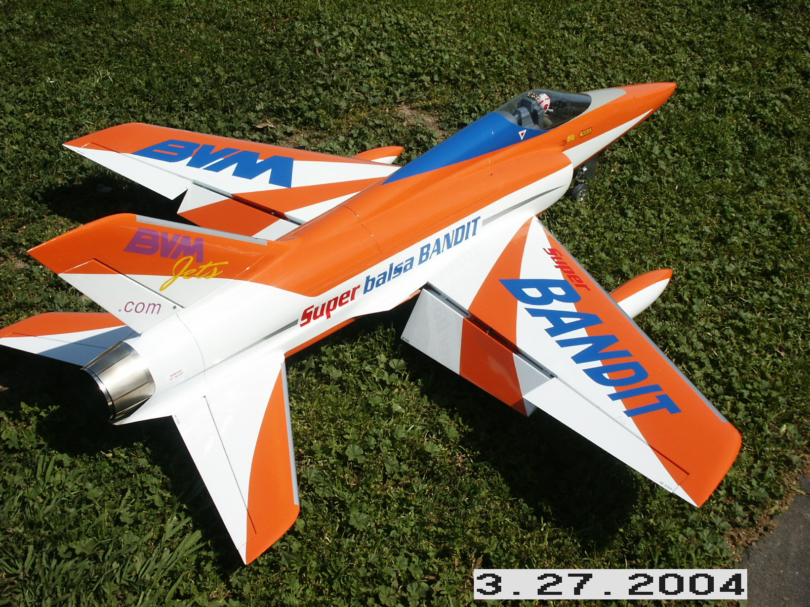

The reason you are having a problem with the fit is because the Super Bandit has a different fuselage that the original Bandit that you have. The Super Bandit has a wider fuselage, and is slightly taller, giving it more interior volume.
The two tabs on the pipe mount to the frame aft of the stab mount on the Super Bandit. See the attached photograph, and you can see how much larger the Super Bandit is over the Classic Bandit.

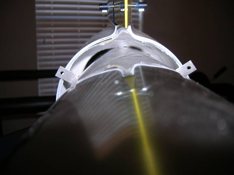

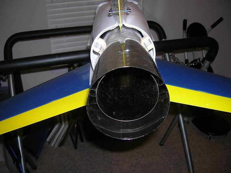

Here is a pic of what I have come up with so far...
I just put 2 basswood blocks just inside the aft lip so I can screw it much like Harly's. My next problem is that the outer pipe won't fit through the tailcone. Looks like Im going to have to trim the tailcone back by about 2" to make the hole bigger. I put a line of tape around the cone where I would have to cut it (see pic).
HARLY: Did you say to remove the aluminum retainer?? (see second pic) Also, you mentioned this would have been easier if I had the proper pipe...Do they even make a different pipe for the classic vs the super?
One last thing, with the pipe setup where it is, there is nearly 3" to the point where the outer pipe starts from the bypass...any thoughts?

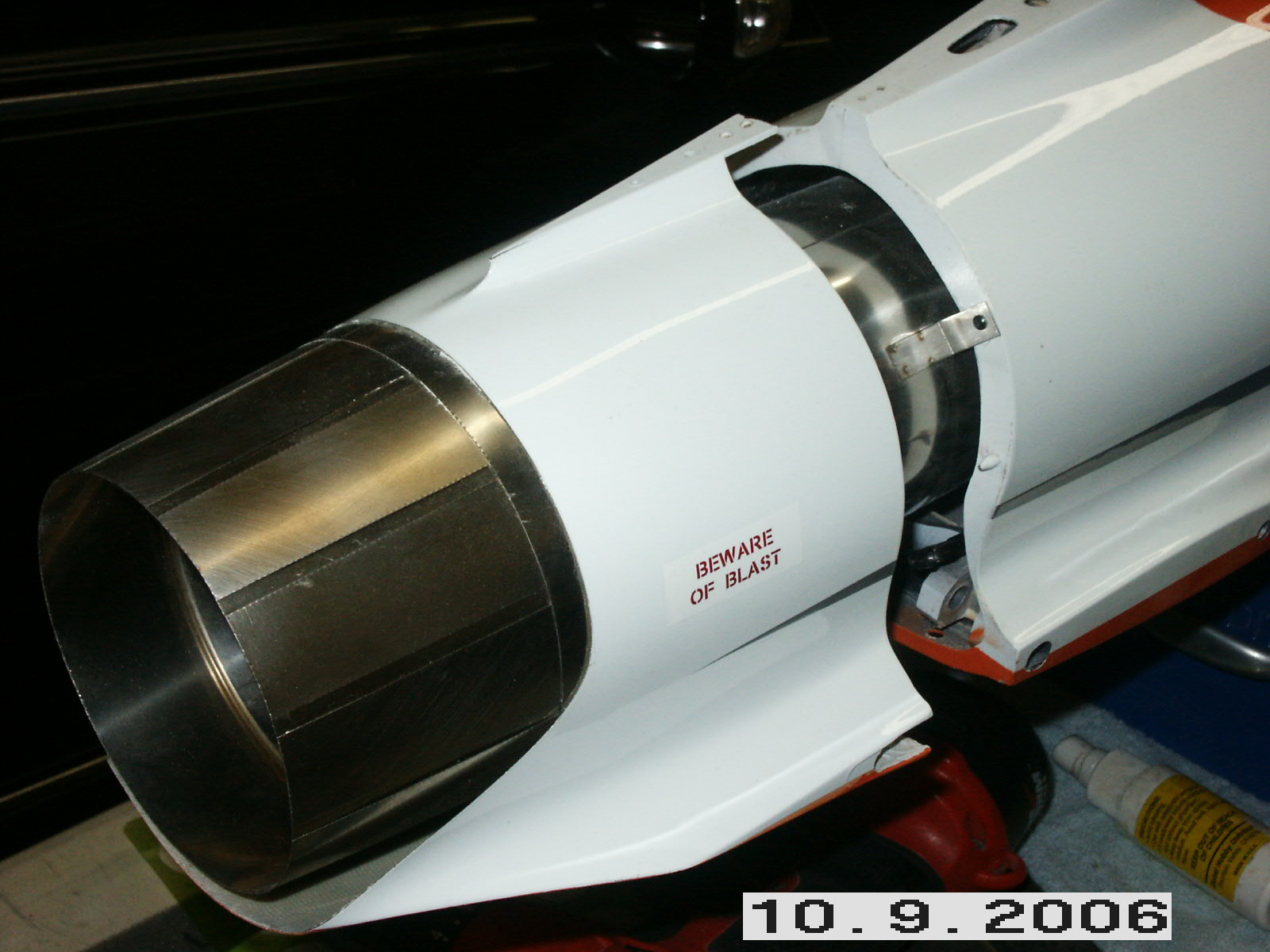

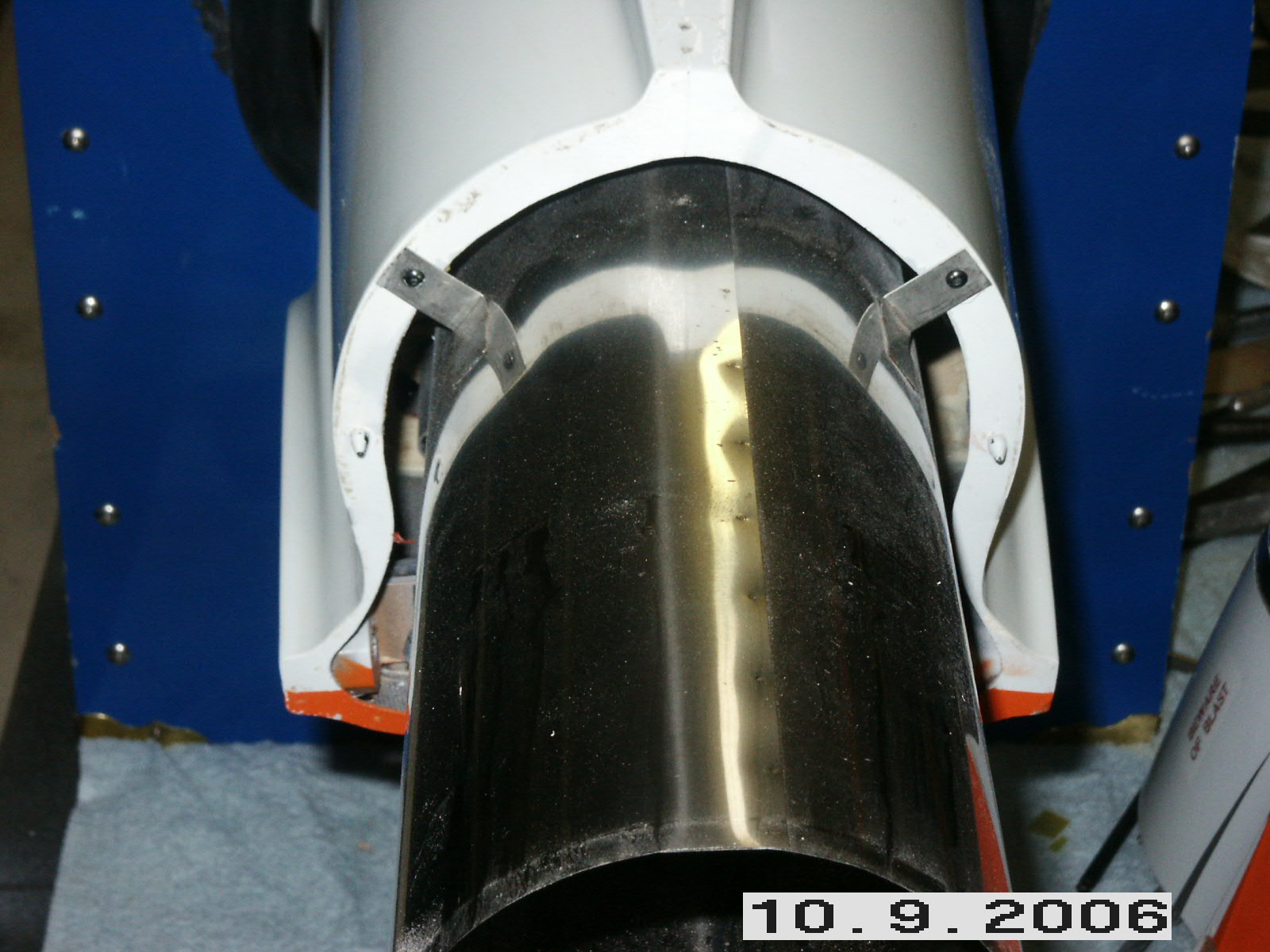

On the original Bandit, the outer pipe did not overlap the end of the inner pipe as Wojtek suggests. The dimension would be more like .700 than .250 anyway.
There was a small augmentor nozzle that fit the taper of the tailcone, and had room for about .187 around it for airflow to evacuate warm air from the fuselage from around the outside of the cooling duct (outer pipe). It extended .700 aft of the inner pipe to provide suction through the outer pipe.
The outer pipe was constructed from .003 aluminum (almost as thin as foil), inside three plywood plates that you glued to the workbench to form a construction jig.
In turn, it was screwed to the inner fuselage structure and ended up at the augmentor nozzle, which is .004 stainless steel.
What you now have, is a pipe that was designed for a larger diameter fuselage, requiring you to remove the aft end of the tailcone of your airplane, and rigging a bunch of band-aids to install it.
The Super Bandit bypass tube is the same size as the Super Bandit for the engine you are using. This means that the standard Classic Bandit exhausty pipe will work.
I just called BVM and talked to David Shulman, who has informed me that he will exchange your Super Bandit pipe for the NEW IMPROVED DOUBLE WALL Classic Bandit pipe, as long as your pipe isn't modified.
Don't modify the airplane until you talk to him....give him a call.
