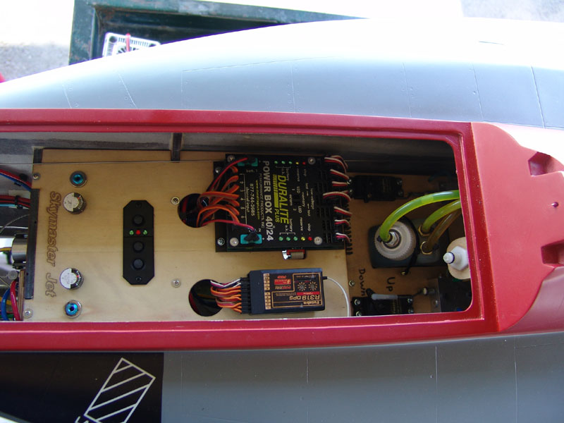

no, the batteries goes direct in the unit. The Unit switch is used to switch-on and off. (fully electronical, no mechanical part involved other than the pin, that even if he fall out, nothing happen)
you can, if wanted add a switch, but is your choice, and he is not needed. He is just a point more of failure
the photo is how i installed a RV mini in my e-sport, and in the middle you see the "switch"
to switch-on, you have to put a pin (the one with the red cap) in one hole, and this give the ON command.
Now, if you remove the pin, the unit stay ON, until you put the pin in the OFF hole..
