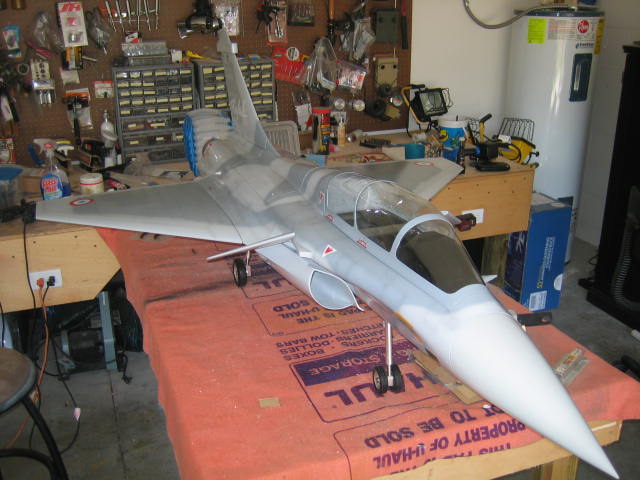

Tamjets Rafale Build
First Impressions
All I can say is this is by far the best looking ARF that I have ever seen come from any of those factories in china. All the glue joints are nice and bonded, all fillets are even. Landing gear are the best to date that I have seen from anyone, all machined… the paint job is awesome with lots of detail like hand drawled rivets, must be thousands on rivets. All the body parts fit without bind. In all at first glimps this ARF is A+++. “Now to the build Hope that’s good as the visual” I could not wait for the manual so I started putting her together.

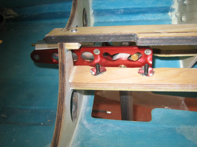

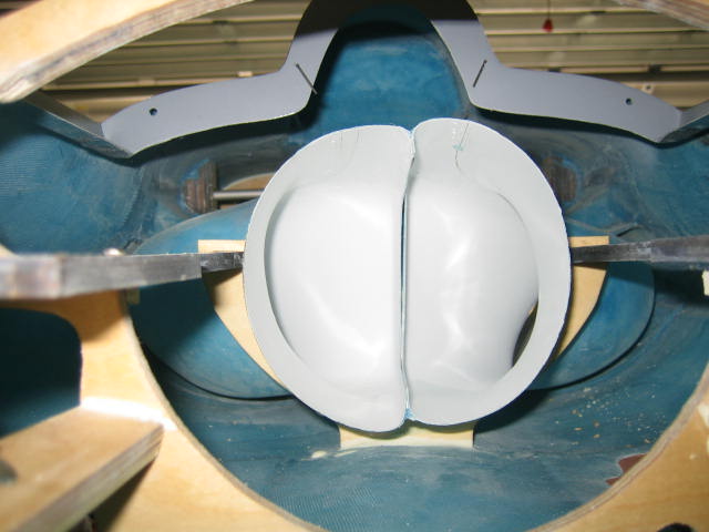

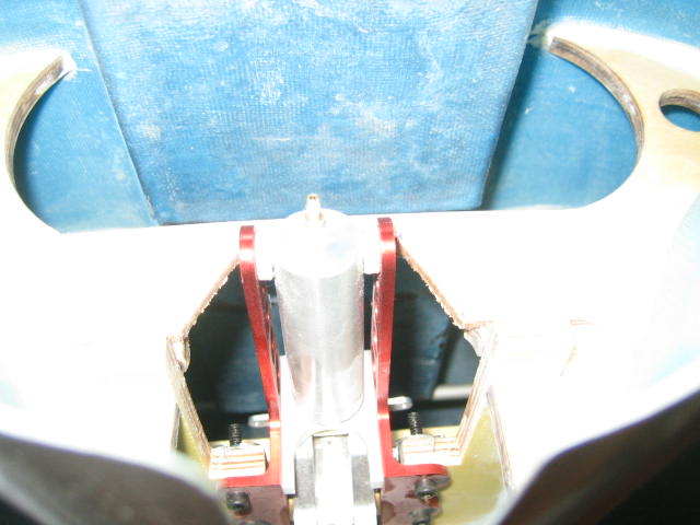

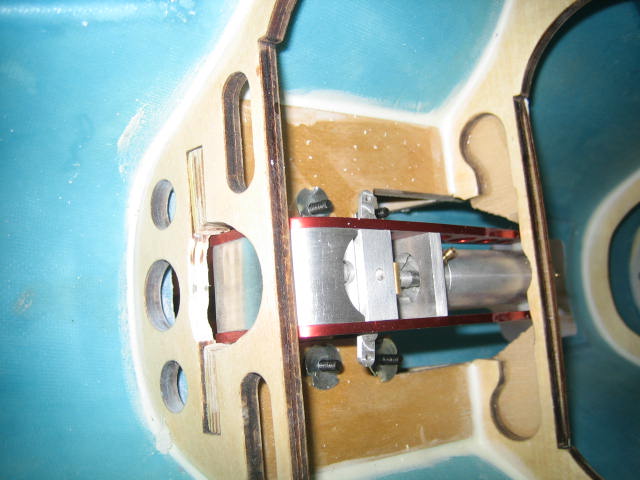

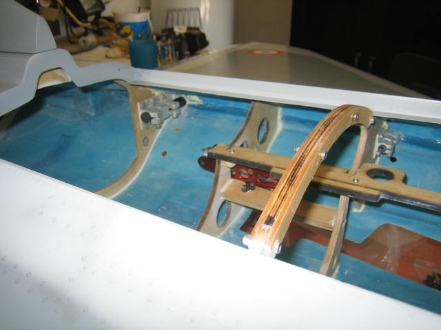

Retracts

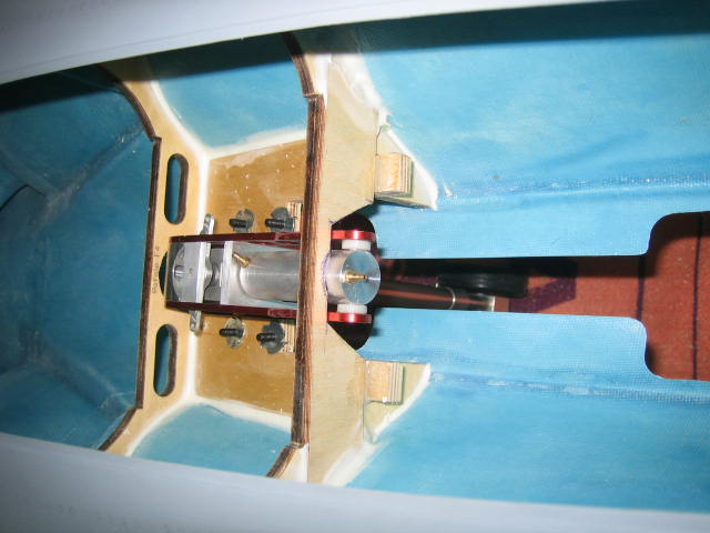

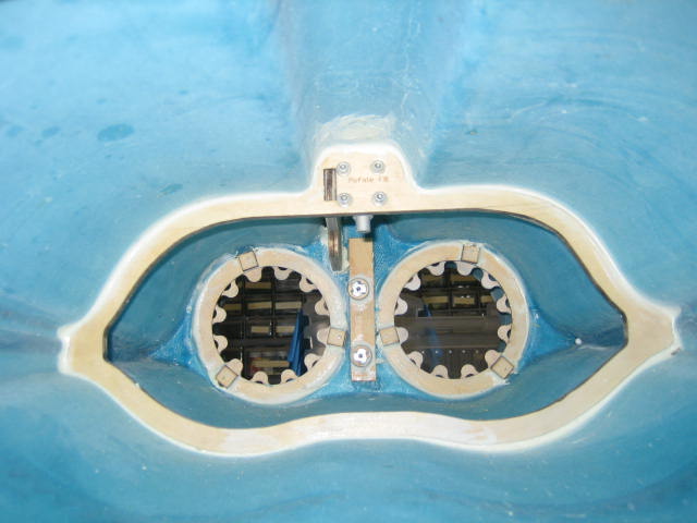

I started with the retracts since this should be a drop in and bolt processes, but this is not the case. I test fit the first main and the mounting plates were no ware wide enough to even drop in to get a bolt pattern started. This required cutting off some of the plate insides about 3mm on each side. Then I was able to drop the mains in and get a bolt pattern for final mount. After that I needed to cut out the gear door area for strut and wheel clearance.
Now on to the nose retract. As with the mains the nose retract does not just drop in either is requires about 3mm on each side as well to make it seat in. There is also a delima with a brace up in the front area that needs to be cut down for that retract to clear, and add bracing to beef it back up.
Nose install
This is straight forward, there are three hex head bolts with washers and they bolt on just as it looks.
About 2.5 hours to do all this so far
More to come

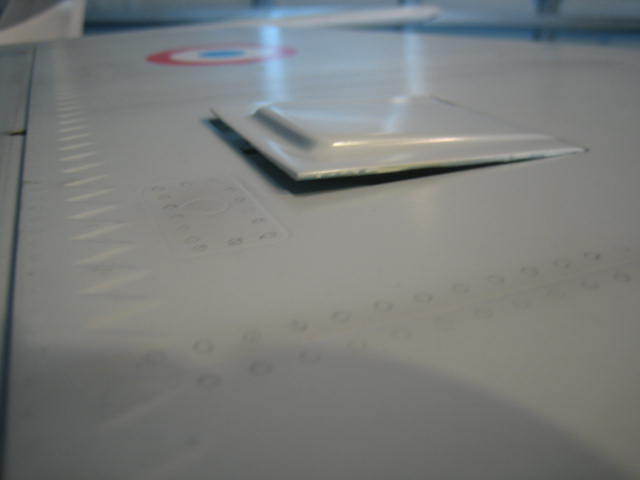

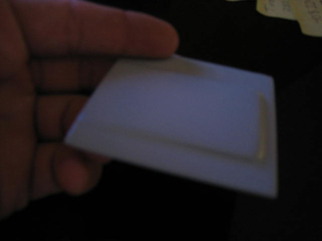

If you plan to hinges the ailervon.
Make sure to plug in the wings to check for clearing. If you push the ailervon in too close. It will bind with the fuse.
I be my office later to get some photos to show you what I mean.

Tam yea I noticed that the root edge will bind if the elevon is pushed all the way in and will only give you a minimum area of upward and downward movement in the elevon also noticed that the rocket rails will bind with the elevons if pulled to far bad too so this is a area that needs some close attention when gluing the hinges in.

Dave,
You good...
I was worry a little about it.
All this little detail tip when assemble so important. We built the third one in the shop right now. With this third kit. We able to catch more detail for the assembly and address in the instruction manual.

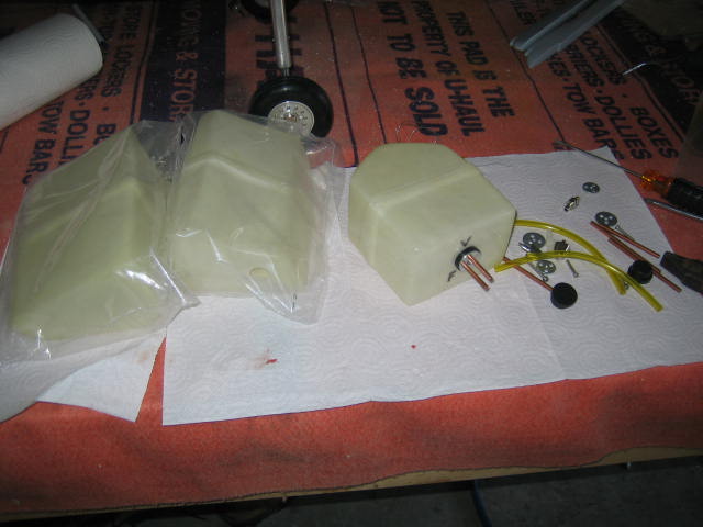

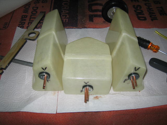

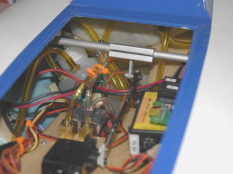

I finished with the Fuel tanks, they went together very easy with the supplyed hardware. One additional thing the builder will need to know is to blow out the tanks, there is a lot of fine dust in the tanks from manufacture drilling out the hole for for the fuel cap fitting. This can kill your bearings in your turbine so they need to be cleaned out good.

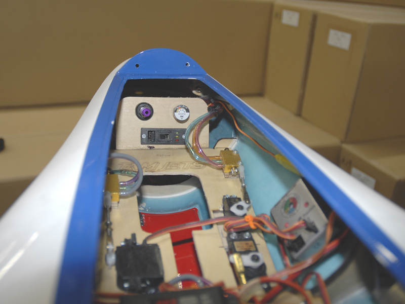

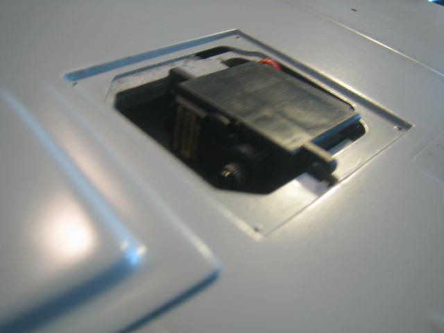

Tam, Me puedes decir que servos lleva este modelo en las alas?
Tam,You can say to me that servos this model goes in the wings?
Y el servo de direccion donde va instalado, porque no veo ninguna caja.
And the servo of direction where it is installed, because I do not see any box.

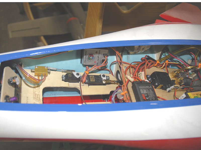

Hi Miguel
We use the Volz MicromaXX Xp on our demo rafale ( then we have a scale aspect ) because off the very thin wing. Our Rafale as now many fly without any problems . You can use DS 8411 ( 19 mm servo ) but the servo will be 7 mm outside . I think Tam use DS 8511 ?

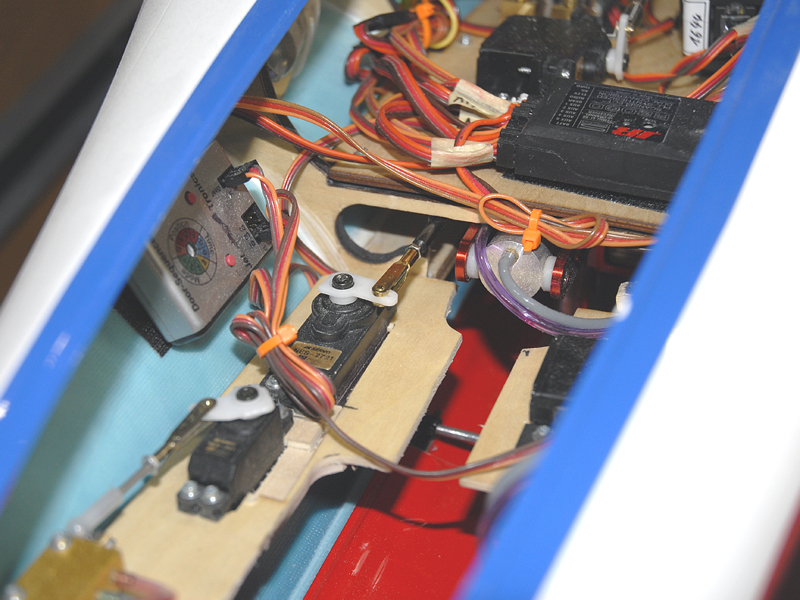

From: Lady Lake, FL

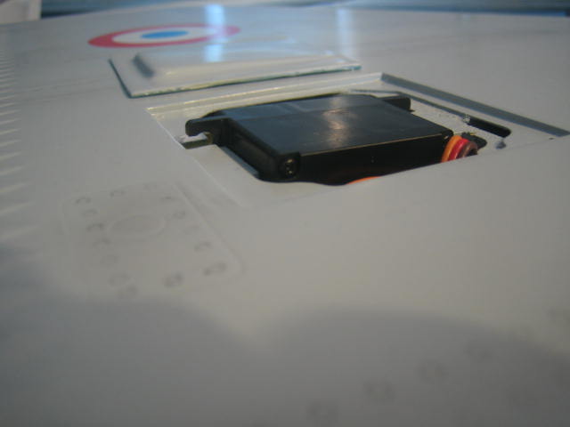

Tams Rafale has a conformal cover that looks like it will acomidate most servos. I will have to check and see if a 8611a will fit in there, because that is what I want to use. I wil use one for sure on the canards.

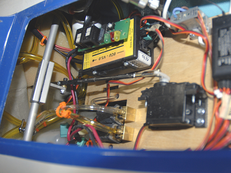

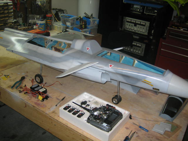

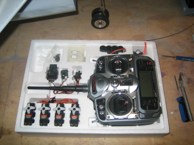

Well it's been alittle bit since I last updated here but I decided to finish of my Jet Storm, now that is completed I can restart the Rafale again.
I have got the radio that I am going to use which is the DX7. I Have pre pregramed the radio for Delta and canard mix.
1 Ali
2 Elevator
3 Turbine
4 Steering
5 Retracts UP-3 with doors
6 Canards mixed with 2
7 Rudder
Mini hobbies brake valve setup on the down elevator for brakes.
Tam question the 8611A will not fit in the wing in there perspective slots with out the conformal cover lifting "see picture" what are you doing to get them to fit looks like there needs to be a modified pocket there?

Brakes are on the down elevator which is channel 2 and it will turn off when when the retracts are up, that can be programmed by the brake valve to shut off when retracted.
