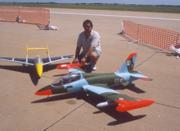

hi,
looking for an easy way to make tanks like the ones in this pic...
thanks,
V.

What are the dimensions?
I have a mold for the tip tanks and drop tanks on my Aeromacchi.
I don't remember the exact dimensions, but the tip tanks are about 3" diameter, and about 24" long, and the drop tanks are about 2" diameter and a little shorter.

no1- thanks 4 the offer but i don't want make any molds (too much work)
Kevin, 3" is too large i'm thinking 1.5 " or 2" max
I'll try the tube&cone deal most of you mentioned, since they don't have to be scale (just want to get some "scrape protection" for my BVM UViper wing-tips)
thanks for the help
