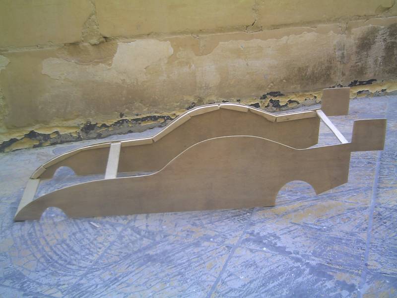

hi i am building a funny car for a turbine engine i need help to know were i can buy the back wheels from thanks ive added a photo
