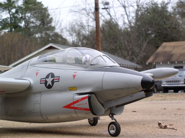

Just wanted to post a pic of my new jet I got from my good friend Mike Haddox. This plane is one I have not seen much of... Thanks Todd

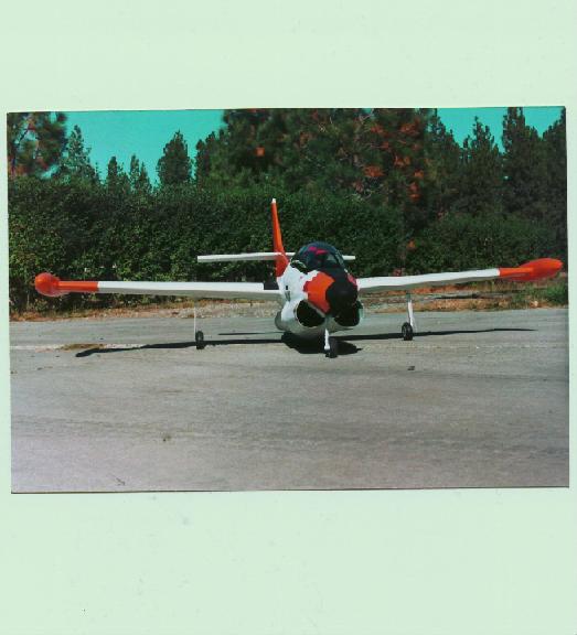

Nice airplane,what do you have in it for power ?I built one about about 8 years ago from Spirit Jets.I loved that airplane,it was a hit at the Naval feild,we were flying on.

Pat Grubbs from Spirit Jets,reworked the DB kit.I had full ducting in mine,no cheater hole.The kit was later picked up by Mark at DCU.I attached a photo of it.

There is no cheater hole but I have to trap door like slots about 3/4 by 5 inches long in the duckwork on the inside between the fuse and duckwork and my only concern is when its at full throttle it sucks the geardoors almost shut and sucks in the sides of the hatch area.. Any Ideas...Thanks Todd (Mine is the kit by DCU)

Sounds like you need more air intake.Your intakes look to be smaller and more scale than the one i had.You can make some blow-in doors,that would open to allow more air in.I beleive you need are 30 sq inches of intake area.Not to sure on that,its been awhile since i messed with ducted fans.

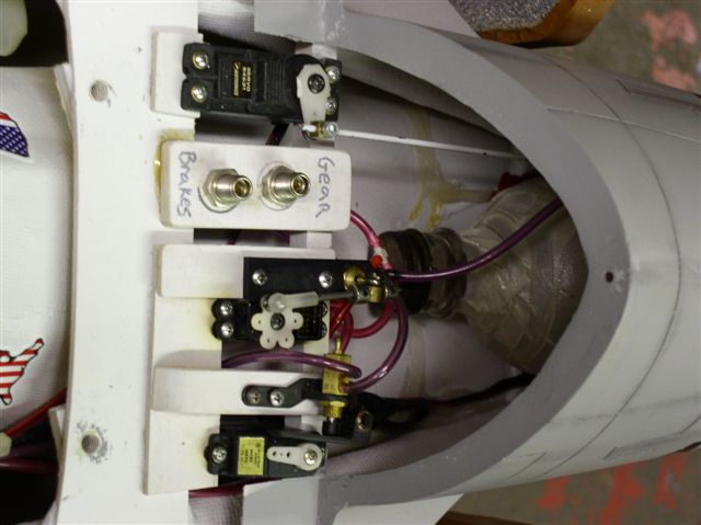

I've been looking for someone to post a interior photograph of their T-2J ever since I signed up with RCU and you turned out to be the one who finally did it! I've 'Saved" that photo for future reference and printed out a copy to keep with my remaining kit if I ever get in the mood to do something with it. I already have a .91 OS/Dynamax fan waiting to go in it. Just need some more pictures like this one to help me out.
It looks like DCU changed up the hatch over the center wing/fuse area to allow for better access to the rear fuse. And since I don't see no "bridge" between the two wing spars to hold the flap and sileron servos, I guess they have been relocated out to their respective places under the wing? Is this the case?

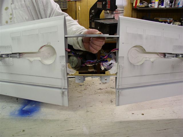

The flap servo was to be in the middle but now there are one in each wing and the elevator servo is in the tail with a small hatch and the rest you see is brake valve, retrack valve, filler valves and rudder. Will try to get more inside pics for you.. Thanks Todd

Todd, I would like to see the flap servos installation, and the elevator hatch you wrote about. Also, did you build a platform within the fuse to collect the different filler valves, switches, etc., into one location?

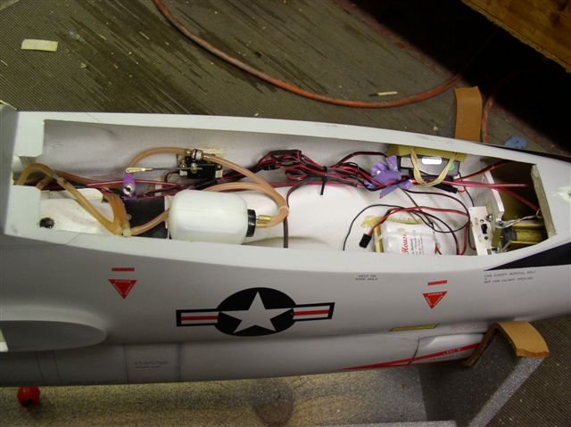

I had a large 28 oz tank mounted on top of the wing spars as far forward as it could go. Also I had a 4 oz. header tank mounted under the cockpit just forward of the aft cockpit bulkhead. With this configuration I balanced at 25% with tanks half full. Seem to work initially.

I have 2 12 oz saddel tanks and a 2 oz headder tank. Will balance the sames as you did . I have some more pics of the inside of the buckeye. Thanks Todd
